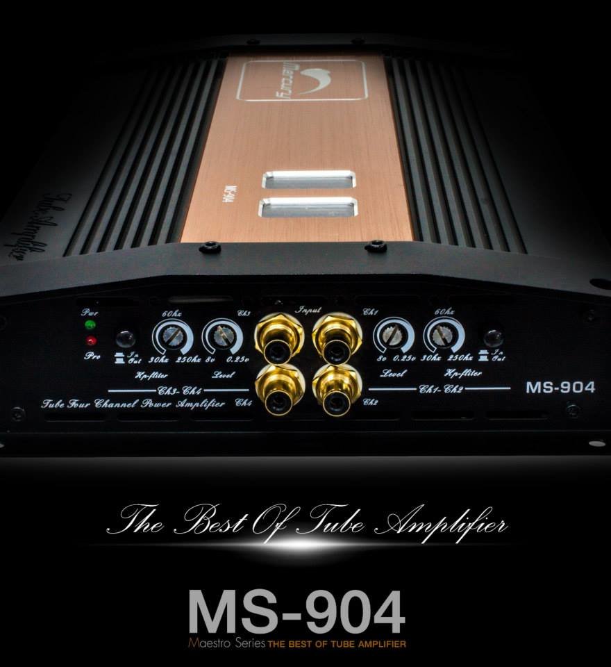

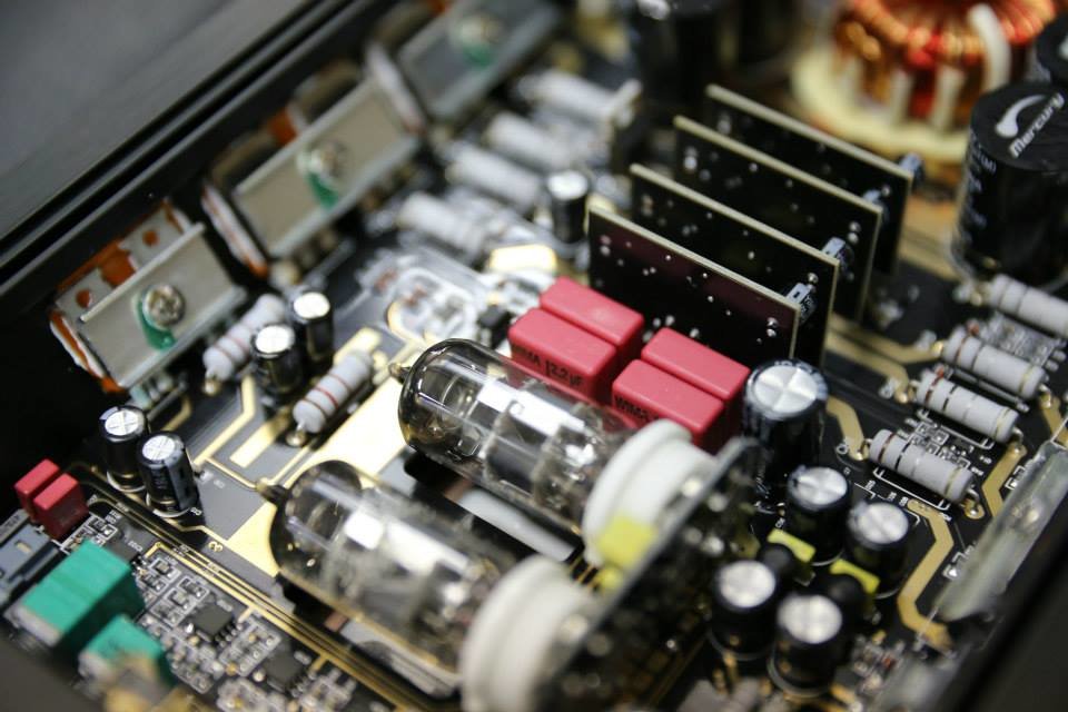

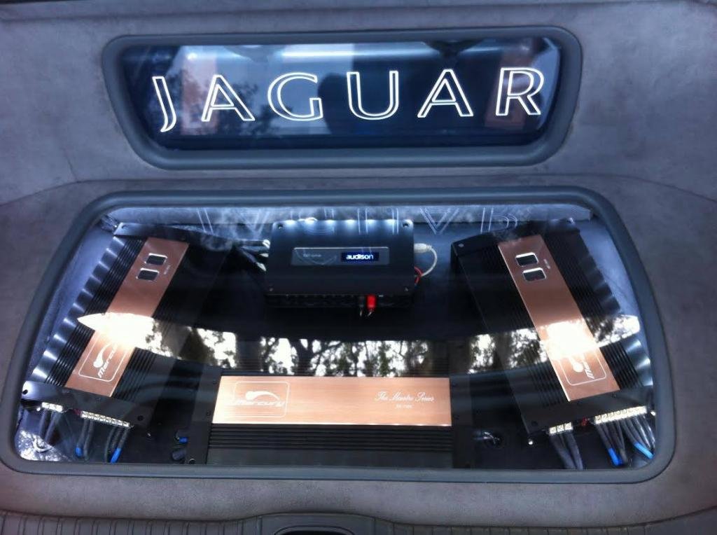

    I know you said you'd like to source something locally, is there any specific or particular reason for this ? The MS 90.4 is one of the best under 1000$ SQ mid amps on the market, period. I can upload prob a whole stack load of SQ comp car pictures with them in use.
    If i may :
    1512366_563825753747786_6017305914628626_e47c7fe7e8a6b1fa9a3fbf0808066b8da0b97d63.jpg
    10523345_509684992495196_249643629914444_5618cac981466d2f2017edb30f2298994ff2b184.jpg
    10506676_10152574449477272_3902985774476_85af6b23d4f3a0d750b59711acec68ee495aa927.jpg
    The last picture is a world class SQ comp car ran by eddie dejesus- top IASCA Champion here in the USA. I am doing my hardest to get a lot of this product warehoused in the usa but its tough on capital :(
