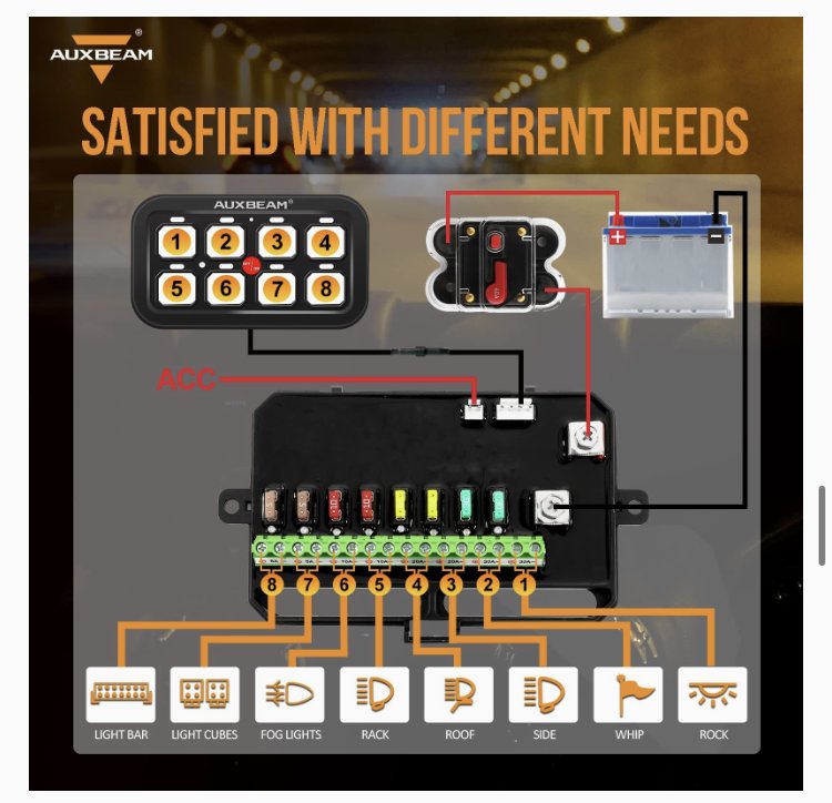

    Stupid question probably. Do either of you know if a switch panel like the linked one (or aux beam https://www.amazon.com/Auxbeam-Cont...bad-a7e9-e9fea3a3a7f7&pd_rd_i=B07KZLB74K&th=1- looking at that due to better reviews) are able to be wired so it is only powered when the ignition is on?

    Yup! Mine is keyed power using an add a fuse to some circuit under the steering wheel. Either sunroof or heater most likely. (i don't have a sunroof so it's an open fuse and keyed power, i think. Been a while since I was doing stuff down there).
    But the quick answer to your question is yes - they are can be put on keyed power.
    Edit - that's what ACC is here. 12V coming in to power it. You tap that into a keyed circuit.
    If this is your ONLY light or accessory, i wouldn't bother with a panel. I have 3 light circuits (maybe a 4th soon but that's just for shits and giggles not for a "need") and a radio on mine.

    You can, but you gotta run a wire to the fuse box under the dash (I still gotta do this)

    He MIGHT have success with the engine fuse panel on the second gen. Mine made the electronics possessed. But a bunch of the stuff i was reading was people tapping in second gens a okay. Still, gotta run a wire for the controller to the cab anyway, might as well run the 12V at the same time.

    It is possible and recommended to tap into ACC or IGN, that way you don't kill your battery.
