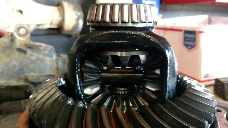

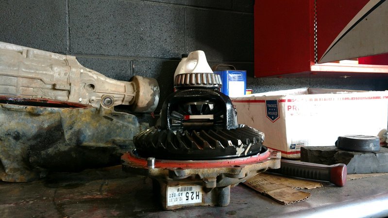

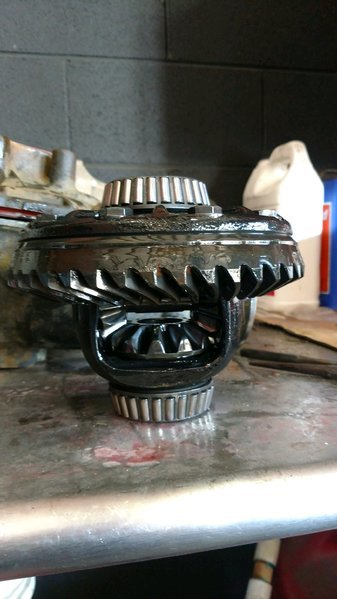

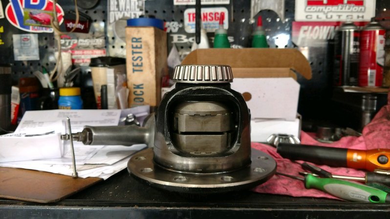

    yea they are . I spent a lot of time researching and making calls to find someone that has a mechanical Locker for the front.
    yes the front drive shaft will spin while you're in motion even if you're not in 4-wheel drive.
