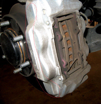

    So the steel wheels I run on the trails are 17x8 with a 4 inch backspace and barely rub my calipers. Is there a non spacer solution to prevent the rub? I honestly really like these cheap ass wheels and I would feel WAY more comfortable running them(and not having to drag an extra set of wheels with me)knowing I'm not running a spacer. I saw Wheelers Offroad had steel 1/4 inch spacers for this reason but anything that's only $5 just seems sketchy to me. Thoughts?

    Shave your calipers down a bit. Angle grinder and 36 grit flap disk, just very little at a time. I'm surprised 17's are touching them

    It's just the wheel design. Basic D window steel wheels and the face of the wheel is sort of concave and that's what touches the caliper.

    I’m with Chris shave the calipers down with a flap disk. How ever Please be very careful doing this as there is a fluid passage on the outer side of the caliper. It is possible to grind this area to thin and have it crack under heavy braking pressure. I personally have gotten a little carried away on a caliper before and had one crack on my trail rig. The rib circled in Red is a hollow fluid passage.49C2BC73-D8A0-488F-887A-3FD308694155.jpg

    Cragar soft 8s 17x8 4.75” back space do the same thing on my ‘16. They fit my FJ perfectly but not the Tacoma. The Tacoma caliper has a touch more meat on it.
