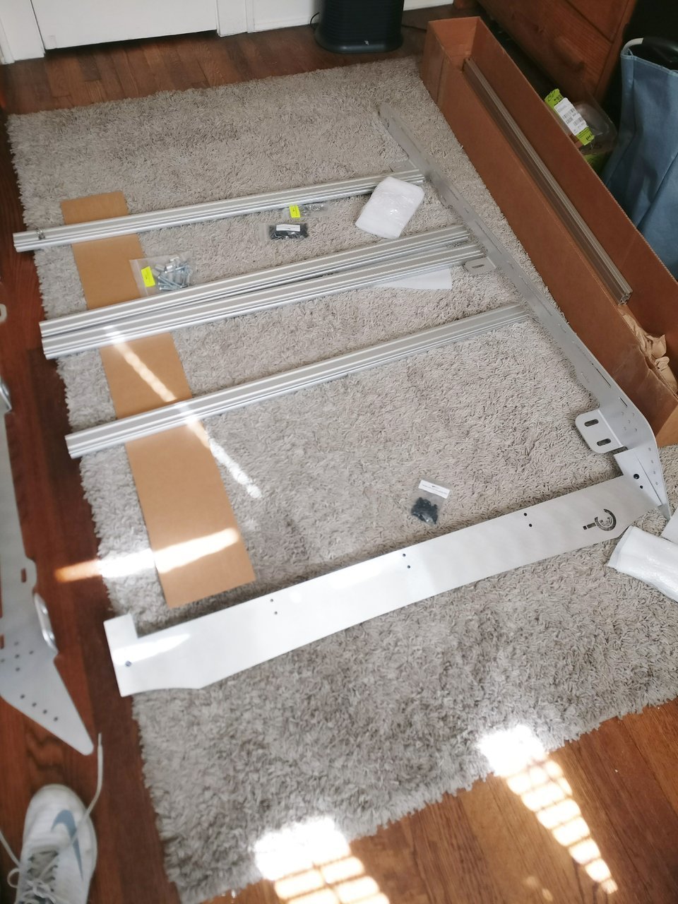

    Just got this in the mail... Gotta paint it and put it on before C&C!!! :eek::eek:

    Make sure you use a 3/4" punch for the weatherstripping.

    Definitely go this route... the drilling method is shit.
    Also, while your bars are off, it may be a good time to drill some holes on the tops, like phoosa did, so you can put carriage bolts in without having to remove the bar. I wish I would have...

    You mean just drill holes straight through a few of the crossbars for later accessory mounting points?

    Truth.
    I saw a hardware gizmo thing that allowed use of slots in the 80/20 without using drop in points.
    Just can't remember what the hell they were though.

    Dude, i know of what you are talking about but i cant remember either. Its like a drop in 80/20 anchor or something... no holes needed. Its going to be quite the effort to pull all the stuff off, take the bars off, drill the holes, replace bars, and replace the gear... im gonna try to find those drop in anchors or whatevs
    kind of like these drop in T Nuts:
    https://8020.net/catalog/category/view/s/shop/id/837/?cat=464

    Ohhhhh I see.. So you can add or remove the bolts without having to take the entire rack apart... Good call. Thanks for the tip!!

    Definitely. I'm very grateful I didn't tear my weatherstripping in two. It's like playing Russian Roulette with every hole when using a drill. Those spade bits can be murder. In case you like living on the edge, make sure you secure the weatherstripping on both sides of where the hole will be. Once the bit bites it'll try to take the rubber for a ride at full throttle.

    Yeah, I don't have the weather stripping on mine with the Prinsu. I used pipe dope on the threads and spacers to seal them from the weather.
