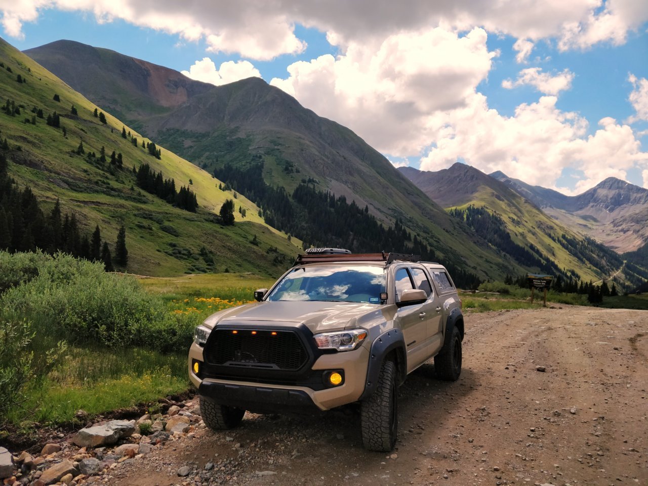

    Reppin' the TTC out here on the Alpine Loop! Drove through the FJ Summit in Ouray, too!
    Mineral Creek was pretty rough for a stock suspension but we made it, with a spotter and minimal scraping.

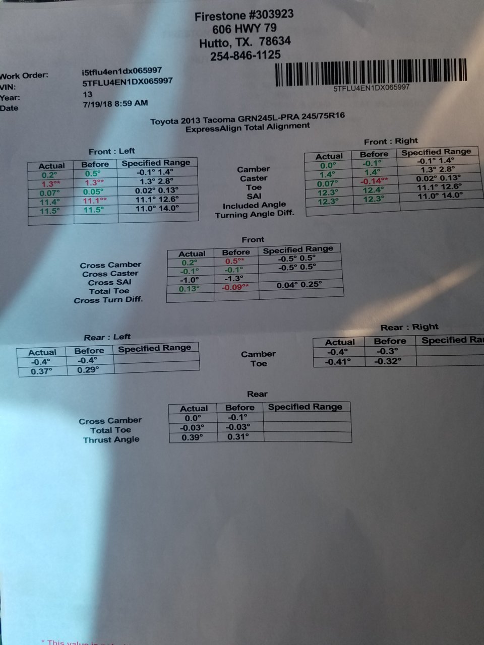

    Finally got around to have the alignment done on my truck after installing the ICONS.
    These are the numbers they gave me. Seems to drive a little better but not to happy with the red numbers on the final side. Truck also pulls to the right pretty strong.
    What do you think @Texoma

    Looks like they did a Toe n go, and made no other adjustments. Caster needs to be 3.5* +/- 0.5* , camber and toe to factory spec, and alignment cam bolts torqued to 130ft#'s

    I asked for 3* caster and this is what I got in return. I was even told that because I had replaced parts and was requesting specific settings that it would take a little longer so that a certain technician would work on it.
    At keast it made it seem like they had at least one guy that knew what he was doing.
    I know I haven't replaced the UCAs yet could that be the reason for these results?
