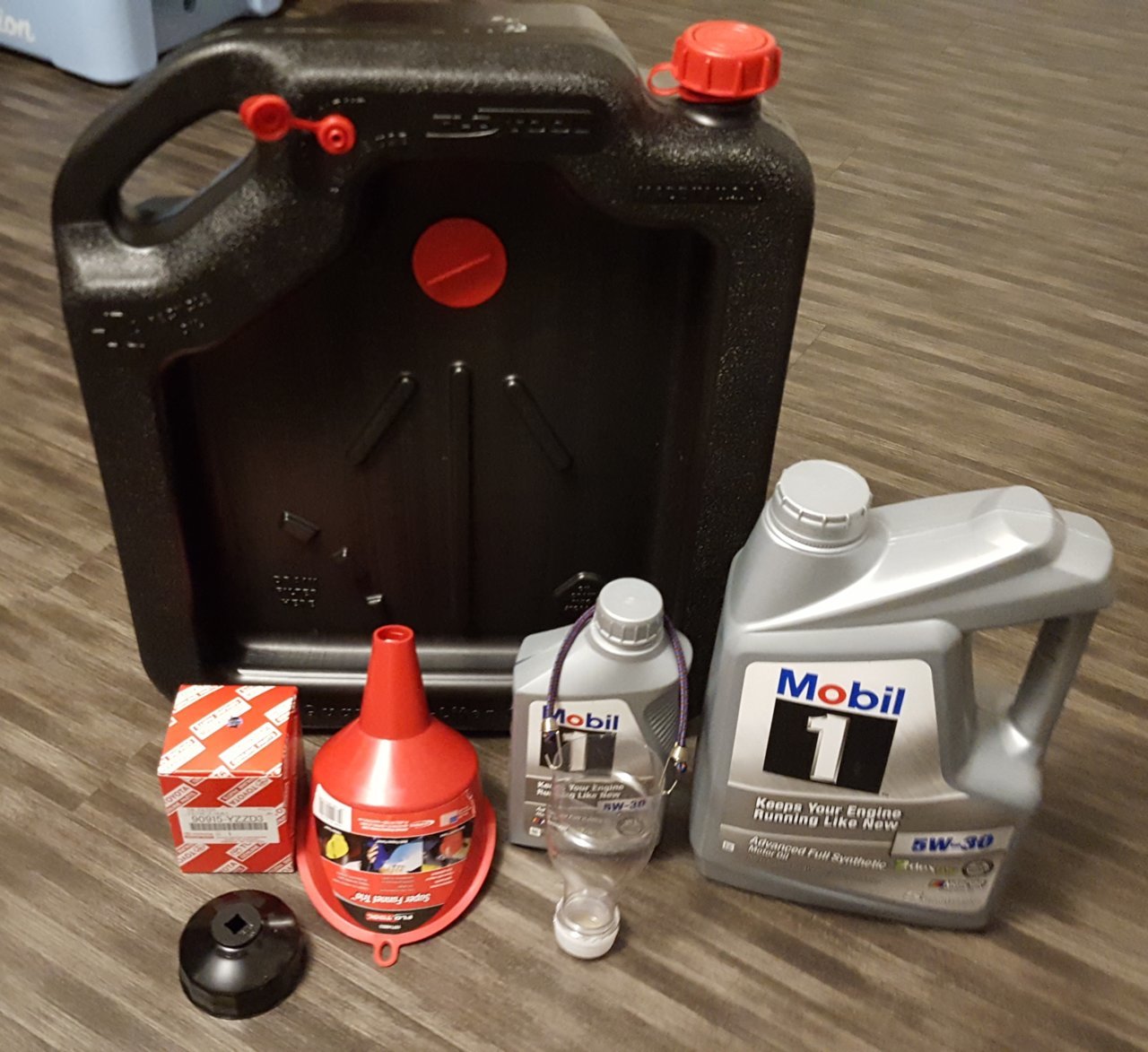

    Drain, pull filter, replace filter after oiling gasket. Fill with 5.5qts, run the truck for a minute, check level...am I doing this right?

    Yep that’s right..watch when you pull the filter you may get some run off. I still haven’t perfected that part.:thumbsup:

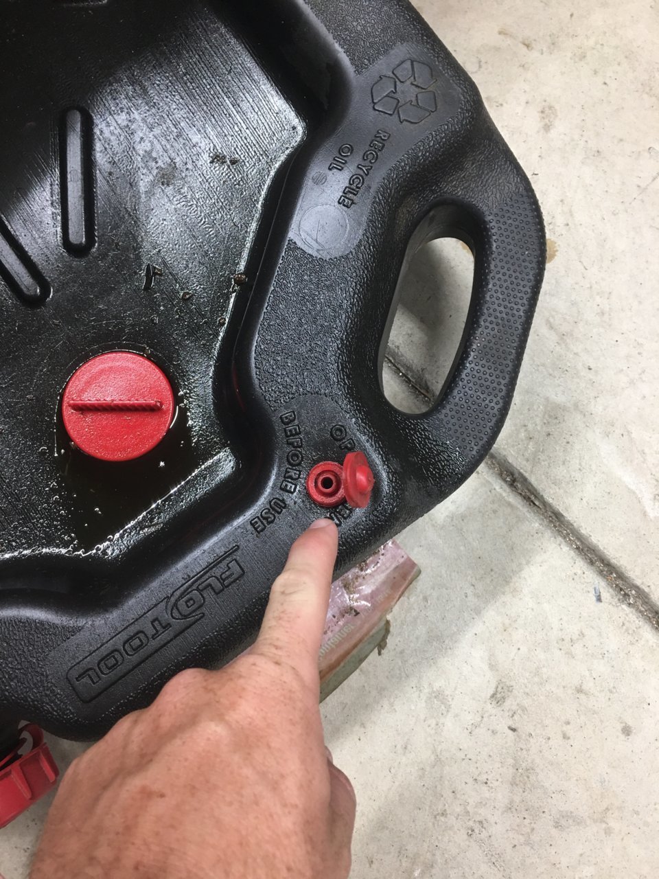

    Oem filters have been pre-lubed/greased from factory.
    Youll see when you pull the plastic.
    Also. Dont forget to take plug out of drain pan so oil will go in it, not over the sides.
    Vent cap open during filling process.

    Can you please tell me exactly what this means good sir?
    Edit: gotcha. Vent cap on the drain pain open

    Sorry. Meant this cap on oil pan.
    Doesnt hurt to open the engine oil fill cap either.
