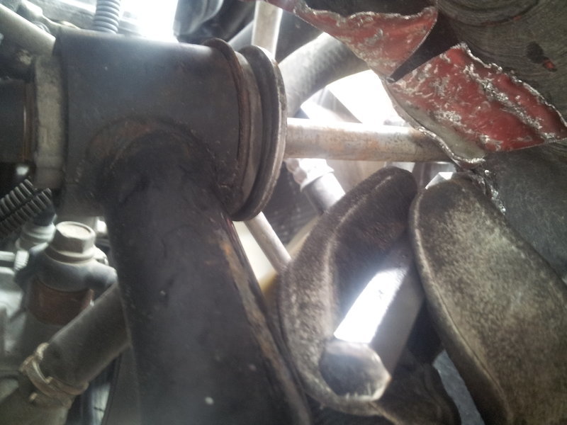

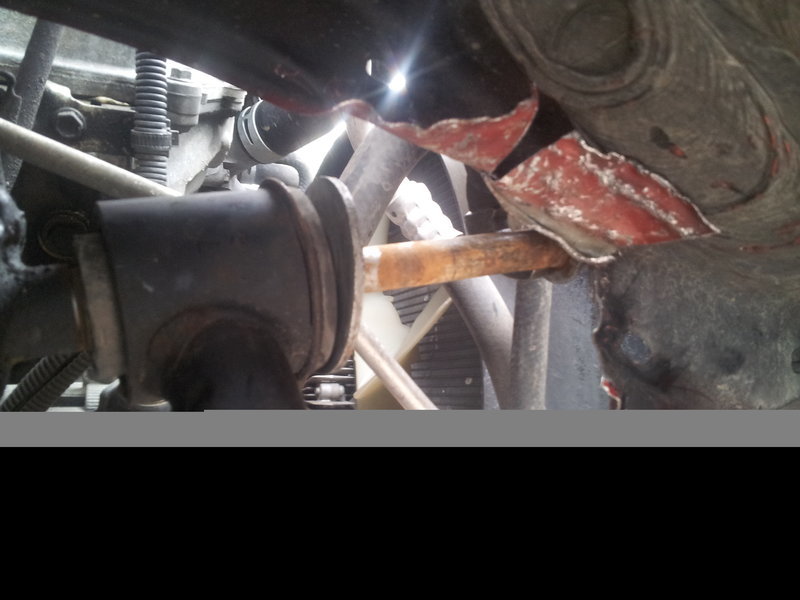

    tips for getting the UCA bolt out, go... tried bending the sheet metal, but there is a double stacked sheet metal layer that won't bend easily. Got everything apart - spindle disconnected from UCA, sway bar links, old coilover. That damn UCA bolt though... (my excuse for not going to C&C today)

    A lot of people just cut them off and use a new one.. but seriously lots of bending

    20170212_124035.jpg Having some luck with a socket extenstion and a hammer, not out yet though. Further slong than I was yesterday though

    victory! Effin bs that is.
    Putting a chisel under the head of the bolt in combinationion with the socket extension and a punch helped.

    Still fighting this... suggestions to get the bolt back in reversed? Only goes so far then stops. Tried wiggling the uca while pushing/twisting. Cant really get a hammer behind it to hit it.

    Put the bolt back in the correct way. PM me where your number and I can walk you through it. And if it is too difficult, I can make a service call

    @BlackBeerd idk about second gens but with my first gen, I took out the battery and air box and it gave me just enough wiggle room. Try goin at it from the top?

    The side with the power steering reservoir has extra sheet as a base. It's a little more work, but is not too bad.
