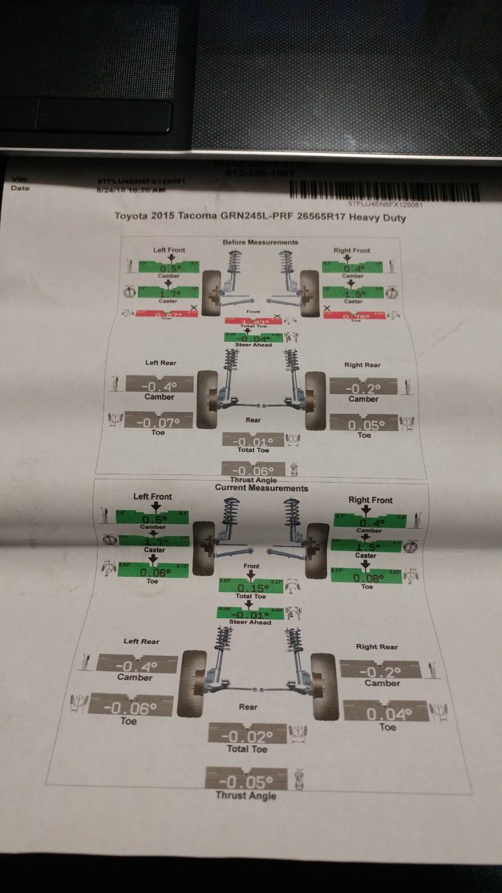

    I have the lifetime alignment @ Brake Check over on 1431 right across from 1890 Ranch.

    I'd say low caster is why you rub. Once you swap to aftermarket UCA's you'll be able to pump those numbers up in to a more ideal position and eliminate your rub. If you need help with that and/or a CMC (Cab Mount Chop) let me know.
