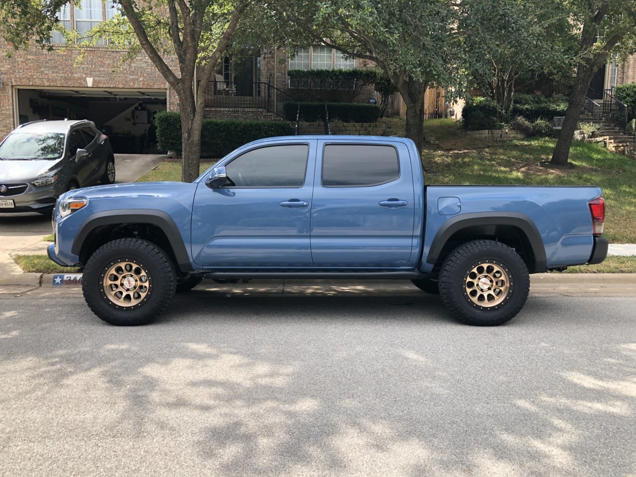

    Hey guys! Just installed Fox 2.0s this past weekend which brought the front up 1". Any recommendations on where to get an alignment done in the Austin area?

    Thanks for the recommendations. Gonna try Patriot Motorsports on 620. I drive past them everyday on the way to work and they always have lifted trucks up front. Anybody have any experience with them?
    Here are pics of my Fox 2.0 install. First time working on suspension. Front install was pretty straight forward. Rear lower shock bushings were a PITA to slide in.

    @CedarPark would you add this image to post #2 so @240ric can be identified in the wild, please.
