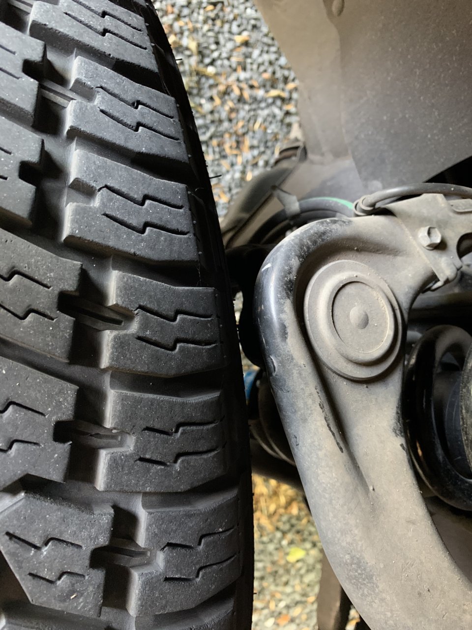

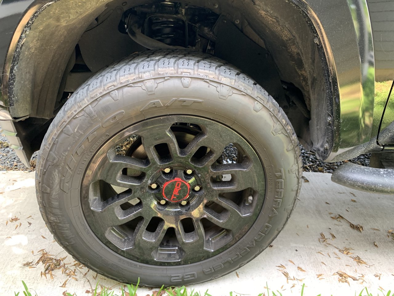

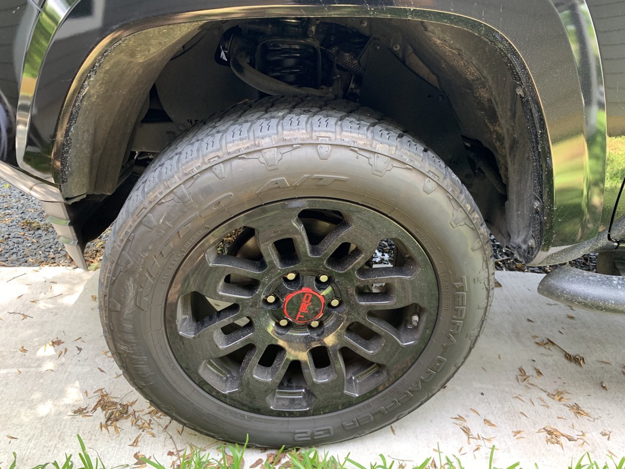

    2018 Black TRD Sport
    Drivers Side

    You're definitely rubbing the control arms

    I figured... whats the typical fix? Aftermarket control arms or spacers?

    Yep control arms and possibly that plastic thingy on the bumper.

    Wheel spacers are cheaper I’d get a hub centric brand like bora or spider trax.

    Don't forget different wheels, with the correct offset.

    Spacers will work. They could cause you to rub on the cab mount, though.
    Yep, maybe the air dam, but I can't tell. It is close enough, though.

    Different wheels nooooo love these wheels.

    My wheel is turned a bit, my wife is a monster.

    They actually came with the truck, I think the wheels are from Toyota but the tires seem to be aftermarket cause I havent seen them on any other trucks i came across.
