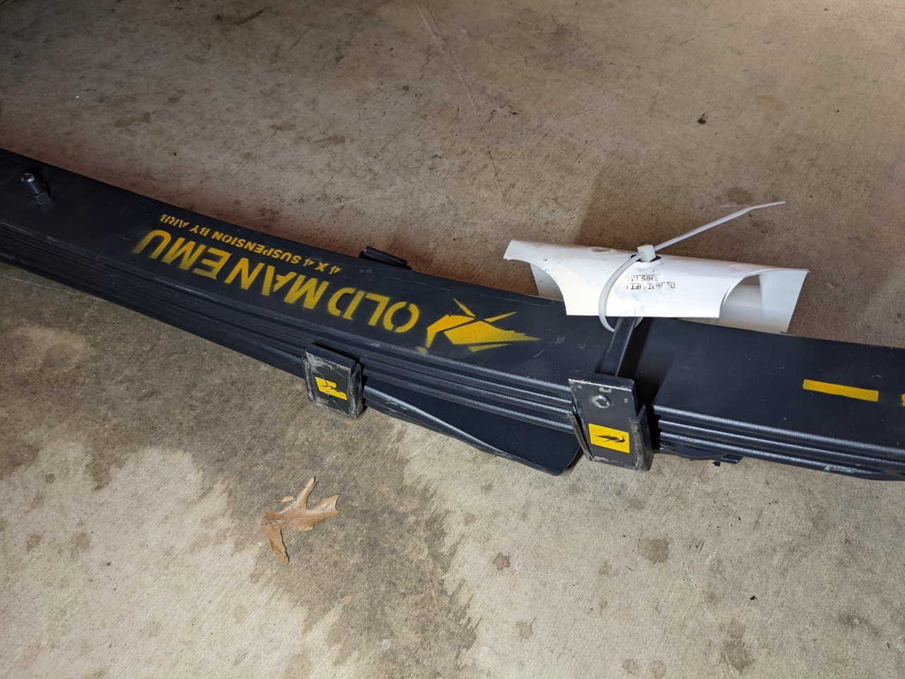

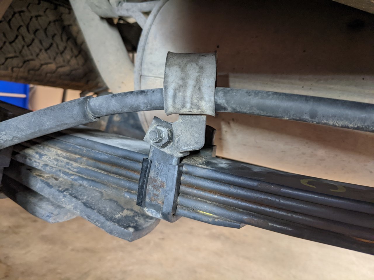

    OME springs come with +, 0, and -. So the smaller should go on passenger side. The ebrake cable uses the factory screw to go in to the leaf pack, which doesn't look like you have. You should see a threaded hole in one of the leaf retainers.

    OK thanks. So to be clear, - side should go on the passenger side with the - side towards the front? I think there is a hole in the retainer, which is right under the "Old" logo. I have not removed the old ones yet, one of the leaf packs was lost in Dallas :(

    Yes, - should go on passenger. Military wrap goes to the front shackle.
