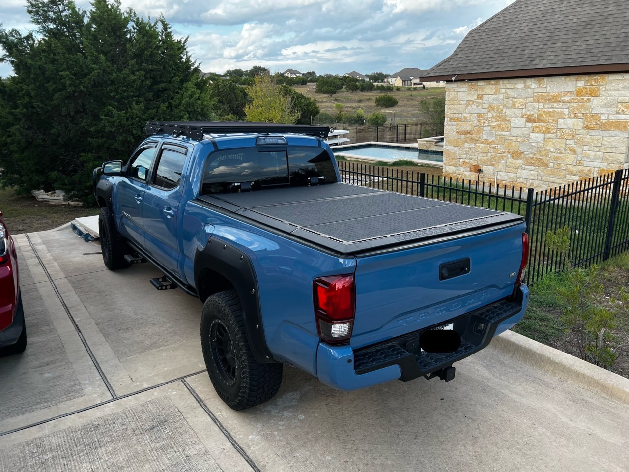

    The Revolver X2 works great on my Tundra.
