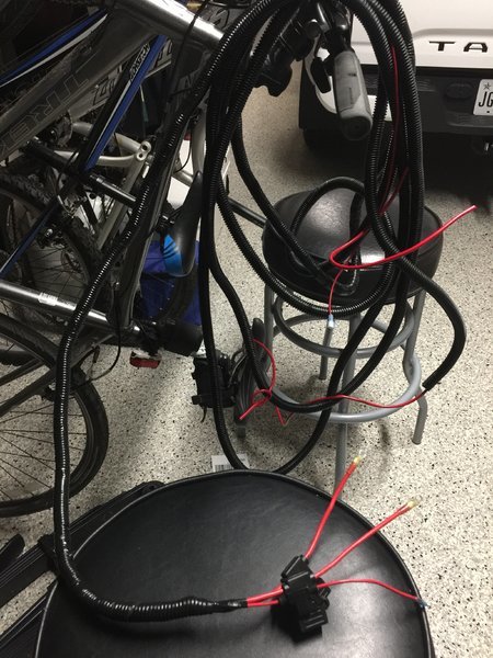

    Here is the done end

    holy shit that is excessive...you don't need to do that, homie. Crimp well. Use heatshrink connectors. Then use the heatshrink I posted to cover up those connectors since crimping can go through the connector heatshrink. Then cover in plastic loom anywhere on outside of cab. Zip tie every foot so the wires dont come out. If you have decent wire and place them in smart out of the way places, you'll never have problems.

    Also, what are you wiring that you need 10 gauge wire :bananadead:

    Right on! I did solder my connections on those and covered with heat shrink. I used heatshrink ring connectors as well. There are some spots where I will need some tape to route the wires from the harness to the accessory... gonna t junction some loom.

    dayum that's a lot of wrapping :D Having Navy "half-lap double-wrap" flashbacks :rofl:

    Who knows man... it's there if I ever need it :). I was planning for 30amps. So should be good at 20 feet and 25 feet.
    What I'm wiring now won't need it. The thinner wire is for the water pump I put in the large cubby. One other wire for the 12v/USB ports in the other cubby. One extra wire for future.

    Approximately 25 feet of loom there.... maybe a little more. It's enough to get from engine bay to drivers rear of bed and then across to passenger rear of bed.
