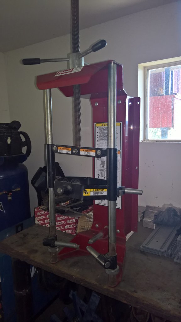

    Sure. I also have a big fancy spring compressor as well. If you got real froggy, you could remove both n bring em over in the Bimmer.

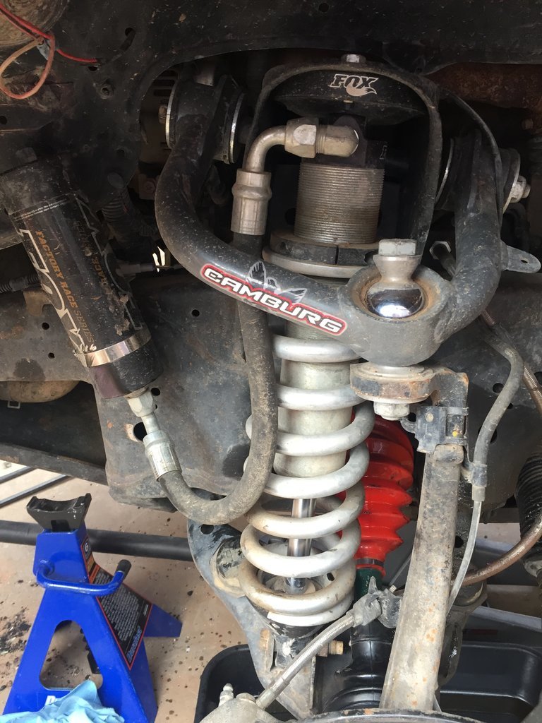

    Still need to finish the passenger side. Got to late yesterday.
    So don't even know how high I need to go....

    Count threads and even up. Then, supposedly, every full turn is a 1/4" of lift.

    They should be preadjusted. I just need to compensate for the weight up front.
    I read more and more that you damage the shocks if you do it without compressing the spring. Any input on that?

    There is a possibility of damage. They're more prone to damage if you do it with wheels on the ground vs on jack stands. If there's only a few threads showing at the top, then adjusting while on jack stands has the lowest risk of damage, where as if you have alot of threads showing, the spring pressure can be great enough to push the collar off the threads and do damage. That's where a big fancy wall mounted spring compressor that costs $800 can save your life.

    It spun fairly easy yesterday when I monkeyed around with it. Have the truck of the ground though.
    Worst case I would have access to a wall mounted compressor. But I don't think I need to crank them that far.

    I'll mount it to the wall before you come if you need it.

    @CedarPark
    Here is how my Collar looks, stole the pic in another thread:

    Just found a pic, it has 3-4 holes in my collar, made it a pita.

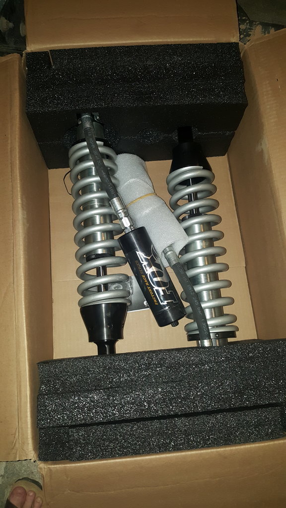

    Back in the box they go....
