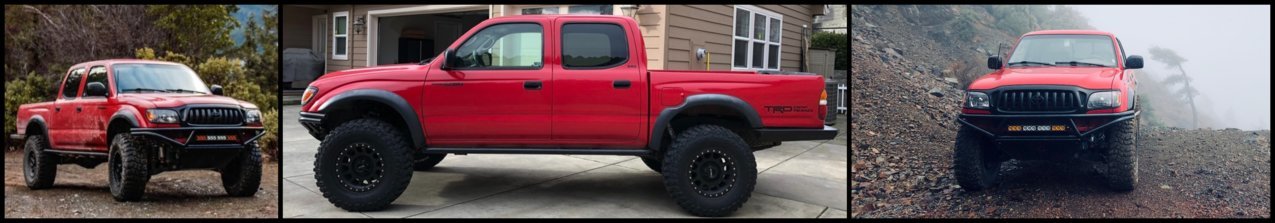

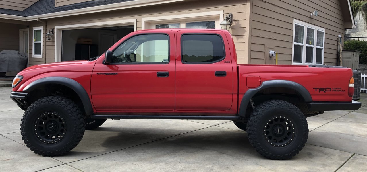

    Hello TacomaWorld, I'm Austin from Southern Oregon, and this is my 2004 double cab TRD Tacoma build.
    As the truck sits now:
    The Build
    Suspension
    Solo Motorsports stock length LCA's
    Bell Fab UCA's
    ADS extended travel coilovers with resis and comp adjusters
    ADS 10'' 2.125'' smooth body shocks with resis and comp adjusters
    All Pro Standard leaf springs
    Total Chaos shock relocation
    Total Chaos spindle gussets
    Total Chaos coil bucket gussets
    Total Chaos cam tab gussets
    U-bolt flip with Wheelers Superbumps
    Camburg limit straps
    Performance
    TRD 2nd gen supercharger
    Haltech Elite 750 Standalone ECU
    URD 2.2 pulley
    URD dynamic tensioner
    IPT transmission valve body
    170 thermostat
    Walbro 190 fuel pump
    Electrical
    Odyssey 35-PC1400 deep cycle battery
    200 AH Chins heated house battery
    Blue Sea fuse box
    xLED X6 22'' light bar
    Double din Kenwood sterio
    Wheels / Tires
    Cooper STT Pros 285/75/16r
    Method NV 16''
    1.25'' wheel spacers
    Gearing
    4:56 gears from ECGS
    Armor
    Custom steel tube bumper
    CBI Bushmaster 1.0 rear bumper
    Custom steel skid plate, belly skid, and rock sliders
    Low Range Offroad E-locker motor guard
    Trail Gear frame box
    Misc
    Blacked out grill
    Dakine tailgate pad
    Future Plans
    Custom roof rack
    Lights!
    Sound deadening
    Corbeau seats

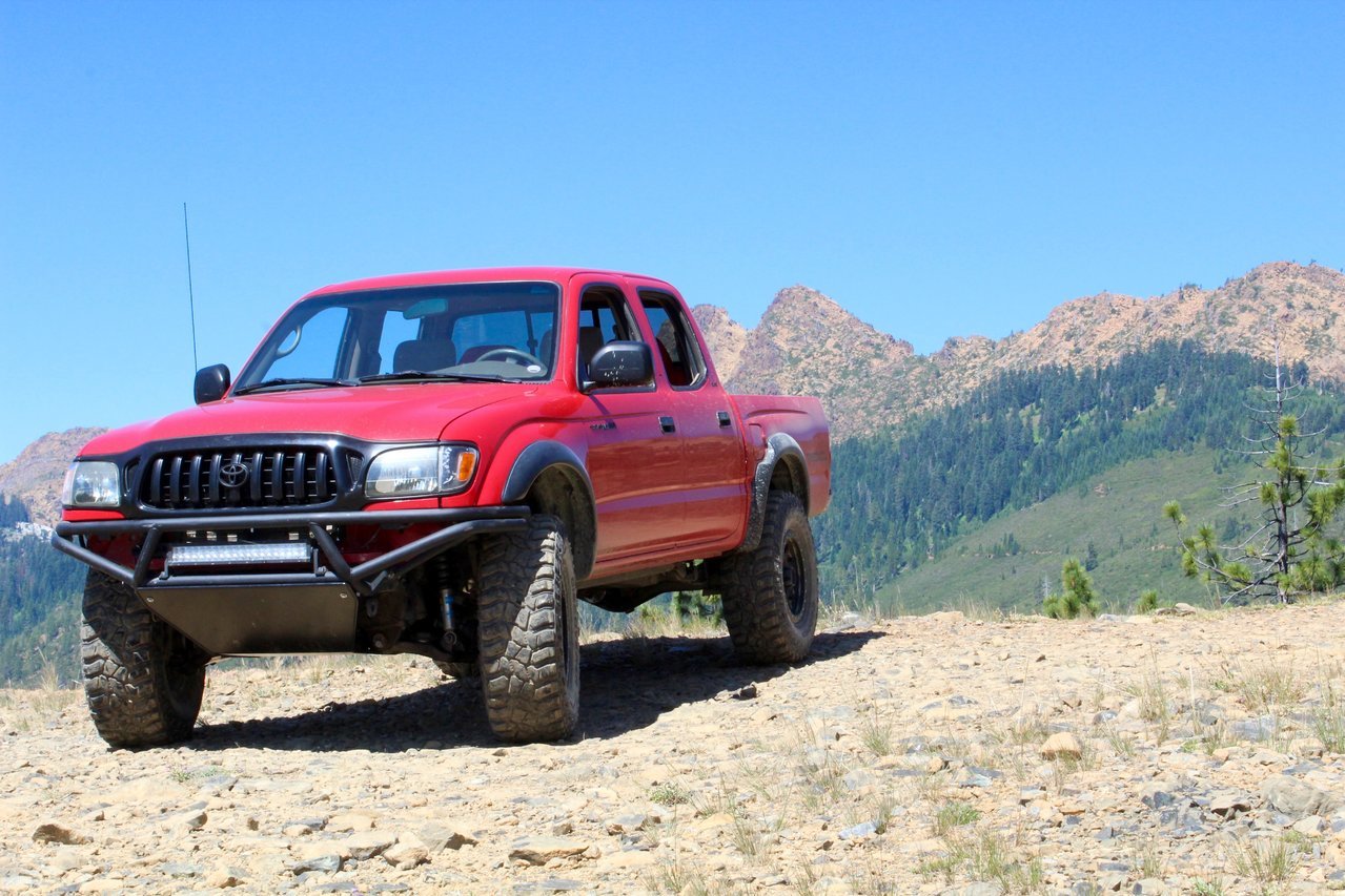

    The first thing to do was get rid of the grandpa look. I had some Method NV wheels put on the truck, wrapped with Cooper stt pro tires. Along with the wheels and tires, I put Bilstein 5100's up front, with OME 883 coils. In addition, an add a leaf was put in the stock leaf pack to lift the rear a few inches.

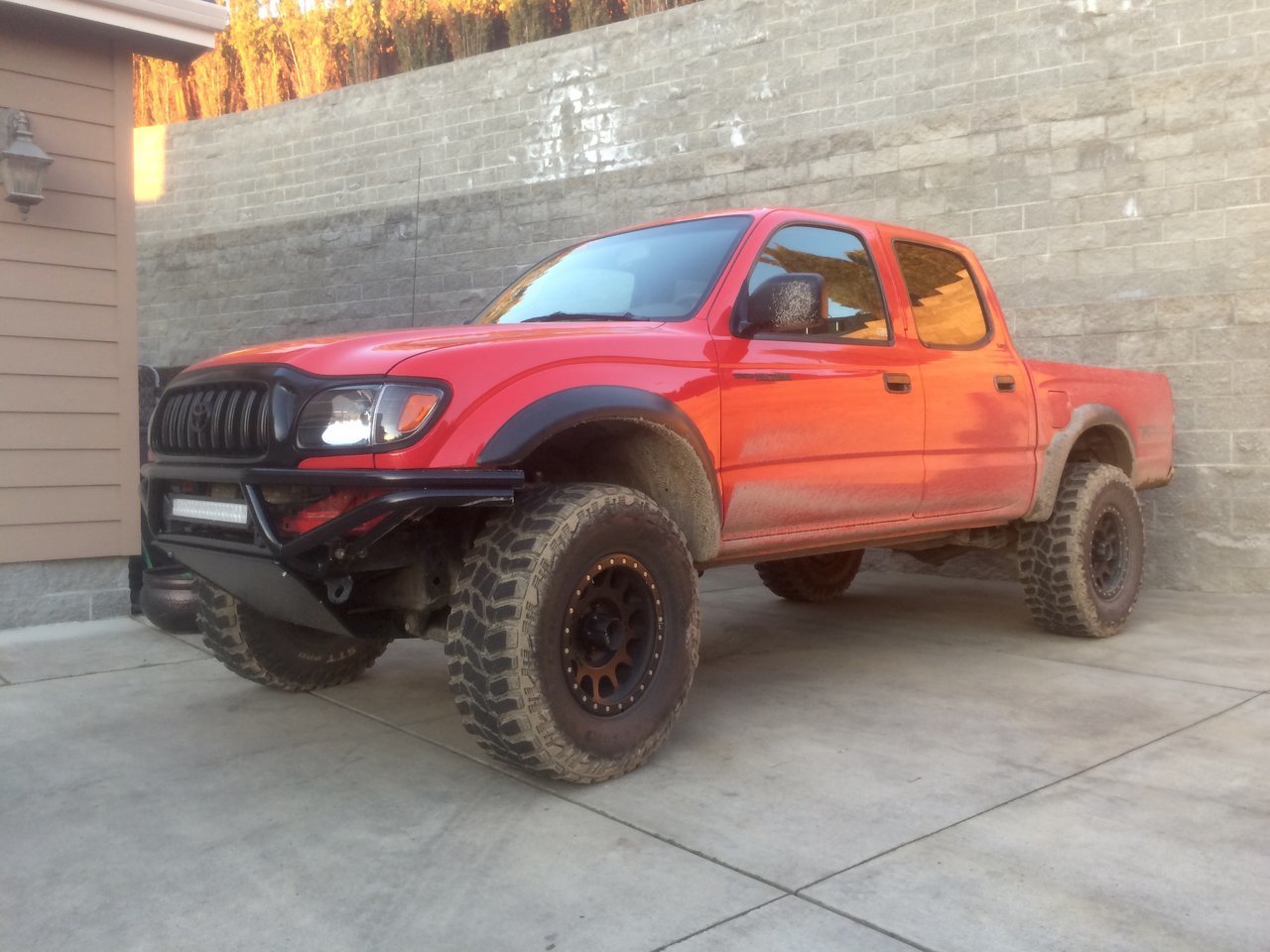

    I found a used steel tube bumper for sale and jumped on it. I love how the bumper wraps tightly around the front of the truck. The bumper also included a chinese light bar.

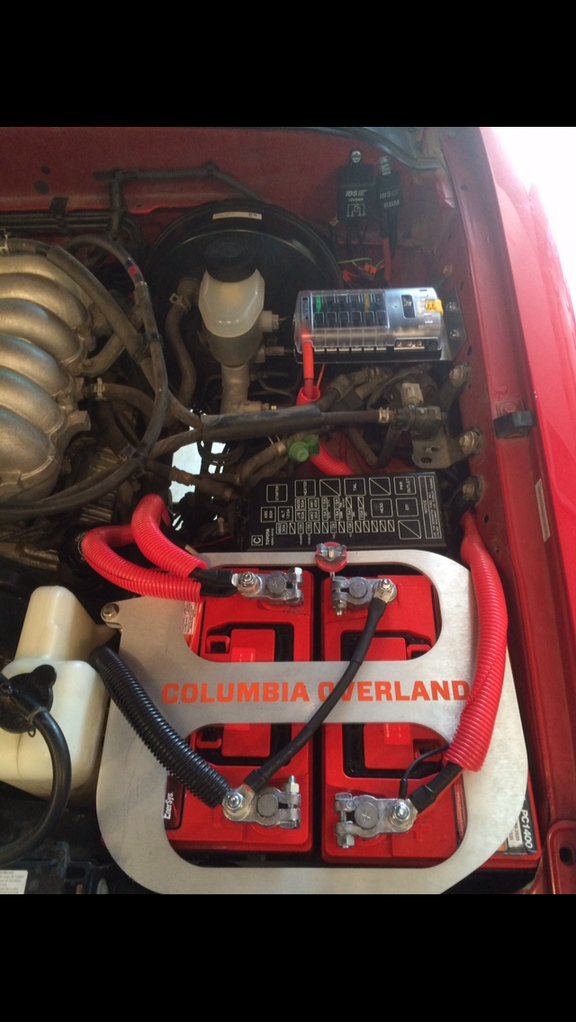

    At about this point in the build I started getting really interested in the overland scene. I decided to start taking the build in that direction so I could spend the coming summer taking various trips living out of the tacoma. The first order of business was to install a dual battery system. I ended up going with the Columbia Overland dual battery tray, Odyssey deep cycle batteries, and IBS system. In addition, I used a blue sea fuse box to wire all my electric accessories to one location.

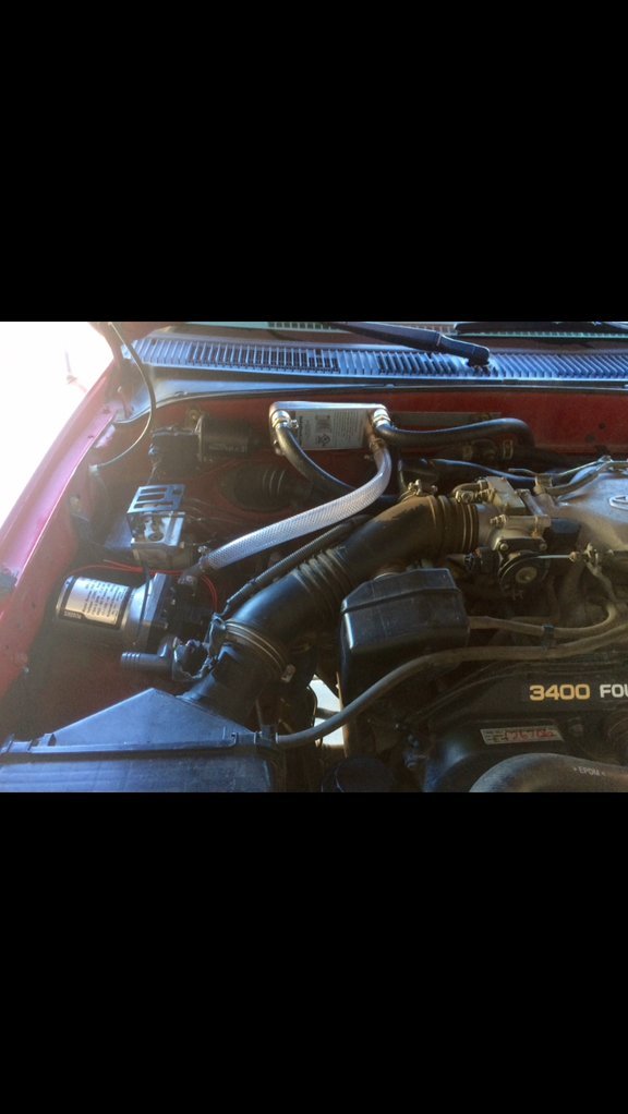

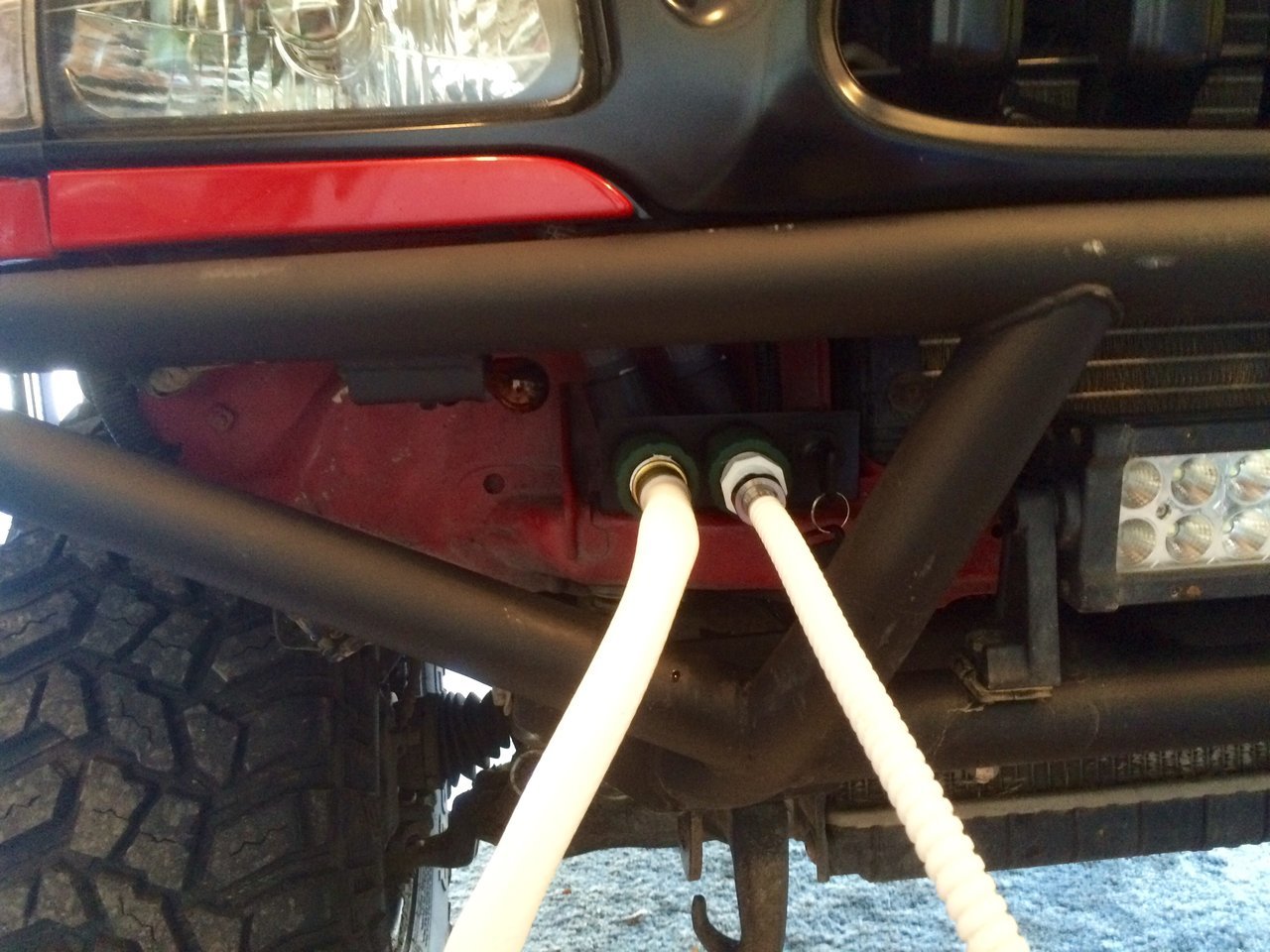

    After installing the dual battery system, I installed an onboard shower system that uses the engine coolant to heat up water that is pumped through it. I figured this would be nice to have when spending multiple days living out of the truck.

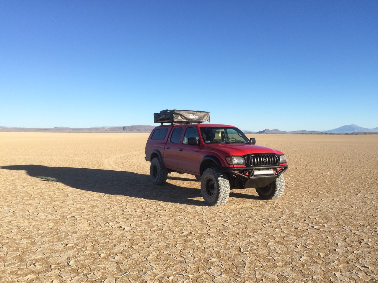

    Finally, no overland setup is complete without a RTT. I found a used CVT tent near me for a decent price and jumped on it. I then purchased a canopy for the CVT to mount to. I liked the security of the canopy better than a bed rack setup.

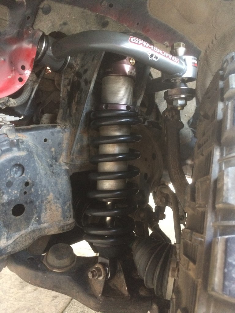

    I picked up some used donahoe extended travel coilovers off of another forum, and Camburg UCA's from Wheelers.

    What did you do for an on-board shower?

    I mounted a Shurflo pump and heat exchanger under the hood.

    Nice build. Everything looks really clean. I like how your onboard water is all contained under the hood.

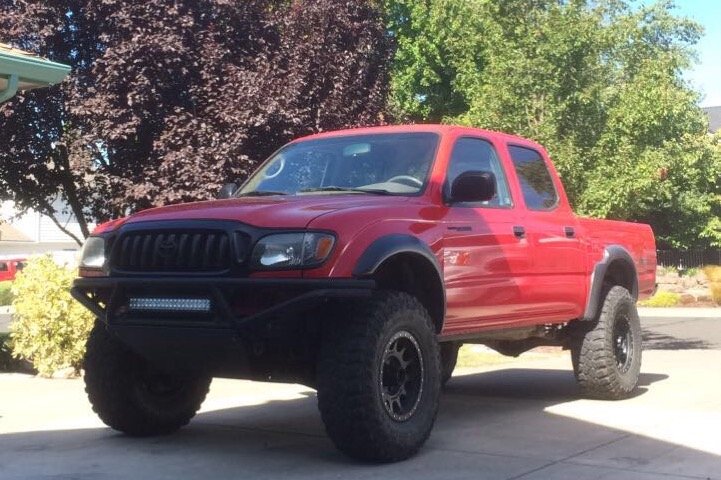

    What brand front bumper is that? Sweet truck man
    austinmtb[OP] likes this.

    Sorry if you already said this. What is the model on your water pump? Where did you find the fittings you put at the front as well?

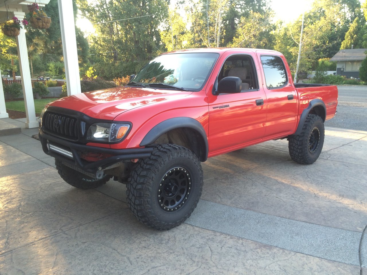

    You have quite a bit of preload on them it looks like, that and the 700lb springs with little front end weight is what's making them so harsh I bet. I'm having the same issue with my Kings, a little too much preload and 600lb springs with no added weight. My 5100s rode softer on 500lb springs, but when I add my skids and eventually a plate bumper it should help it out.
    austinmtb[QUOTED][OP] likes this.

    I'm not sure what brand it is or who fabricated the bumper. I bought the bumper used off of someone who didn't know either unfortunately. I'm pretty sure it's just a one off bumper because I've never seen another like it. I actually get asked about my bumper all the time by toyota enthusiasts.

    The water pump and heat exchanger I used are in the links below. I think if I were to do it again I would use a larger heat exchanger. With the current heat exchanger I can only get luke warm water unless I re circulate it. The fittings on the front are just garden hose quick connects connected to a 90 degree pvc joint, and then barbs with water hose clamped on. I then ran the two water lines up behind my headlight and into my engine bay. I actually had to cut a little bit of the metal behind to headlight to make room for the water lines to pass through, but you can't really tell unless you took the headlight off. All the brackets in the shower system are just brackets I made with some sheet metal.
    https://www.amazon.com/gp/product/B0039WXZH6/ref=oh_aui_detailpage_o06_s00?ie=UTF8&psc=1
    https://www.amazon.com/gp/product/B002XM5G70/ref=oh_aui_detailpage_o07_s00?ie=UTF8&psc=1

    The image of the coil overs that I have above is when I had some old worn out 650's on. The 700's have significantly less preload. The truck actually has a lot more weight up front then it looks like. The bumper alone is heavy as hell. I also have two 50 lb deep cycle batteries and a steel skid plate.
    I just ordered some longer 14'' 650 lb coils. I'm hoping the added height will help support the weight of the truck without so much preload.

    Ah yeah that is quite a bit of front end weight. I'm thinking I might do the same with my Kings (longer coils) if I don't end up with a softer ride after adding weight.
    Too bad about the bumper being a one off, I really like how it hugs the lines of the front end. I've been looking at plate bumpers because normally tube bumpers look funny to me, but that one looks awesome.

    The design is pretty simple. You should just take a picture of the bumper to a fabricator and see if he can copy it.

    The key is to find the right height/weight coils for the lift you want, and to support any front end weight you have. Adjusting the preload is fine to an extent but you don't want to crank it up too much or the ride starts to suffer considerably.
