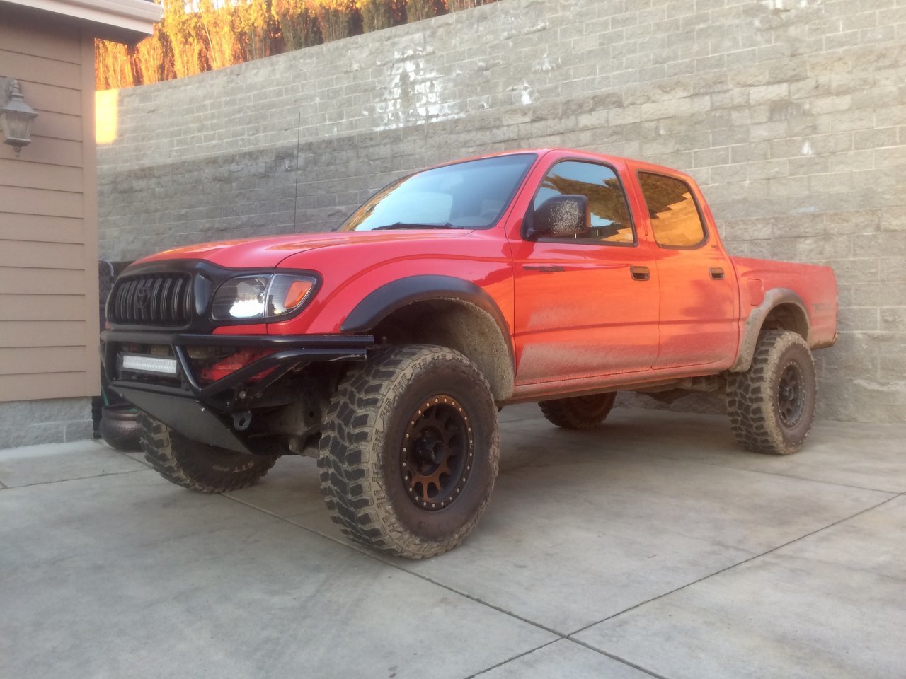

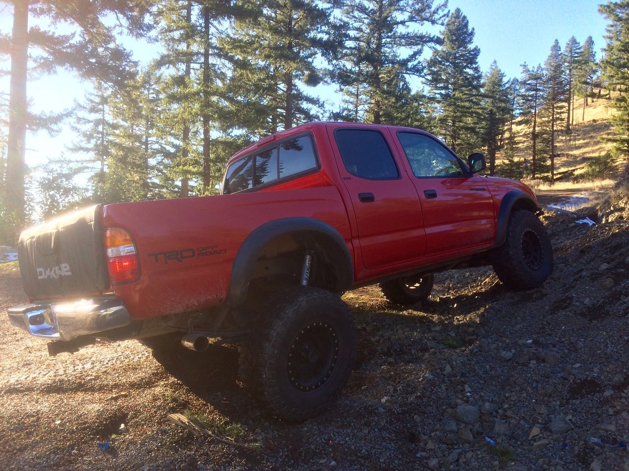

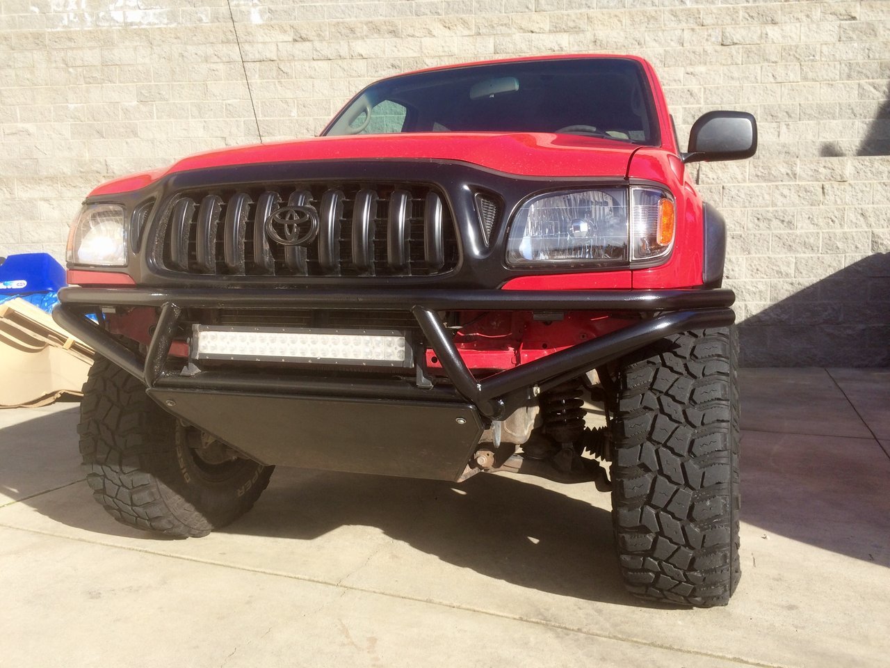

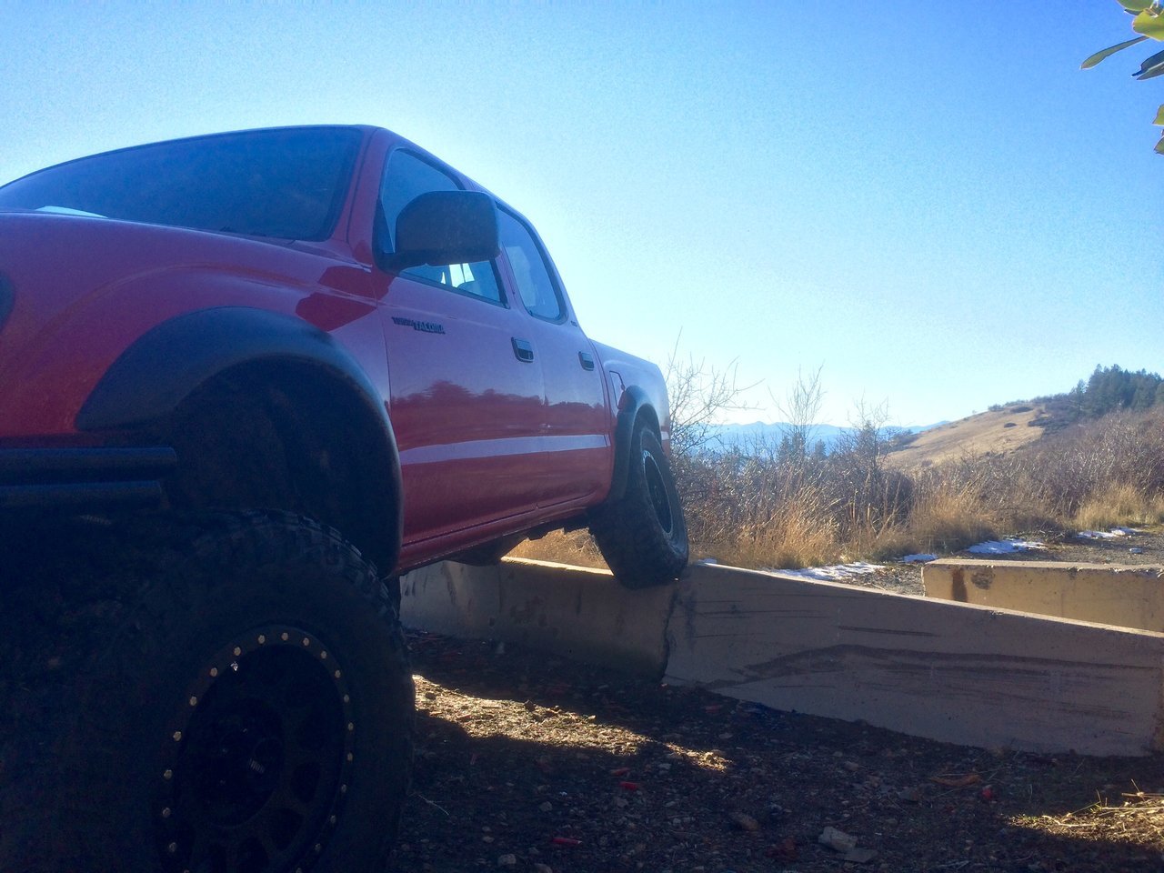

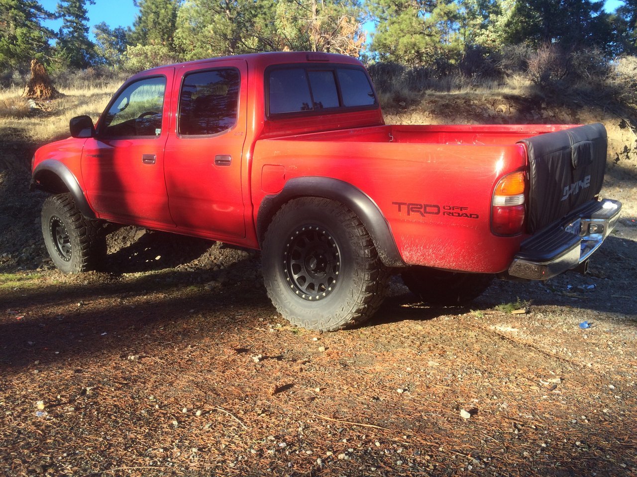

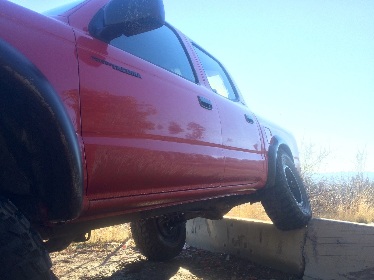

    Got a chance to take the truck out for a test drive. Out boarding the shocks has greatly decreases the amount of body roll the truck had. The shocks have a good road feel, maybe a little on the stiff side, but that makes it handle well. Off road they're also a little on the stiff side at speeds below 45 mph, but they may just need to break in. If they don't soften up as they break in, I will likely have them revalved for slower speeds. The tires do rub slightly at full stuff, but that can be easily fixed by a u bolt flip, and extending the bump stops about a half inch or so. Overall I'm happy with how it all came out, just need to fix the little issues.
