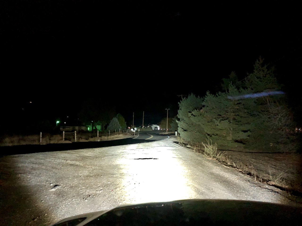

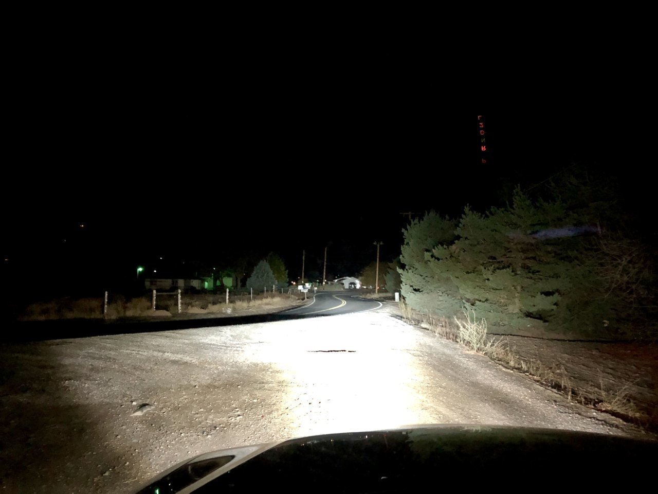

    Snapped this picture of the light output of the new bar + headlights.

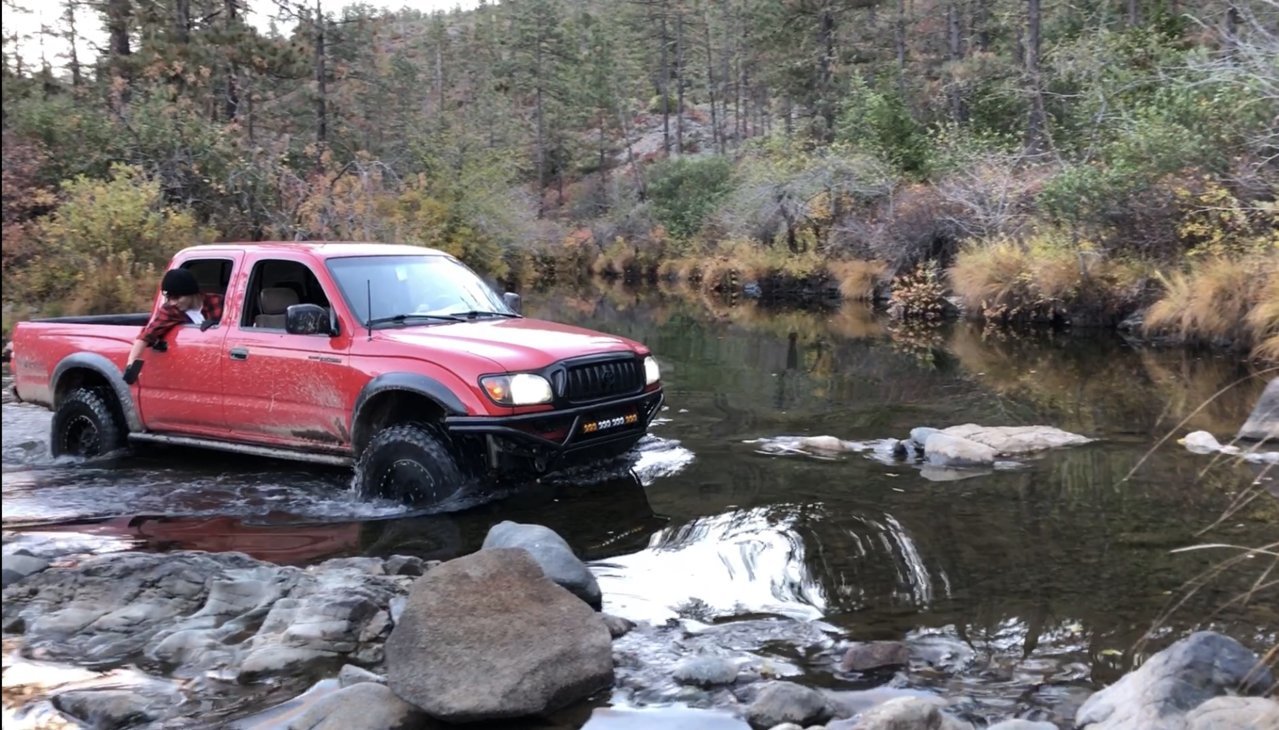

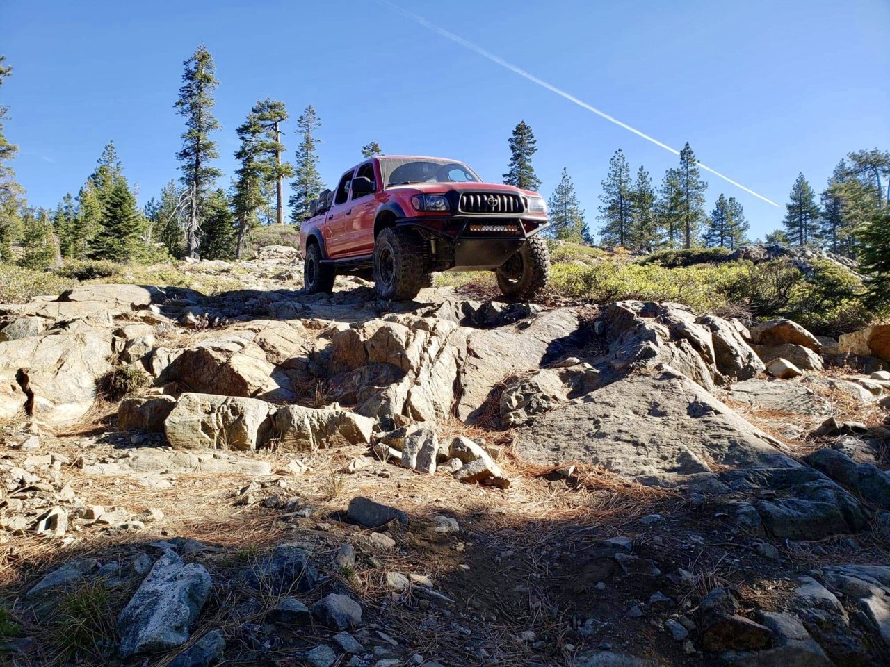

    Took a trip down to Norcal to camp and play in some rocks.

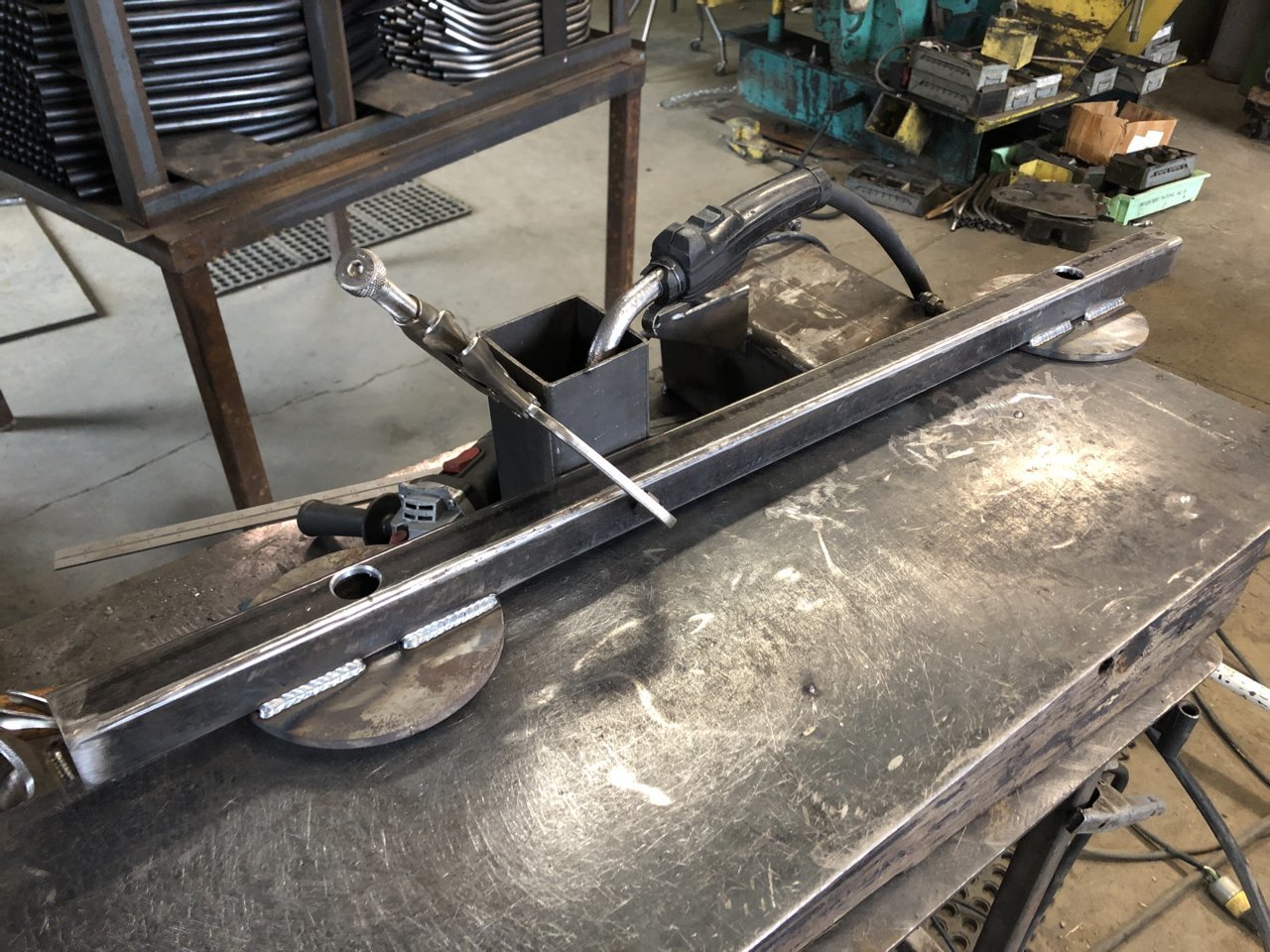

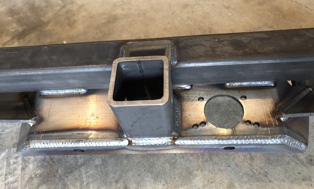

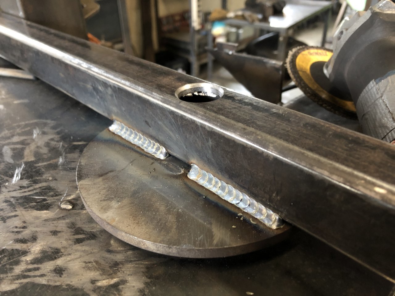

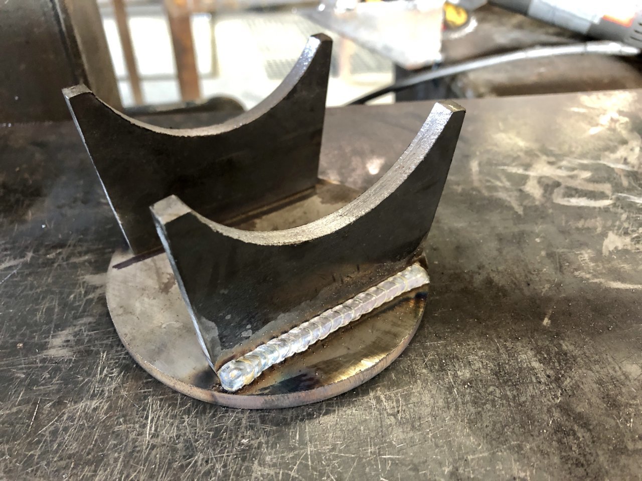

    A little something from @CBI Offroad Fab showed up today. Look at those welds :drool:

    What bulb did you use?
    I did a similar swap but it's not very bright.
    Sweet build btw !!

    Awesome thanks. That's the size bulb I use too.

    No you need the harness in the link to replace the stock one.

    @chrslefty is correct, you will need both the bulb and socket I have linked. You will also need an LED flasher relay to eliminate hyperblink

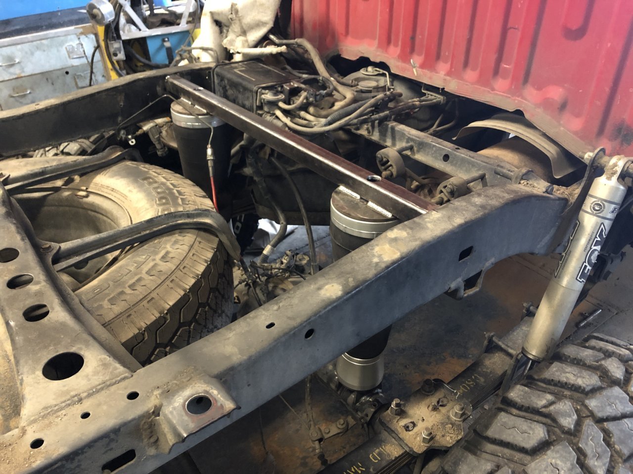

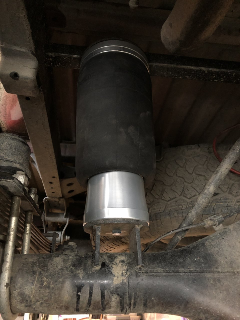

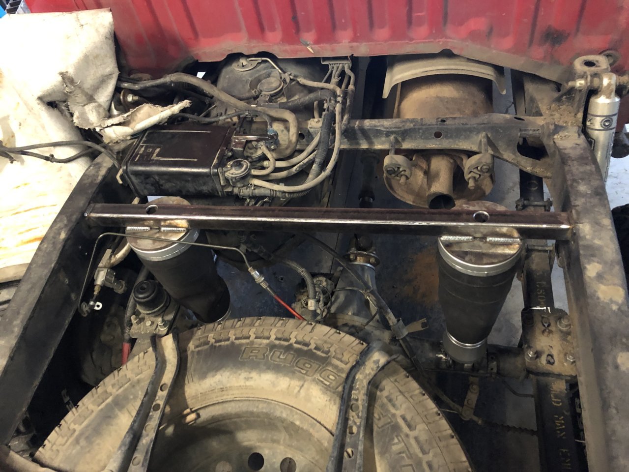

    Finally got around to building my airbag setup today.

    Looks like it'll No let you droop as much?
    Gonna have to change your exhaust too or you'll likely melt a hole in the passenger bag.

    The picture is a little misleading. I had a jack on the trailer hitch lifting me to full droop. The bags cycle just fine.
    I think I'm just going to weld a turn down pitched a little sideways to the end of the exhaust. Hopefully that''ll be enough to not melt the bags.

    ah gotcha. Nice!

    Put some air in the bags and cycled the suspension. Very stoked how well it's working out so far.
