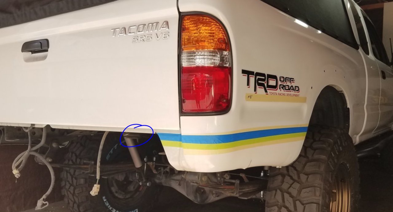

    I used these same references to figure out a starting point. We were about 3/4" off on our first attempt. Here are the photos from my bumper install:
    https://www.tacomaworld.com/threads/synergy10s-02-extra-cab-build.287417/page-11#post-17249979
    I can try to get a pic of the bedside with a measuring tape up against it to give you an idea. You'll have to wait till tomorrow though.
    **EDIT**
    It's sort of coming back to me now. I want to say the last cut was close to being above the blue tape in the pic (first cut was below it). Really close to being even with the part that is circled in blue:

    So how close to that bottom flap on the tailgate you have circled was your cut? slightly above, even, or slightly below?
    xtremewlr[QUOTED] likes this.

    1,368
    San Diego
    From what I can recall the cut was practically even with it. I'll get some pics tomorrow at work. Got home pretty late and had some errands to run.

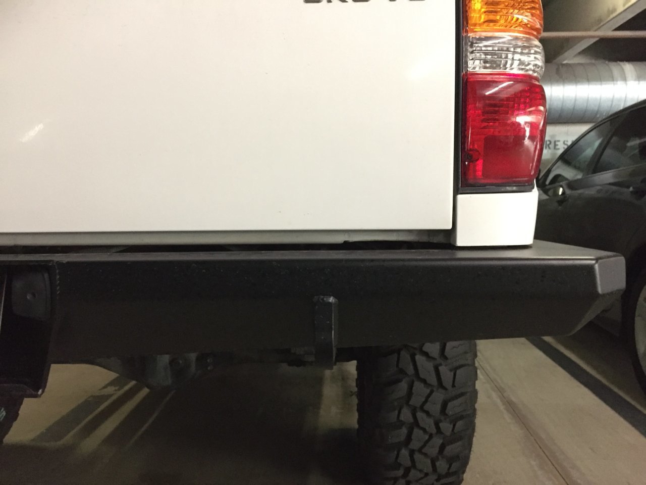

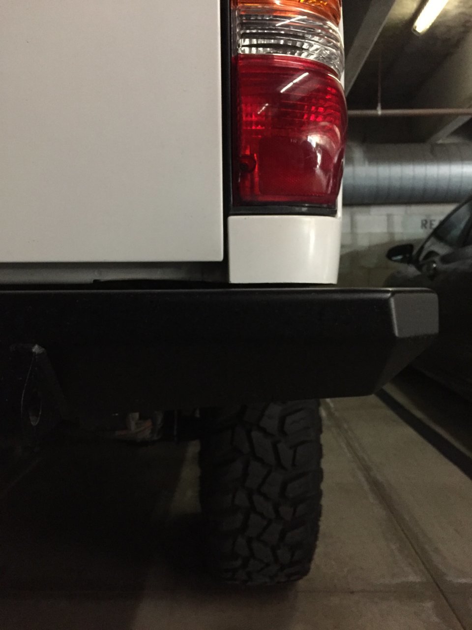

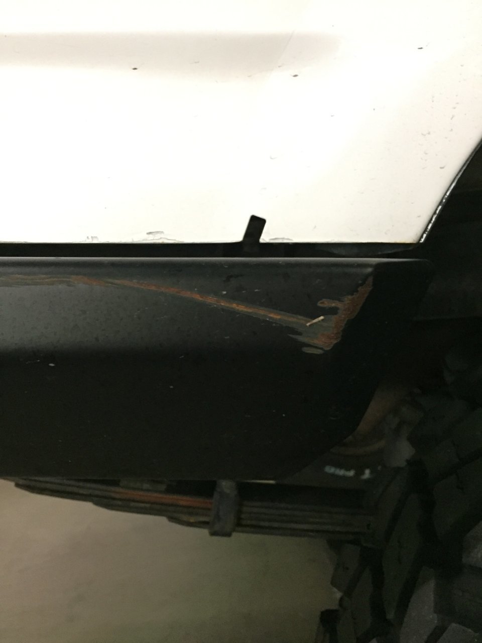

    Took a closer look and it’s just a tad lower than that bottom flap (pics show the cut and bottom of flap to be almost even):
    C7D52A9B-D9E4-4EF8-B86B-BD5EEAA51C60.jpg 6FCEC4FF-03E6-44FE-A241-8924EF805589.jpg F444D93C-BA43-43D0-8124-571EE5C0127C.jpg
