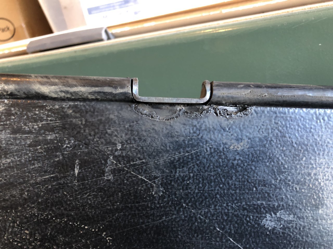

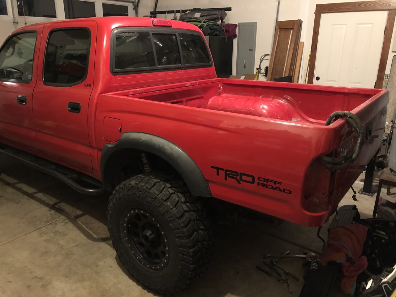

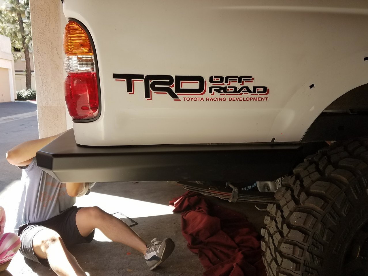

    I got the bumper on but am not happy with the result. I cut the bedside on the same plane as the top of the bed, and it created a huge gap. Apparently CBI didn't build the bumper straight on the sides. :facepalm: Luckily I think I can slot out the mounting holes on the bumper enough to bring the wrap around portion up and fill the gap. They also didn't give me enough of that edge trim stuff to completely cover the cut edge. Anyone know what size edge trim CBI sends? Going to see if I can get some more.

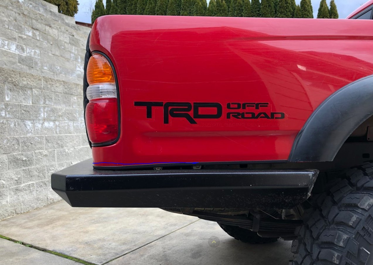

    Its hard to tell but your cut looks pretty darn close to mine...the bumper is way off though (see pic below). Have you contacted them to see if they would give you some sort of credit towards that? Maybe send you another trim molding too while they're at it (I actually didn't get one with my bumper).
    Glad you have a plan to slot the mounting holes. I'm going to have to readjust my bumper after slamming it on a ledge this past Saturday...fun stuff!

    You’re right, the cut on mine goes right to the bottom of that fender flare mounting hole just like on your cut. I may give them a call tomorrow to inform them about this, see if they will send me some of that trim, and try to talk them into giving me some free ditch light brackets for the hassle.

    Yeah man, these bumpers cost a pretty penny, I'd definitely ask for some sort of compensation. Have them send you several extra trim pieces this way I can get one too...lol.

    Your cut looks to me like it rises in comparison to the body line. The bumper actually lines up really well with the line in the body.

    There's almost a dip where the body line starts (near the tail light) that needs to be taken into consideration. Looking at it more, I agree with @cazinpa
    You could possibly take more off of the corners (not the most accurate but you get the idea):
    I'd probably go this route since the top of the bumper does look parallel to the top of your bedside. It doesn't hurt to have more gap either. In fact, I'm thinking of taking mine up a little bit.

    Looks like the bumper just needs angled a bit. You don't want it too tight or it'll rub during offroading.
    Also just go to parts store and look for "wheel trim" or fender trim. It's like 8 bucks.

    I can’t remember the exact measurement, but I think I cut 18.5” down from the top of the bed all the way across the bedside. I even went back after realizing I had an issue and the cuts were dead on at 18.5” all the way across the bedside. I think it’s that indent on the bedside that’s aimed slightly downhill that makes the cut look like it’s not right. Also, my cut ends right at the bottom of the fender flare clip just like yours.

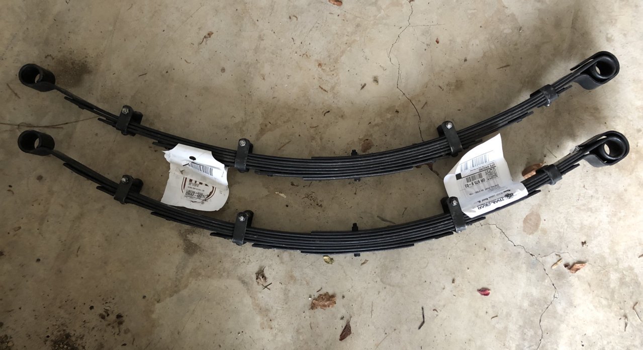

    My All Pro Standards arrived.

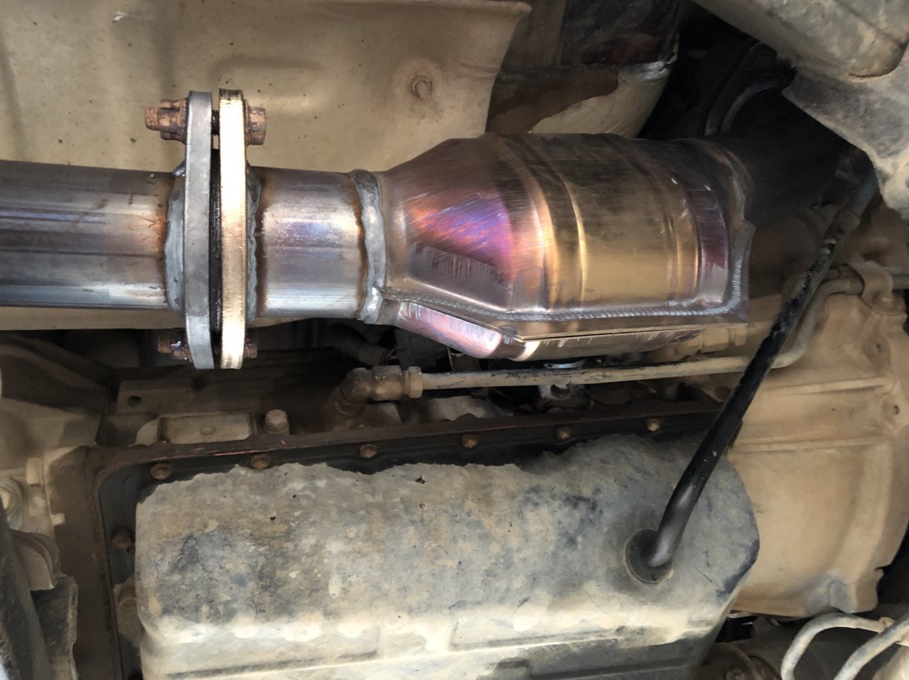

    I looked under the truck to checkout the new Magnaflow cats that were installed and found this gap between two flanges. I tried tightening it down but it won't budge. Does anybody have an idea whats going on here?

    Unbolt the exhuast it looks like the gasket is pinched

    Is it leaking?

    I think so but it's hard to tell. The truck does seem louder than before.

    You know, I was out in the garage this morning and I thought about this. I measured that body line on my bed, and sure enough it it about 1/2" higher in the rear!
    I'd say you measured right. Something does look a little off on your corner though.

    Probably has to do with the new cat that was put in

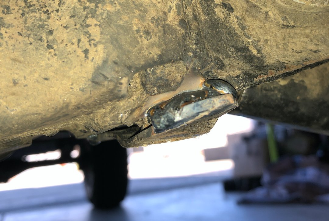

    I noticed that one of the stock skid plate mounts had ripped off my truck after a night of wheeling. Went to fix it and found the other skid plate mount holding on by a thread. Got them welded back on hopefully better than the stock welds.

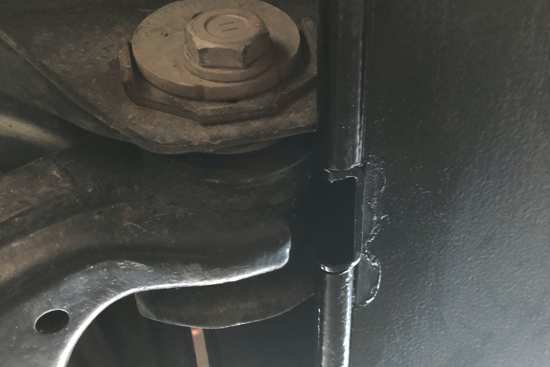

    Also, after going mid travel, my LCA's were getting into my skid plate at full droop. I notched the skid plate out so they have plenty of clearance now. RIP powdercoat.
