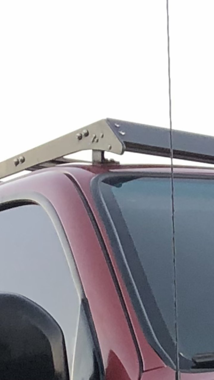

    Thanks. Ended up selling it for a few various reasons actually. I ended up having to drive more on the highway due to longer trips than I was expecting (6.5 hour trips one way) and even though the tacoma did descent, loaded down I needed something with a bit more power. Also due to me having to daily drive it I felt couldn't really wheel it on the more serious trails I wanted to go on like the rubicon. It was a super hard decision, probably would have kept it if I were to swap a manual in it, ha.
    But anyways yea I did end up mounting it. Have a picture of it on the truck in my build thread, first pic on the top. I built it because at the time, Prinsu didnt offer a rack option for the first gen 4door, so I built my own lo profile design with the same cross bars Prinsu uses actually. Turned out descent I think for hand cutting and tapping everything. Hardest part was following the roof contour

    How did you end up mounting it? I can't seem to see any mounts in your photos.

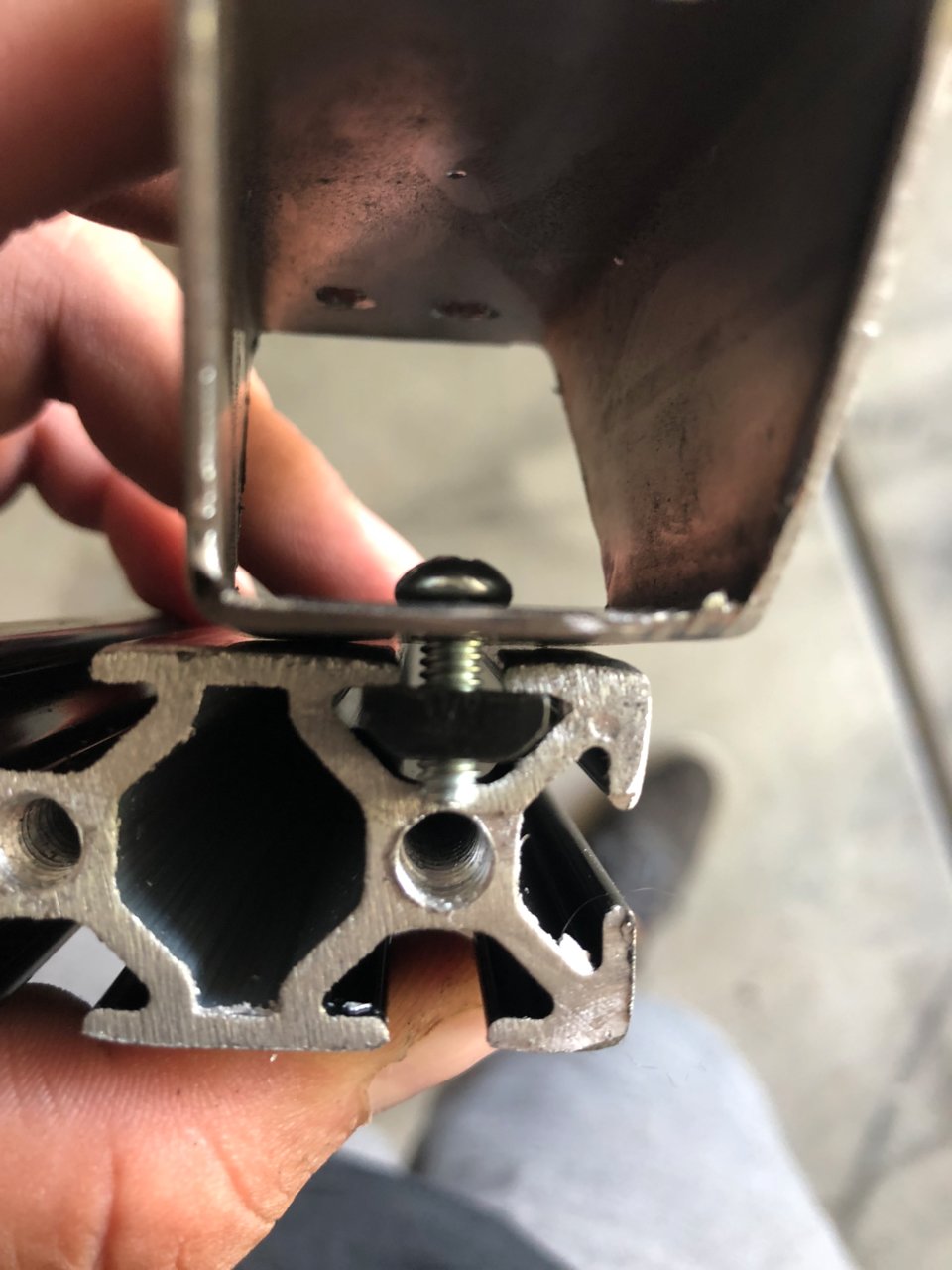

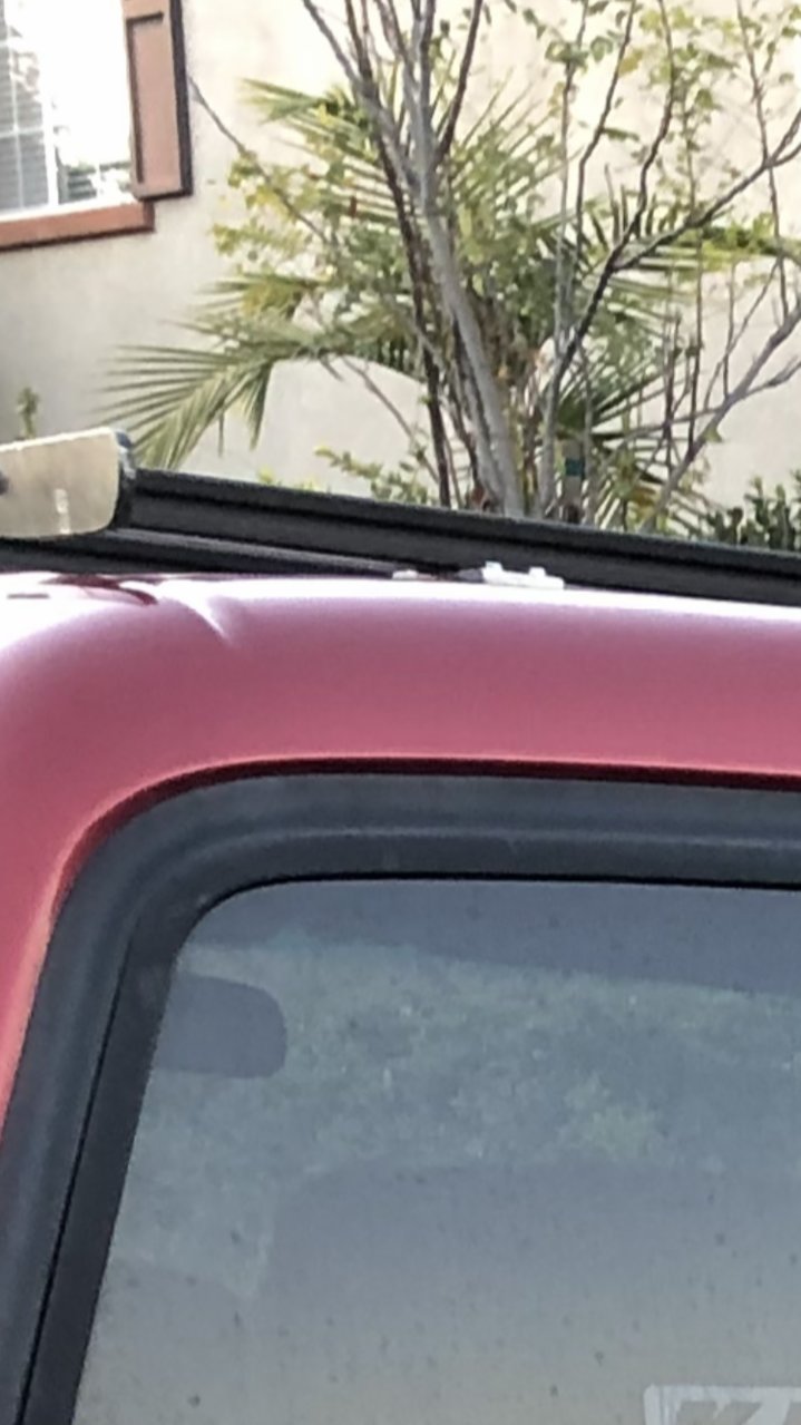

    There is some more pics of it on page 17 of my build thread but none really of the mounting.This picture was my first attempt at mounts, and ended up not working out. I did use the little connector nut and bolt shown in this picture though. What I ended up doing was getting aluminum, 1/4" thick and grinding them down to fit the roofs contour(as flat doesnt work if you are mounting close to the edges for stability). Then I drilled a wide hole about half way through the material with a hole all the way through the first hole. That way the head of the allen nut pictured in the photo was flush with the bottom side of the mount. I did two nuts/bolts per aluminum mount.
    Then to protect from water leaking in, I cut a neoprene squares with a waterproof goop/glue material to insure absolutely no water could enter. I then drilled holes into the roof of the truck and installed riv nuts to attach the aluminum mounts to. Sorry I dont have pictures of the mounts and dont have the truck now to take any new ones either

    Here’s two more horrible quality pictures, had to zoom in on a phone picture. But the fronts I made a little L bracket, and the rest are the 1/4” aluminum pieces 123672B3-C0F0-45F6-A8A3-5FCE59629E61.jpgB6869FA3-F06E-412A-B515-BB6FA4899F94.jpg
