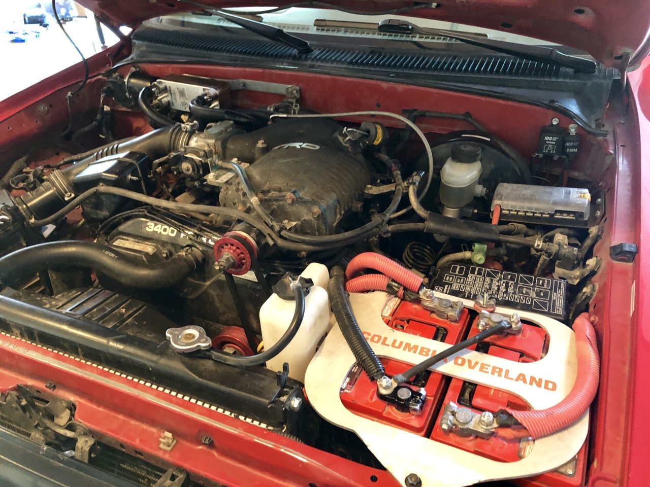

    2004 Toyota Tacoma DC TRD 4x4
    ADS Coilovers & Shocks, All Pro Standard Leafs, TRD Supercharger, Haltech Standalone, URD 2.2'' pulley, Method NV wheels, Copper Discoverer STT Pro tires, ECGS 4:56 gears, custom steel tube bumper, custom steel skid plate,
    I got my dual battery system working again today. I was going to move one battery over to the passenger side but found out that these batteries are too tall to mount over there without hitting the hood. Didn’t want to spend a few hundred on a new shorter battery so I just went back to the original setup. I think I’ll mount my ARB air compressor where I was going to put the battery, and put my shower pump back in as well.

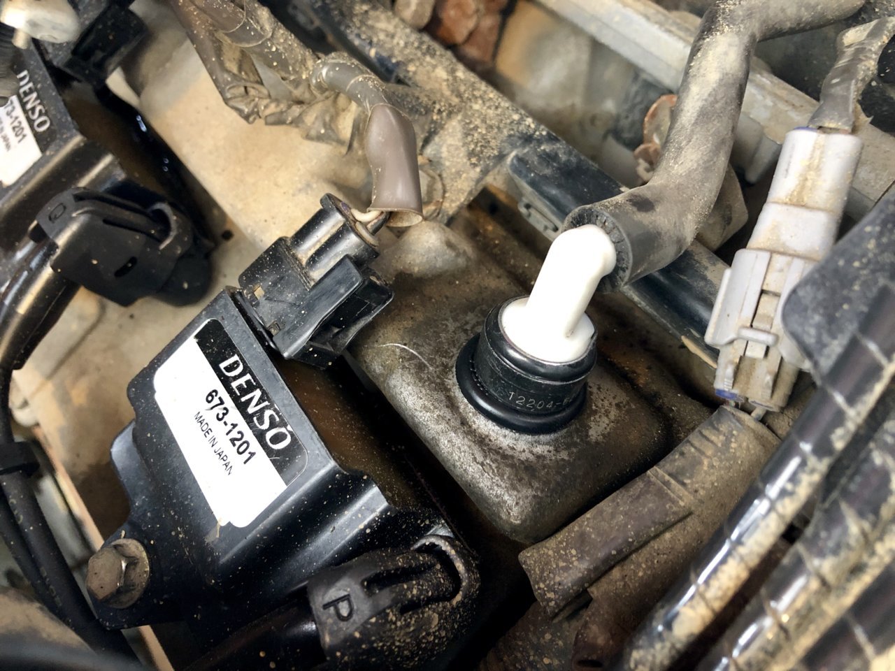

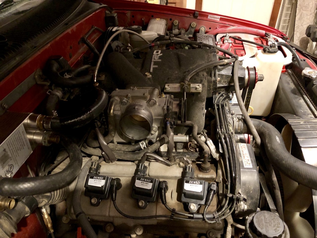

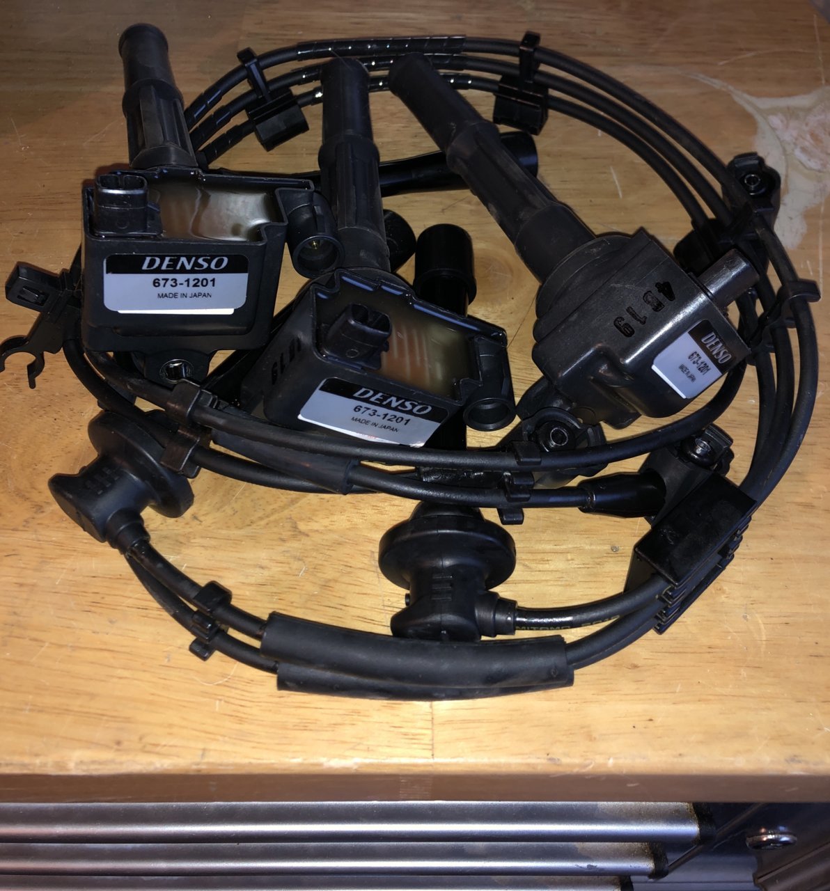

    Installed new Denso ignition coils and OEM wires today. Pretty sure my ignition coils were original with 227,000 miles on them. The engine seems to be running much smoother after swapping to the new coils. Now to replace that leaky PCV valve...
    Replaced the PCV valve.

    2003 4Runner V8 - 2012 b00sted XRunner
    I have mods
    Looks like maybe you should have done the hose too.

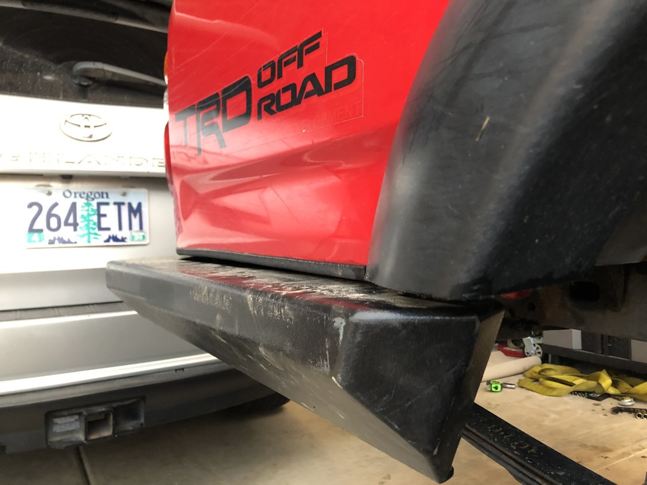

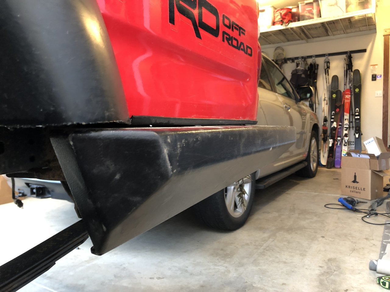

    Got the bumper alignment quite a bit better.
