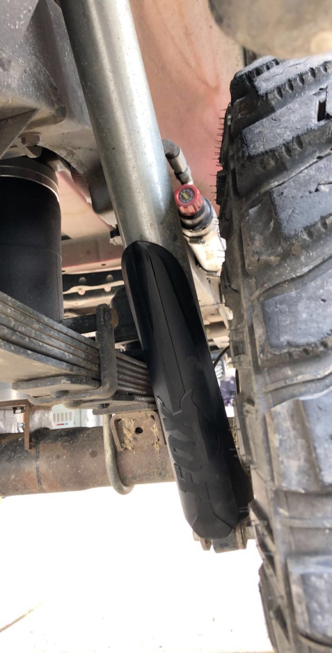

    Swung by @Wheeler's Off-Road Inc today to pick up some fox roost guards. With a little bit of jimmy rigging I was able to make them work on my ADS shocks. My last set of shocks chipped to the point where it was damaging the oil seal, so I'm trying to not go through the same experience with these ADS shocks.

    What did you have to do to make them fit? Trimming, zip ties, epoxy ... ?

    At first I just drilled the mounting hole out to 7/8'' which is the diameter of the shock shaft, but the roost guards were floppy. To fix this I took a rubber stopper and made a bushing out of it that added support further up and down the roost guard.

    Can you post a photo of the back side to show this? I'll probably be doing this once I can afford ADS coilovers + rear shocks.
