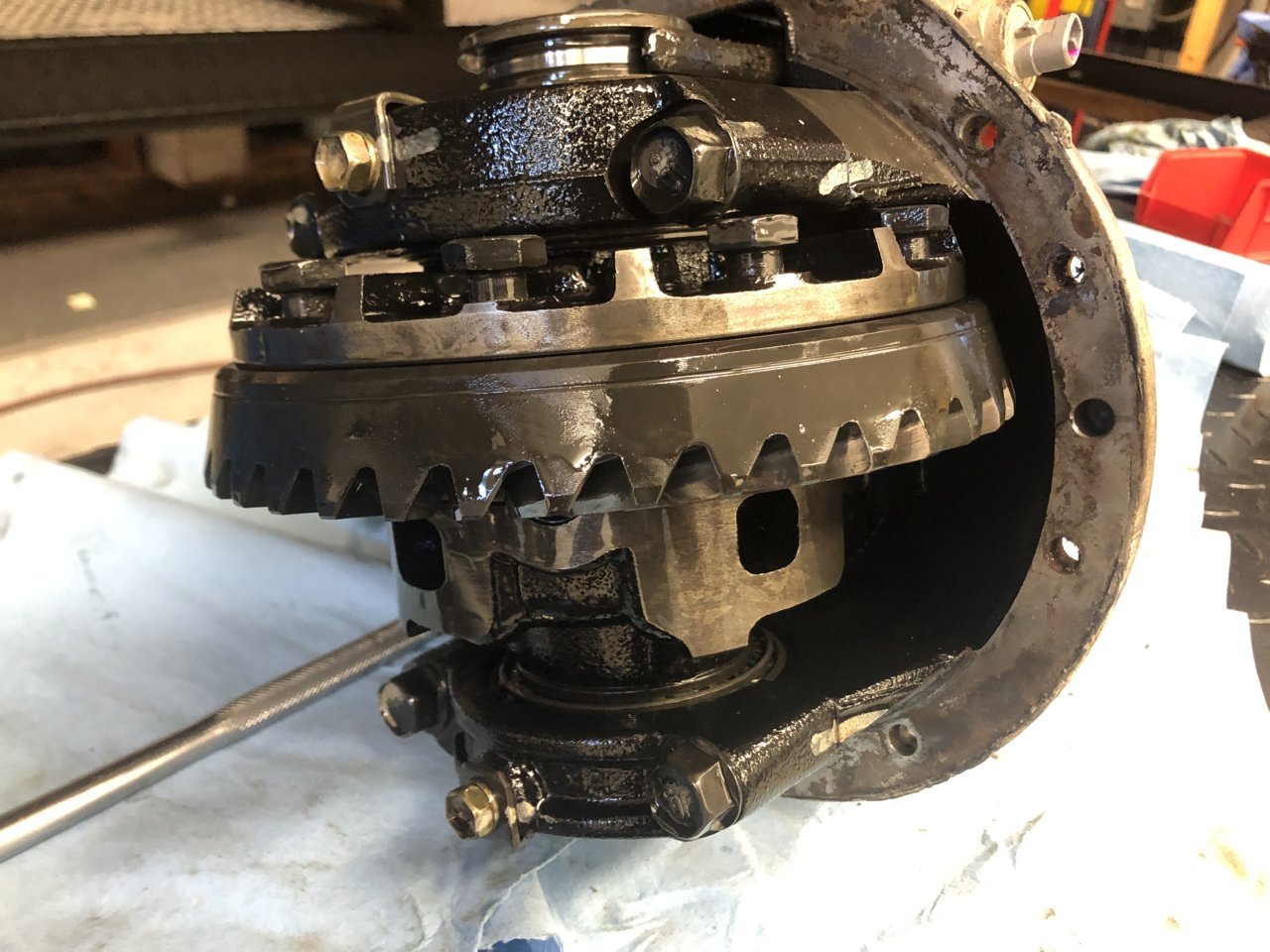

    Pulled my 3rd today to see what's going on. Turns out that half the bolts that hold the ring gear on had backed out and the other half were finger tight. The ones that are standing up are scraping the inside of 3rd member casing and chipping away metal. Thankfully ECGS warrantied my 3rd no questions asked, so I'll have a new one in on Thursday.

    Hm. No locktite and must not have been torqued properly

    Yup, wish I found this earlier, would have had them instal lock straps on the bolts in the new diff now that I'm paranoid.

    Standard with a 8.4 diff. Not sure why it's not for the elocker.

    Weird. Not sure why you wouldn't just use them in all diffs, seems like good insurance.

    yeah you'd think ha
    Usually they are red locktited on though and should be properly torqued. So that shouldn't happen.

    That's the second 3rd I've seen from ECGS that had the ring gear bolts back out. Guess they don't own loctite or a torque wrench. :rolleyes: I would at the very least check the toque on the new one, or pull the bolts and add loctite.
