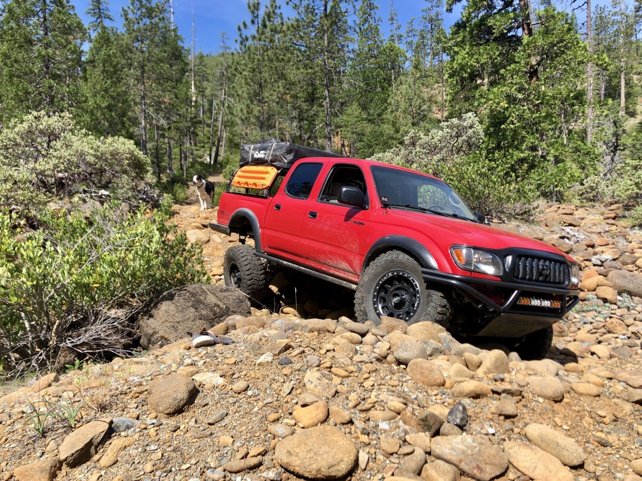

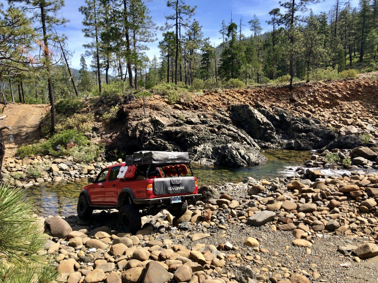

    Went on a quick overnight trip to one of my favorite local spots.
    Unfortunately going to and from here while on the freeway the truck was making some awful driveline noises and vibes. I really need to get it figured out.

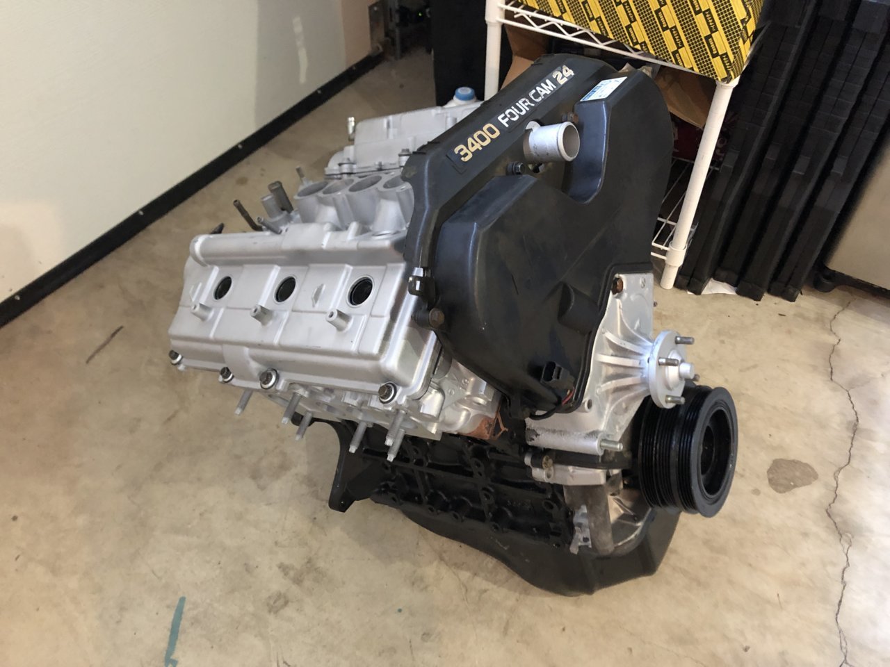

    I've had this guy sitting in my garage for awhile now, just forgot to post. I think I'll start the swap this weekend.
    In addition to the engine swap, I'm going to put in new motor mounts, box / gusset the motor mounts, rebuilt the supercharger, burn in some coil bucket gussets, and clean up a few miscellaneous things.

    Awesome! :popcorn: Might as well while you have the most space in there.
