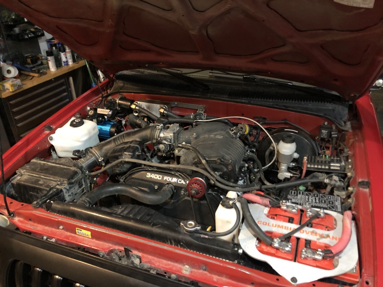

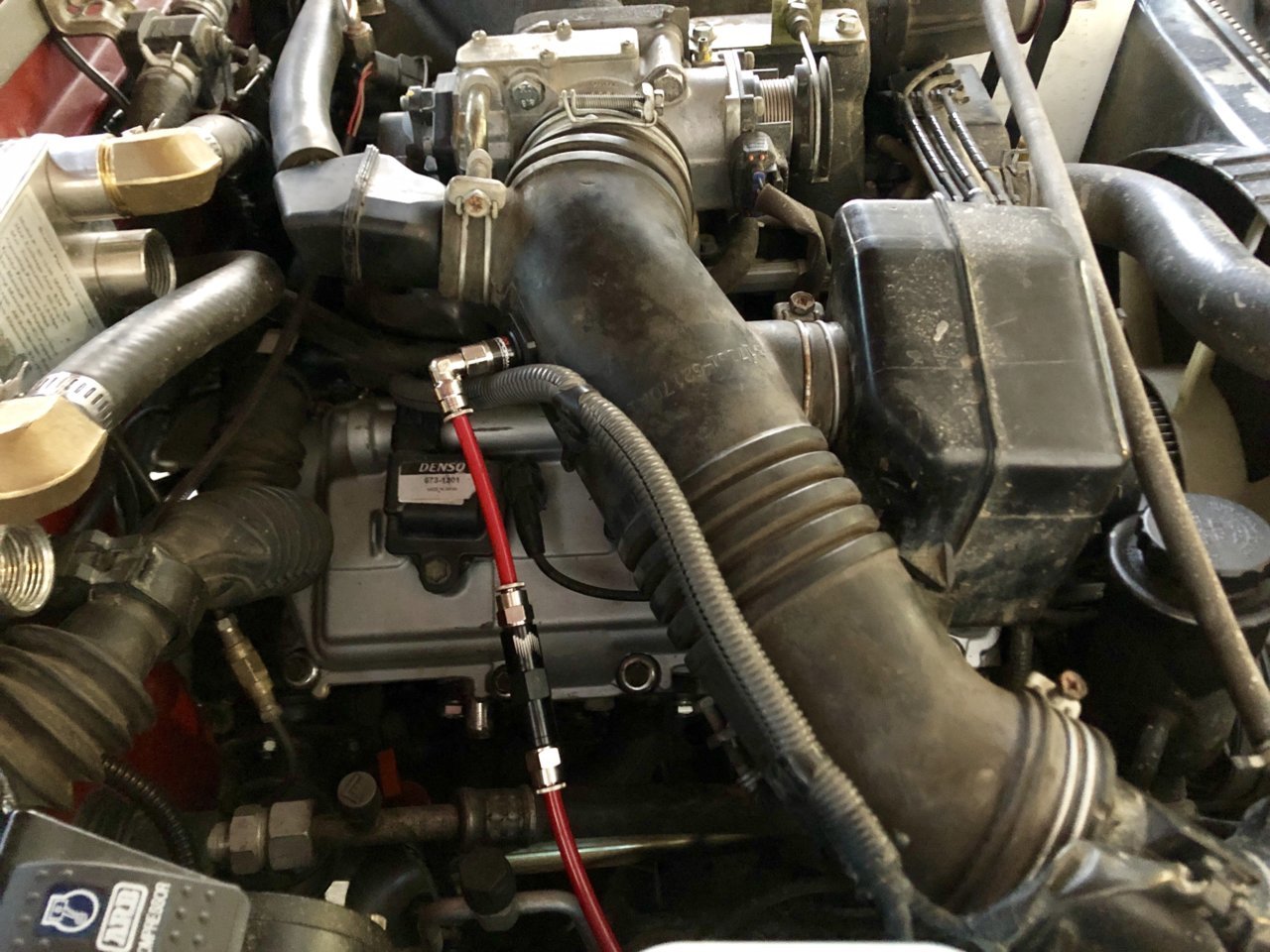

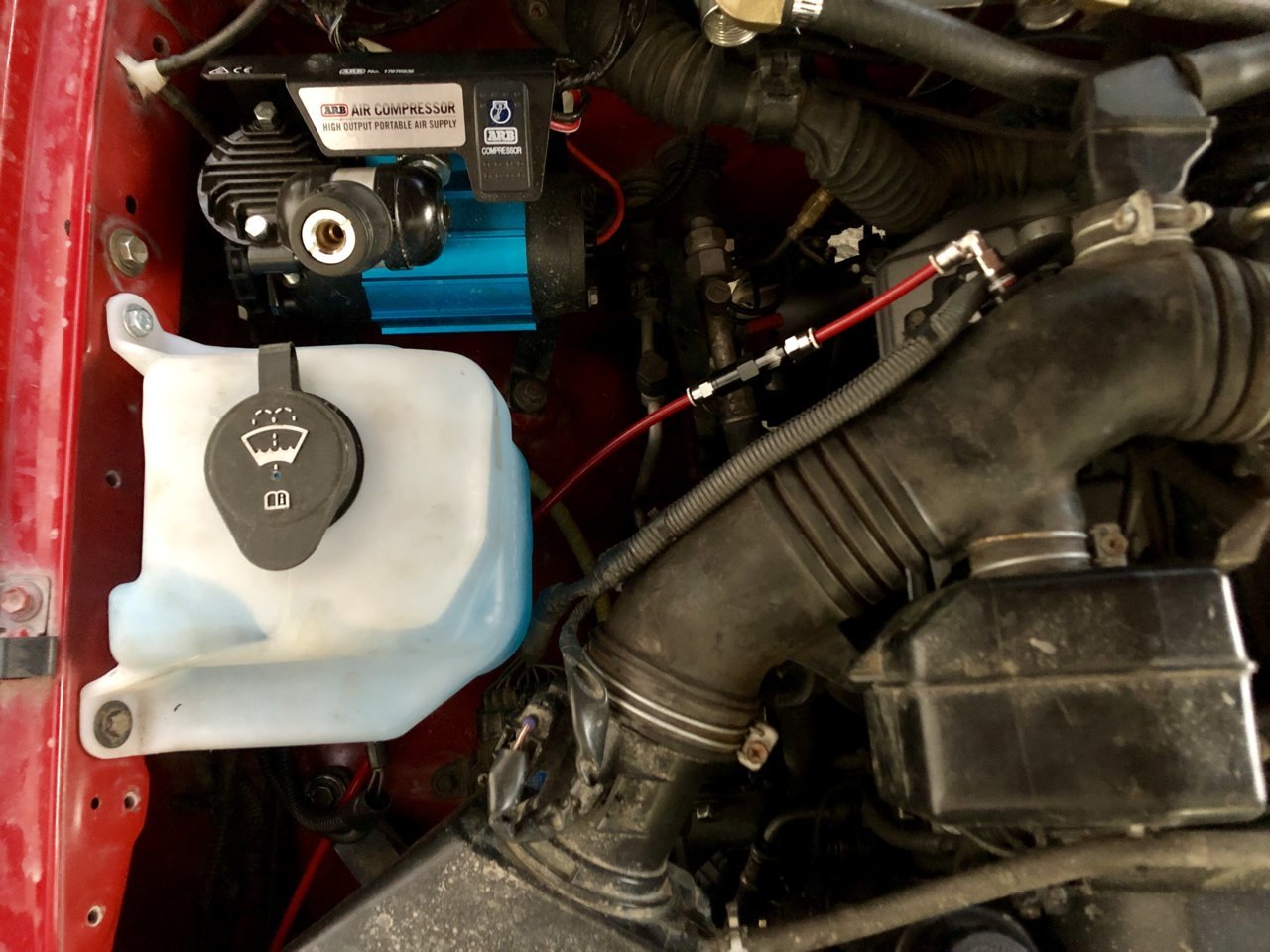

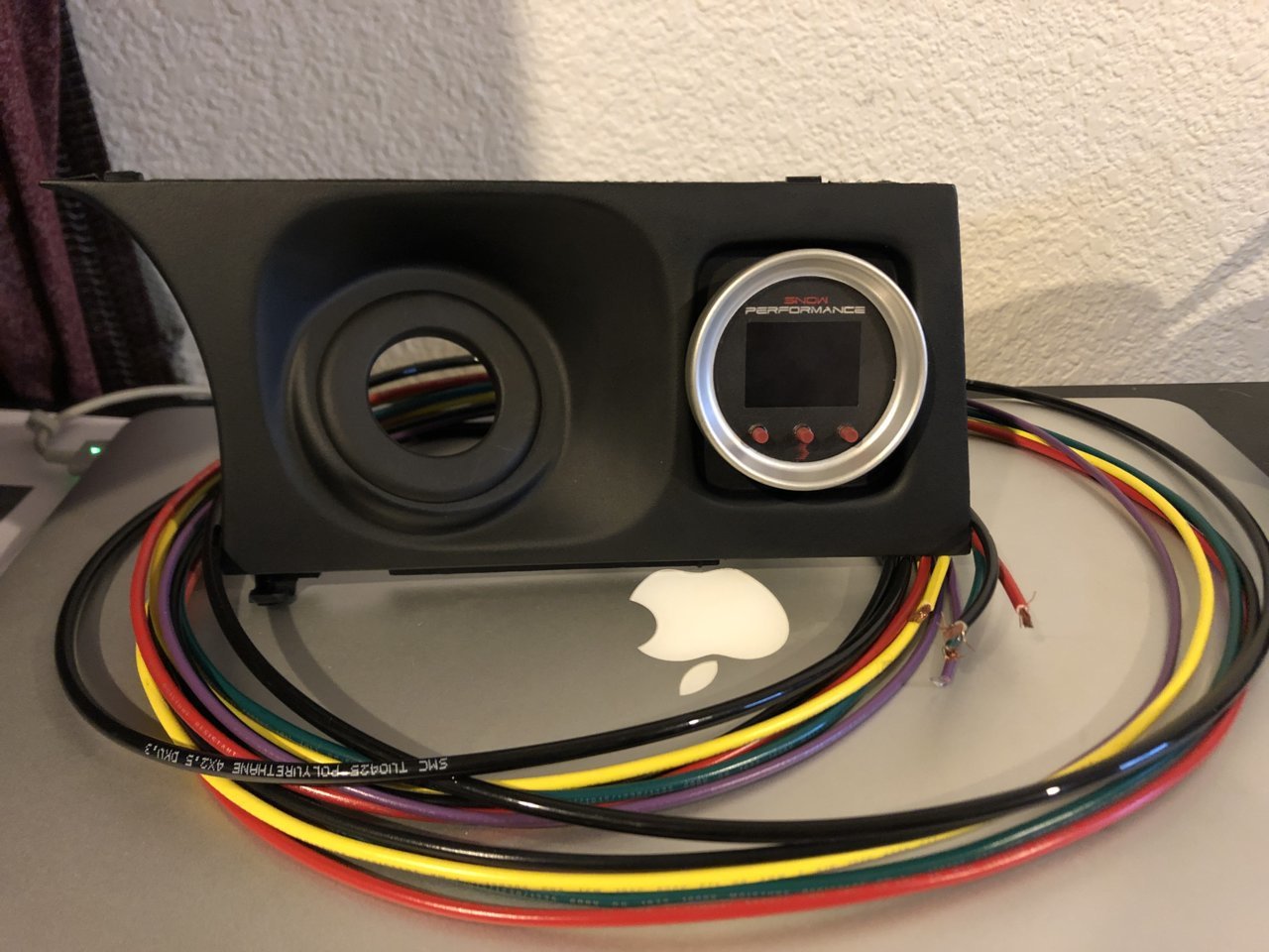

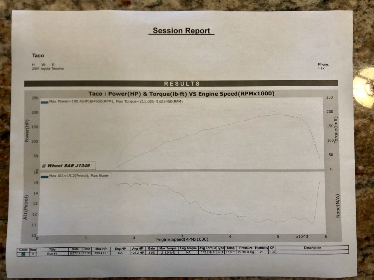

    It's been awhile since my last post on here. I got the new engine wrapped up, got it dyno tuned, relocated my washer fluid reservoir, installed my ARB compressor under the hood, and started piecing together my methanol kit.
    The new tune on the truck removed any pinging I had and it pulls so much harder and more consistent between 60 - 100 mph. I plan to use this tune as a jumping off point for either a 2.0 or 2.1 pulley and methanol.

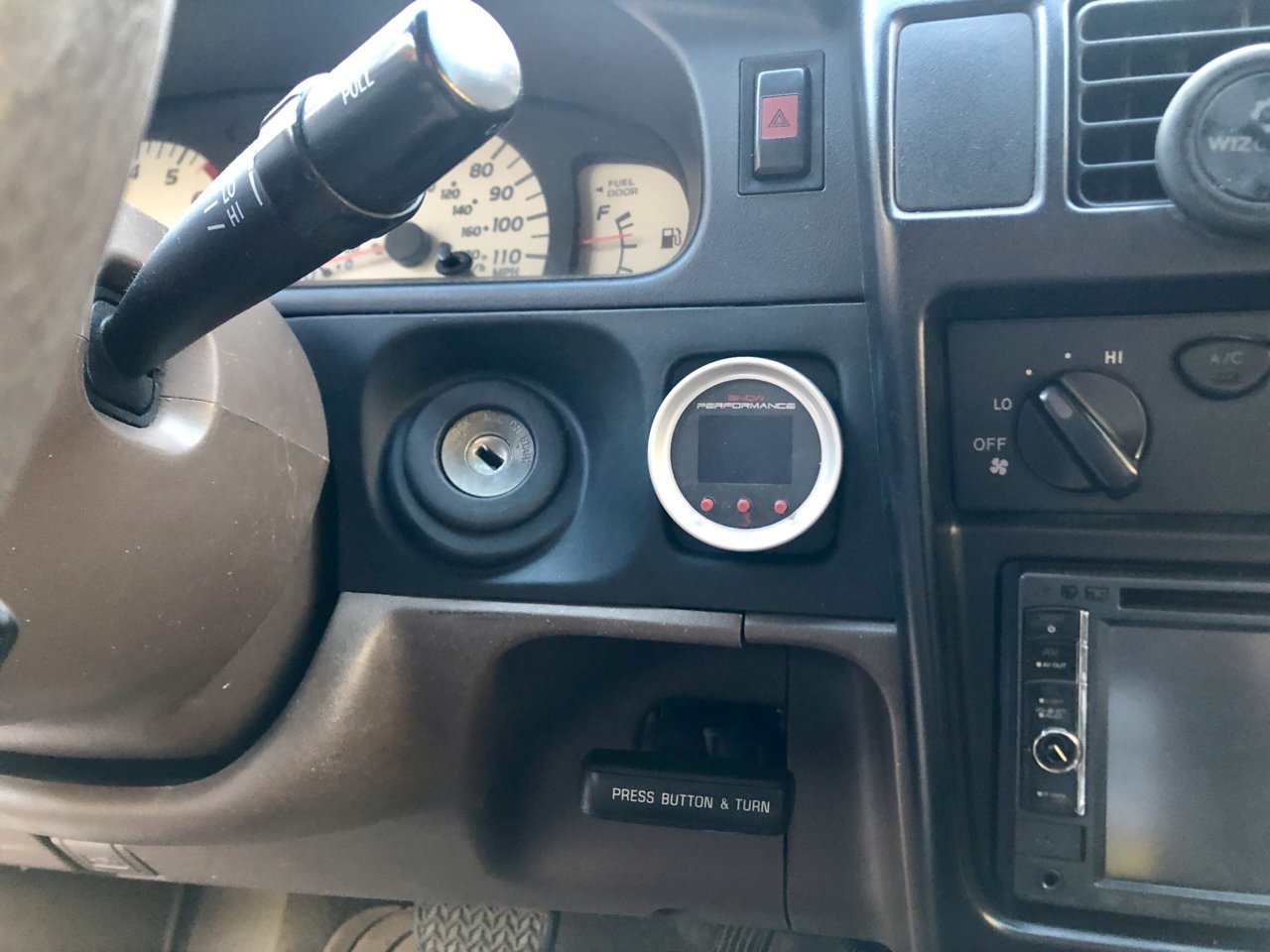

    Swapped out the ignition bezel for a clockless one so I could install my methanol controller where my clock once was.

    What did you use for the tune?
  5. Sep 27, 2019 at 8:29 PM
    #545
    austinmtb
    austinmtb [OP] Well-Known Member
    Feb 26, 2017
    #211727
    1,054
    Austin
    Southern Oregon
    2004 Toyota Tacoma DC TRD 4x4
    ADS Coilovers & Shocks, All Pro Standard Leafs, TRD Supercharger, Haltech Standalone, URD 2.2'' pulley, Method NV wheels, Copper Discoverer STT Pro tires, ECGS 4:56 gears, custom steel tube bumper, custom steel skid plate,
    FTW Tuning dyno tuned my 7th injector.

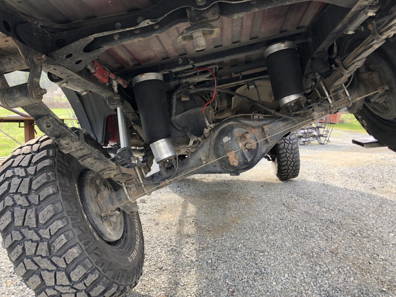

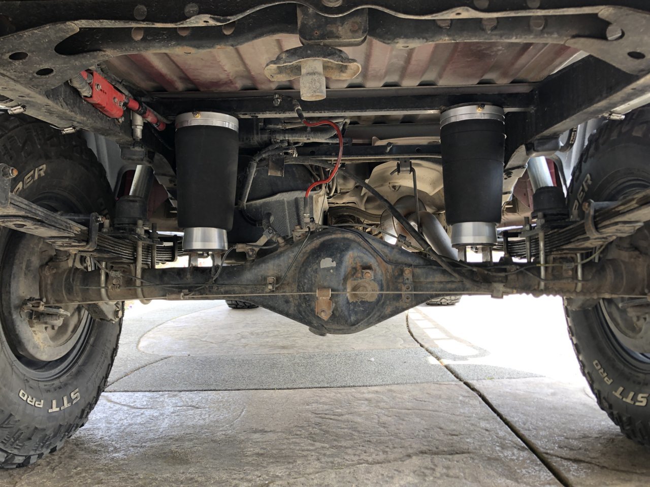

    They’re Carlie airbags. They’re the longest travel airbag I could find. Carie doesn’t sell just the bags on their website, but if you give them a call they will.
    Also, check out page 11 on my build thread to see how I built the setup. To open up enough space for the bags, it requires removing the brake proportioning valve and installing a manual valve, rerouting cables and brake lines on the axle, rerouting the e-locker wiring harness, and rerouting the e-brake cable.

    I was afraid of that, those Carli kits are so $$$.
    I've been planning to do a similar setup on my truck, probably using the W02-358-7081 bag however, because I'm cheap.
    The vertical travel capability is similar, but its an air bag for air ride cabs, and is only like 3" in diameter, so I think the load leveling capability will be pretty low.

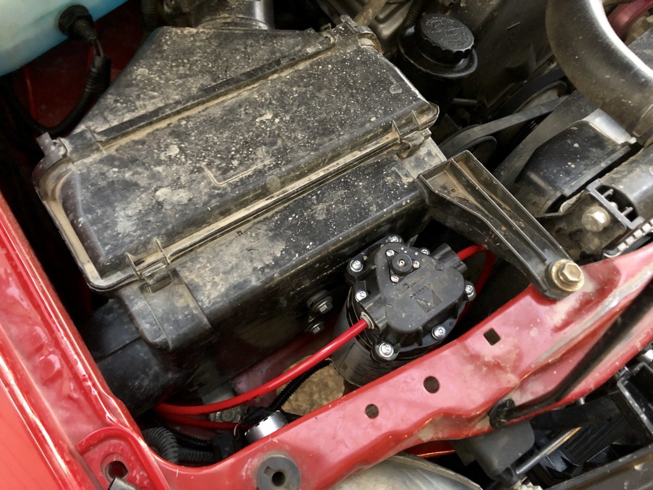

    Got the methanol injection kit installed, now I just need a smaller pulley. I'm running the URD 2.2 at the moment and can't decide if I want to go with a 2.1 or 2.0...

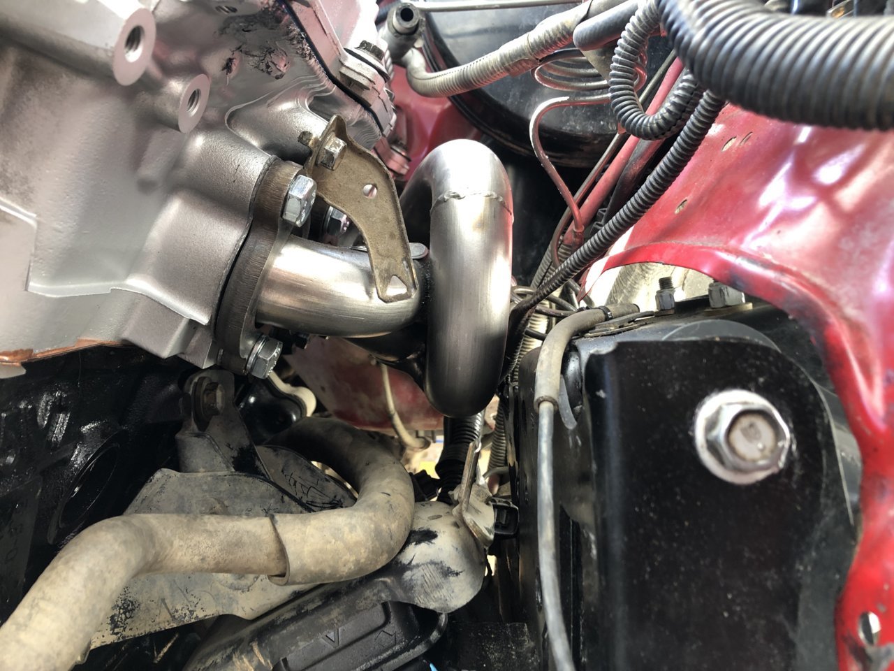

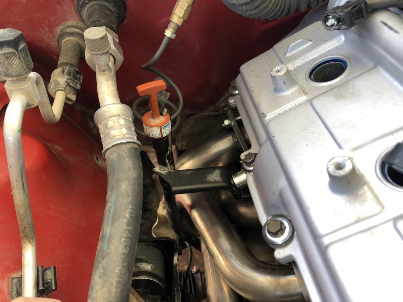

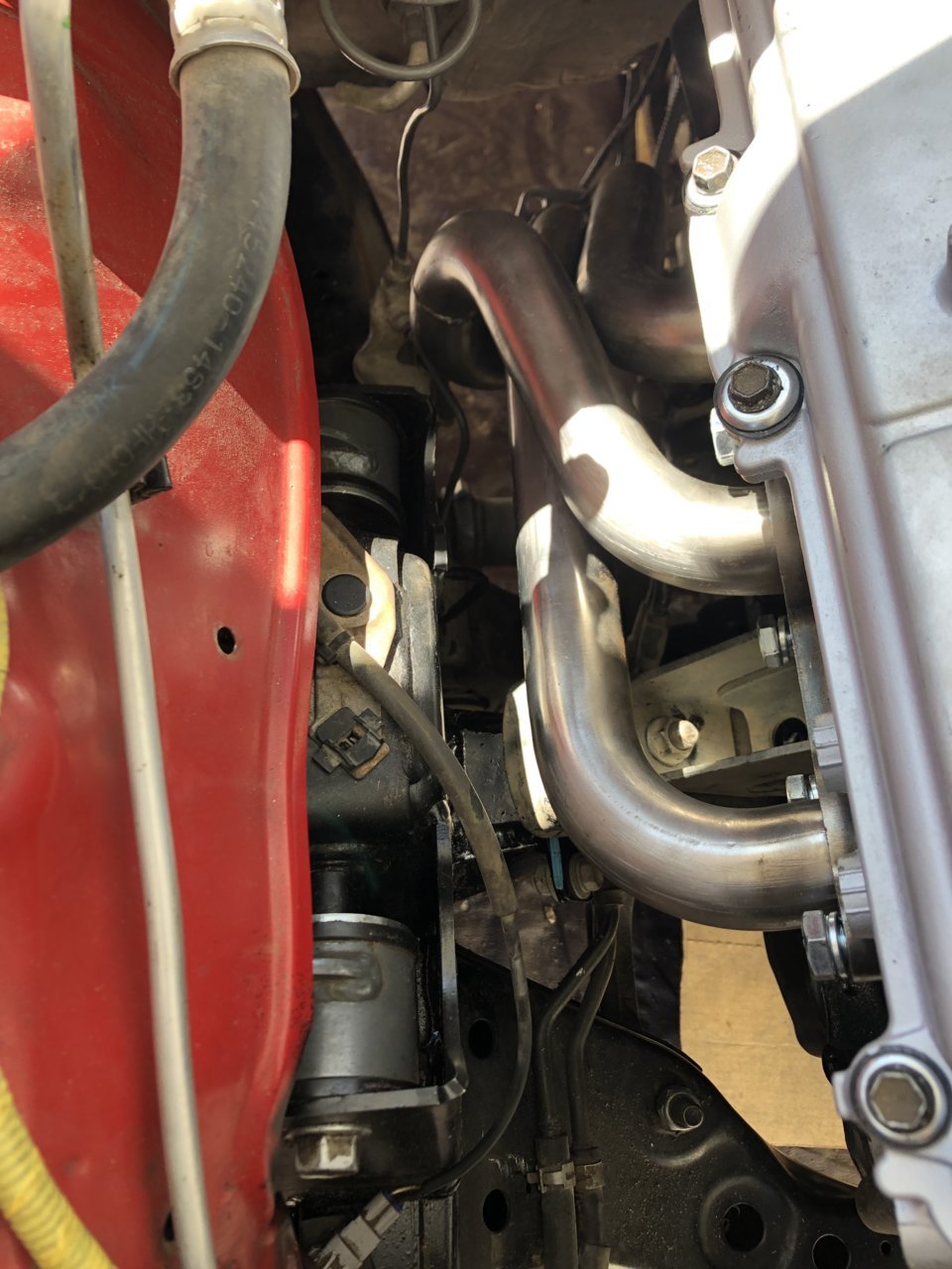

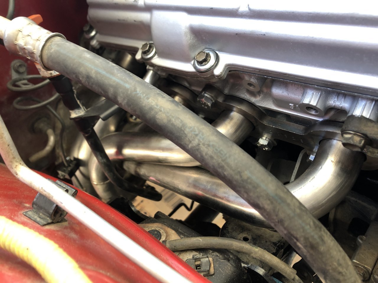

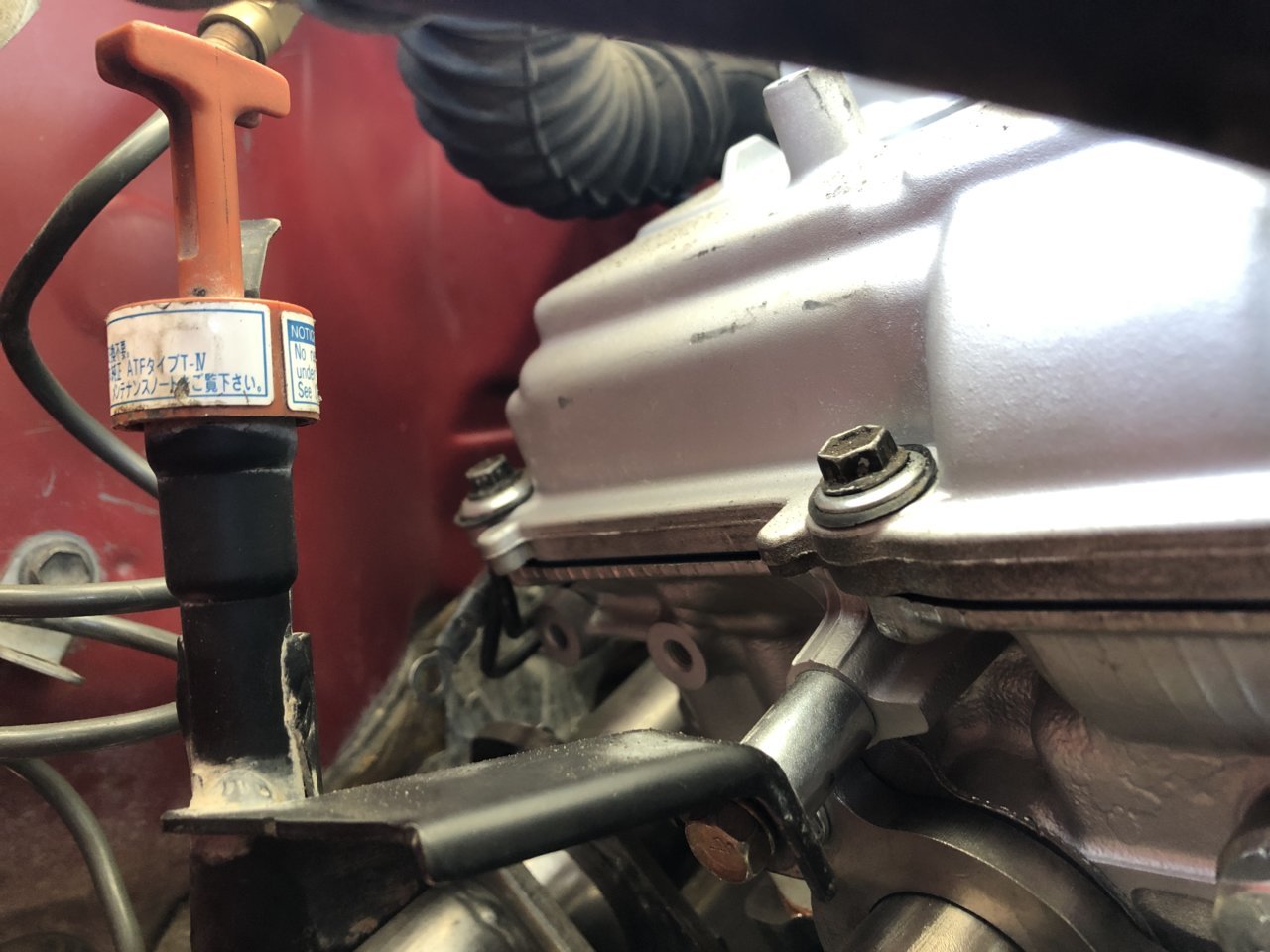

    @JasonLee here are the header clearance pics you were asking for.
    For the trans dip stick I had to bend the tube at the tranmission a bit to get it to come up through the headers in the right direction, and used a 1'' spacer at the trans dip stick bracket - engine mount.
