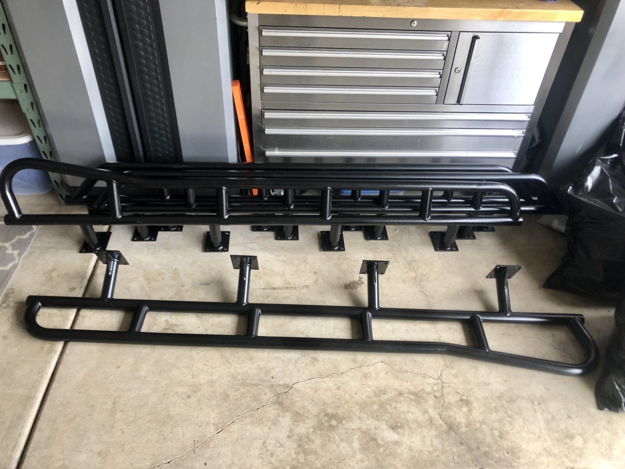

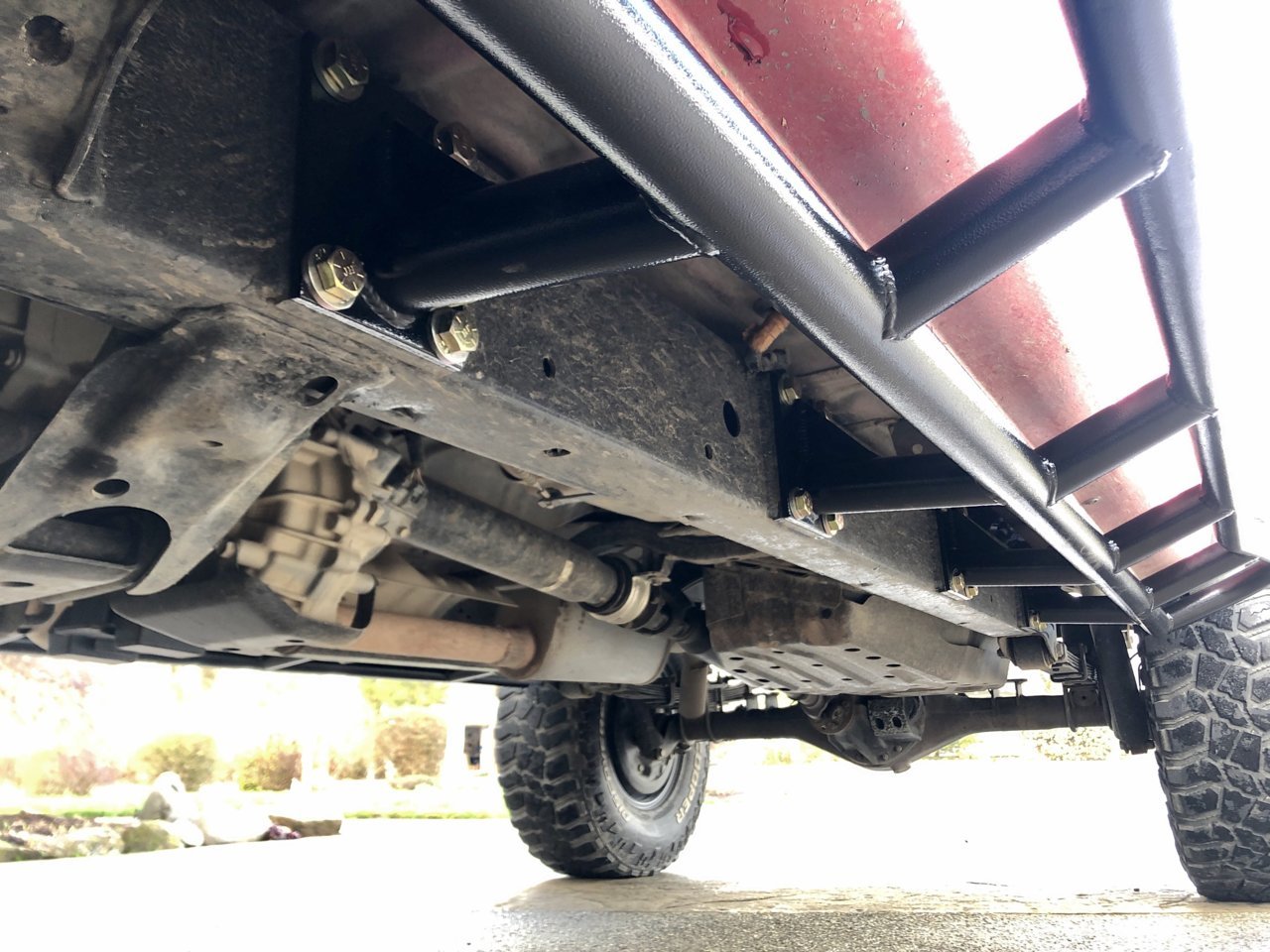

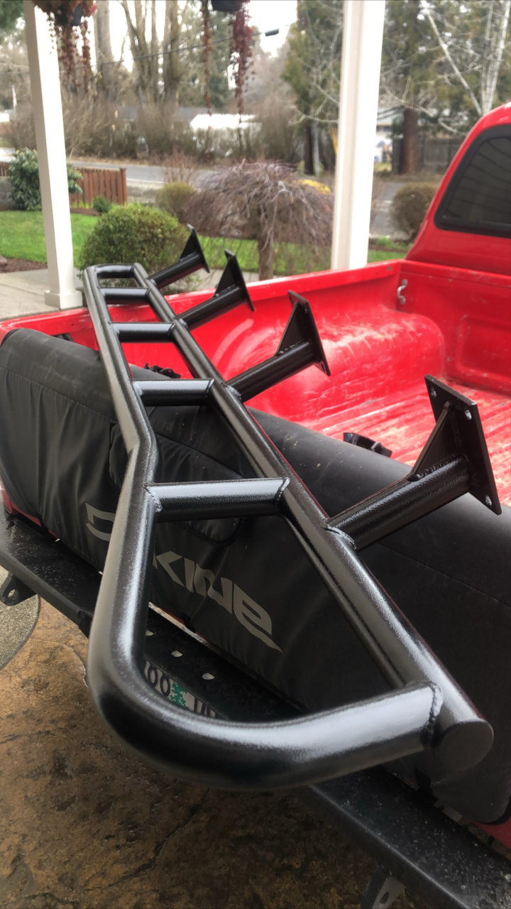

    Received my sliders back from the powder coater and got them bolted up. So far I'm loving the hybrid mounts. They no longer rattle like my old bolt on setup. I also pitched these up to 20 degrees of tilt (old ones were 10) which hugs the body tighter and looks a little cleaner IMO.

    Probably the best "bolt on" slider solution that i've seen that doesn't clamp the frame in some sort of way.
    Don't imagine that you'll be doing any rock crawling or really bouncing off of those sliders, but i'd be curious on how those bolts and threads in the plate hold up to some abuse.
    Also, i'm curious about the solo stock length lowers. They state that they loose the functionality of the factory steering stops. So what is there to prevent you from oversteering the wheels? Does the rack and pinion have an internal stop?
    Looks great man! :thumbsup:

    I know the threads aren't super deep, but the bolts aren't taking any impact and that load is distributed over 16 large bolts, I think that should actually hold up to some serious abuse... As long as the bolts don't back out, that's a solid setup IMO. Curious for sure.
