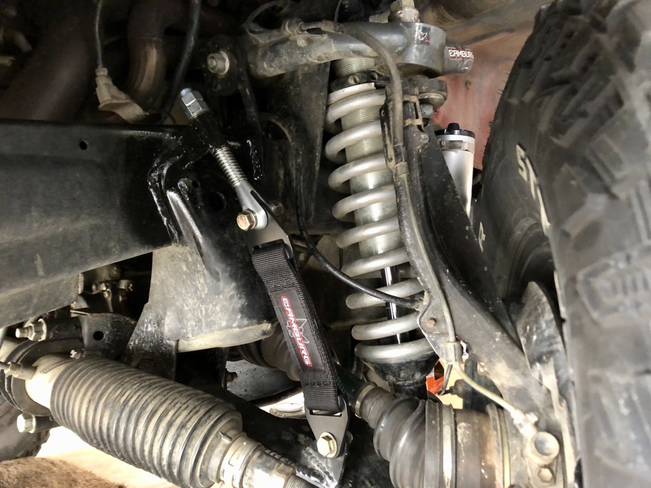

    During compression, what keeps the straps from getting squished in the coil or pushing the brake lines into the coil?
  20. Feb 29, 2020 at 3:42 PM
    #620
    austinmtb
    austinmtb [OP] Well-Known Member
    Feb 26, 2017
    #211727
    1,054
    Austin
    Southern Oregon
    2004 Toyota Tacoma DC TRD 4x4
    ADS Coilovers & Shocks, All Pro Standard Leafs, TRD Supercharger, Haltech Standalone, URD 2.2'' pulley, Method NV wheels, Copper Discoverer STT Pro tires, ECGS 4:56 gears, custom steel tube bumper, custom steel skid plate,
    The strap is far enough away from the coilover that I don’t think that’ll be an issue. I could see it possibly pushing the brake line into the spring though. I didn’t even think about that, I’ll have to keep an eye on it.
