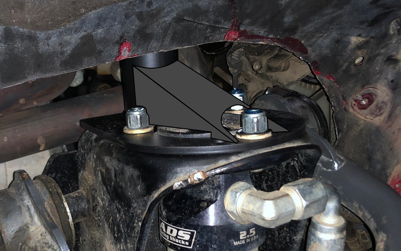

    Second shock option is always nice. Maybe I'll have to incorporate a second shock tube mount if I gusset my crossover in that area.
    While we're on that topic, have you ever ridden in a truck with a second shock? If so, does it make much of a difference in ride quality?

    However, it's one of those things that when people add them they go..I should have done that years ago. Had buddy who rode in a truck with dual bypasses up front and said it was awesome.
    Now, there is a debate on if it is worth it on mid travel or not given the travel is lower than a LT truck. That I'm not so sure about. I'd always planned on doing secondaries on my LT rig before the MT one.

    So will you never weld the shock tower gusset to the tower itself?

    Probably not, wanted to keep it removable.

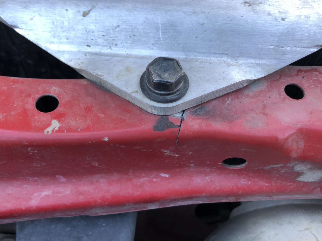

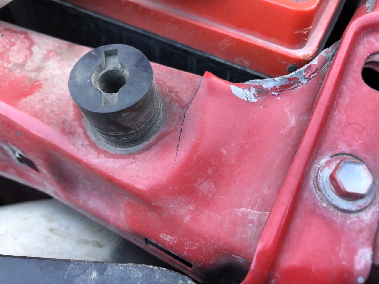

    Should I just cut the whole front end off and tube it? :annoyed:

    Brah...you jump your truck. Lol. Shits bound to break. Sucks man :(

    Yeah I figured this day would come eventually. It doesn't help that there's two 50lb batteries in that corner.
    Probably just going to weld them up for now and build a custom front end down the road.

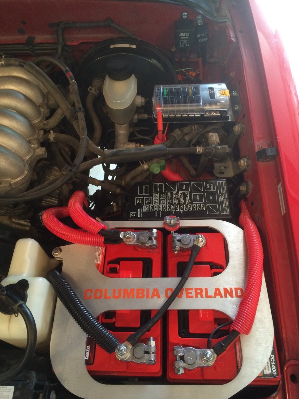

    I’m curious about your Columbia overland battery tray install. I bought one years ago and never installed it. I set the tray in there the other day and it seemed like I was going to need spacers for it to contact the fender. Do you have any pics of the tray installed with no batteries? I’m kind of wondering if I was sent a tray for a different application.

    Unfortunately the only pics I have of it are installed. My upper battery plate sits about a 1/4'' off of the core support, and has to be pressed down a little bit to start the bolt, and then the bolt pulls the plate down snug to the core support. This is probably why I'm developing a crack there. It might be worth using a small spacer and longer bolt to relieve some stress from the core support as long as you can still get the batteries tied down tight enough to not move around.
