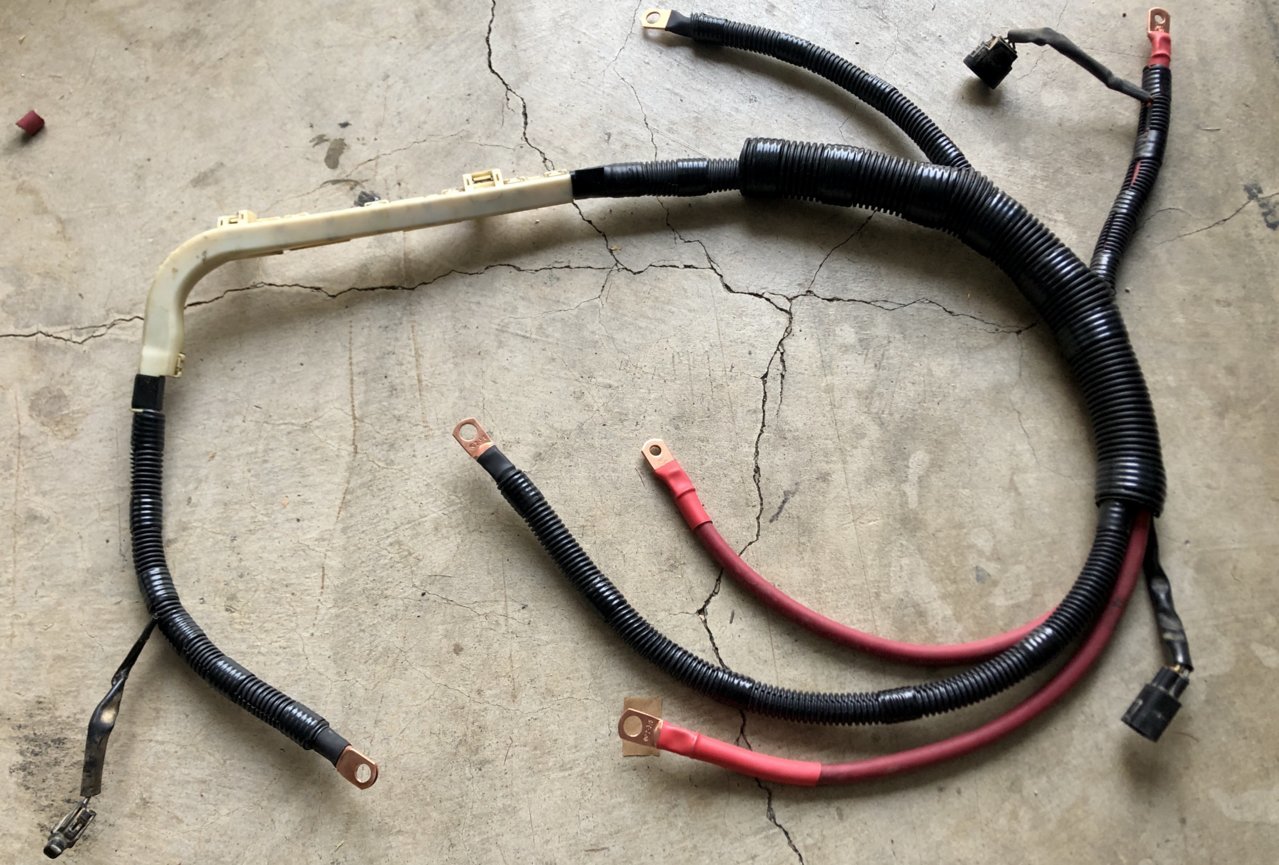

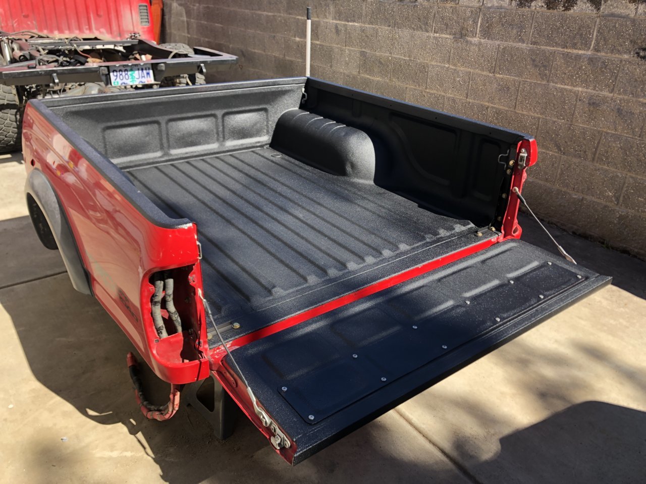

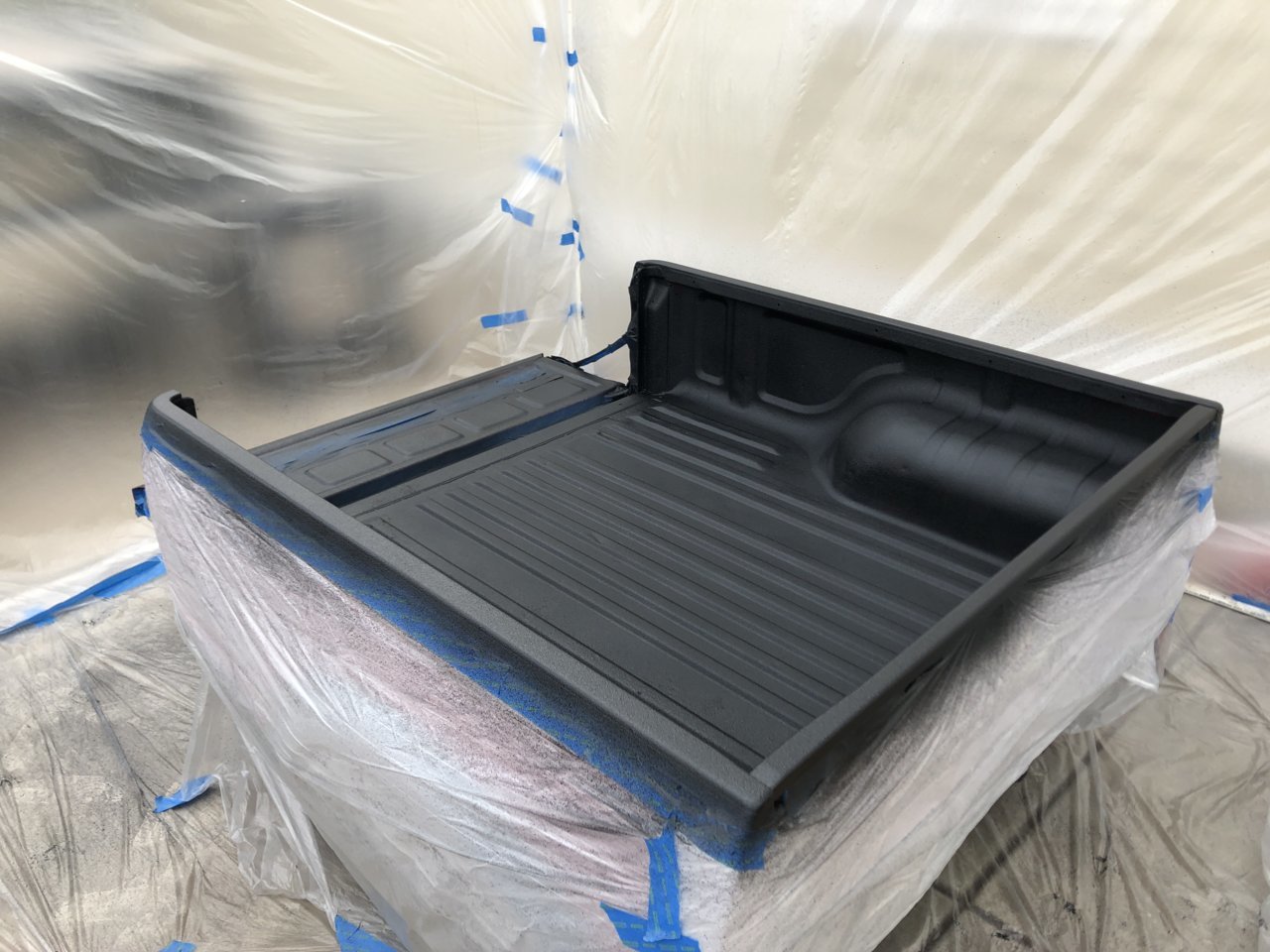

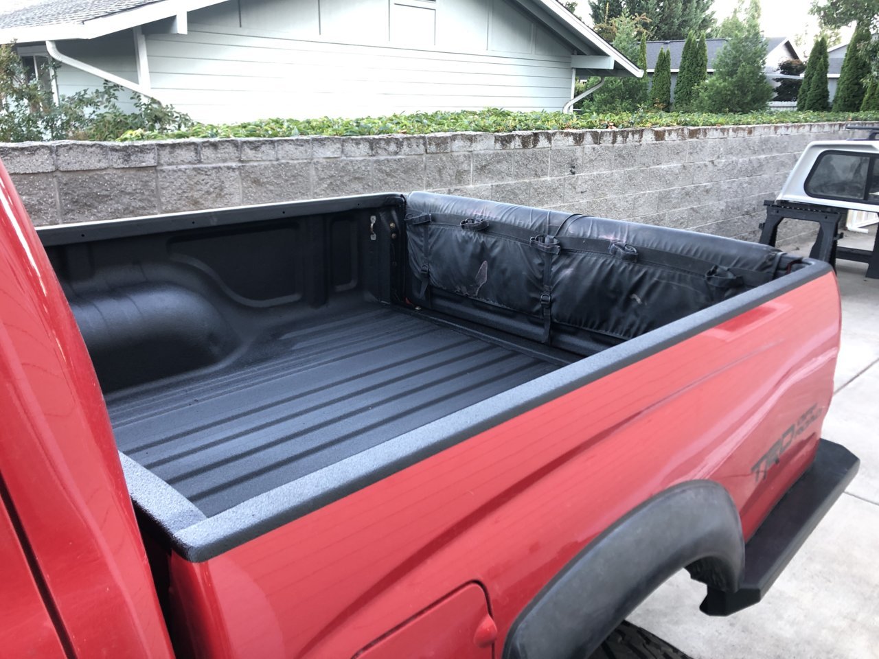

    While I wait around for my supercharger to come back from being rebuilt, I've had some down time on the truck to complete a few projects.
    First off was spraying the bed with raptor liner. It took me about 2 days to do the prep work, but spraying the raptor liner was surprisingly easy and I was able to achieve the texture I was going for. Thanks again to @Squeaky Penguin for the pointers!

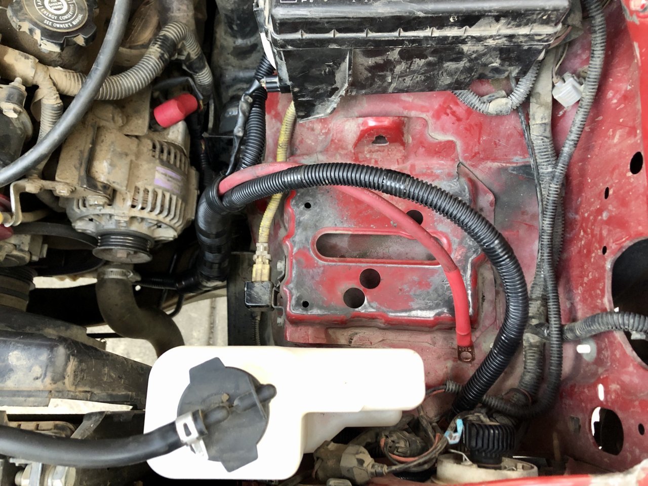

    I also went ahead and did the "Big 3" upgrade with some 2 gauge wire. Just need a little red loom still for the positive to my battery. A high output alternator will be going in soon as well. I decided to pull my dual battery system out due to the constant cracking and re-welding of my core support. Eventually a new system with a battery placed elsewhere will go back in but for now I'm just going to use a single battery. I picked up one of those fancy TRD battery hold downs that are sold by @Coupe on here, but I still need to fabricate a battery spacer so it will work with my Odyssey. I'll probably end up doing something like this (https://www.tacomaworld.com/threads...1400-battery-tray-winch-control-mount.317309/) so I have a nice spot for a winch controller when I get one.

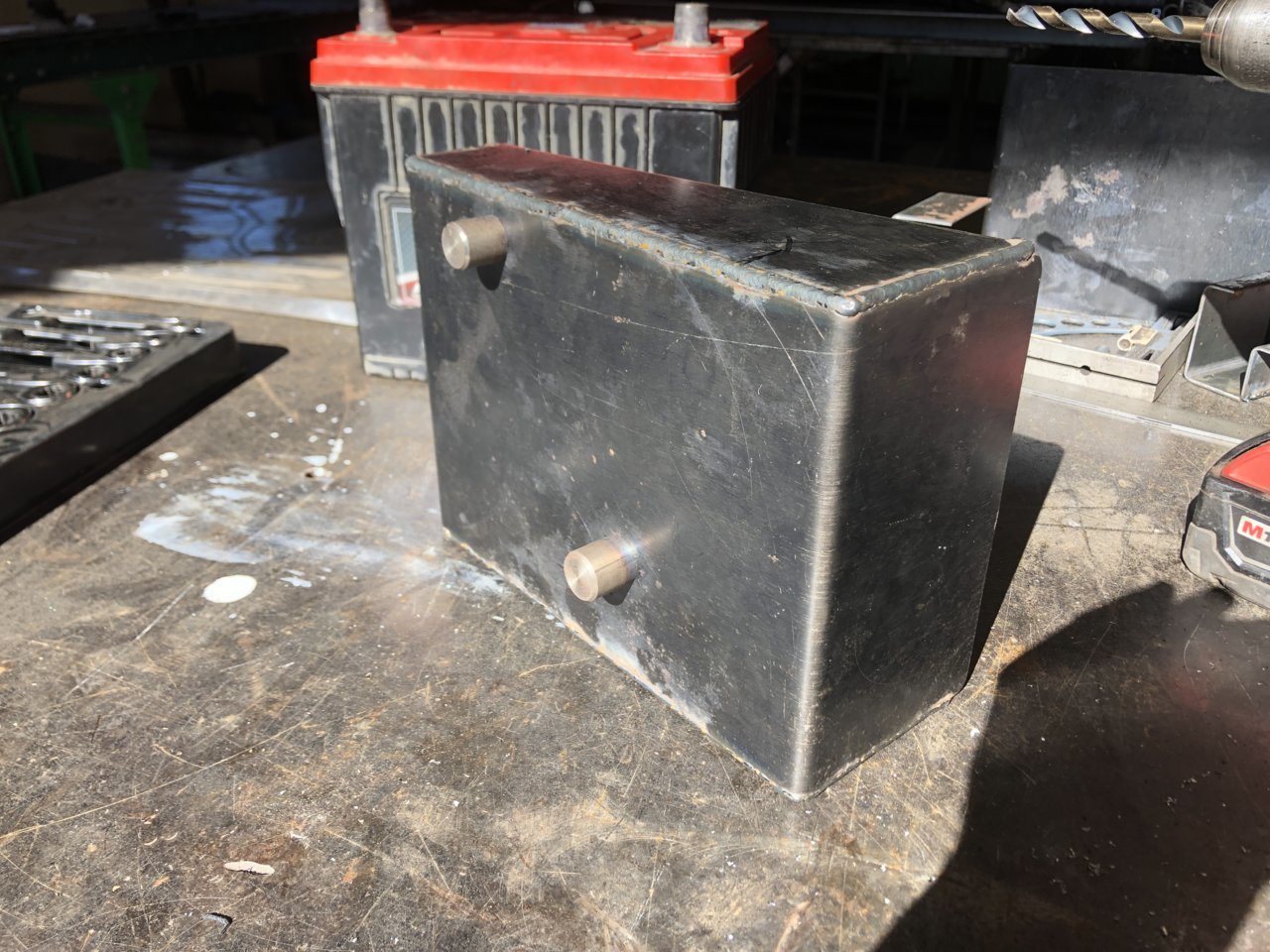

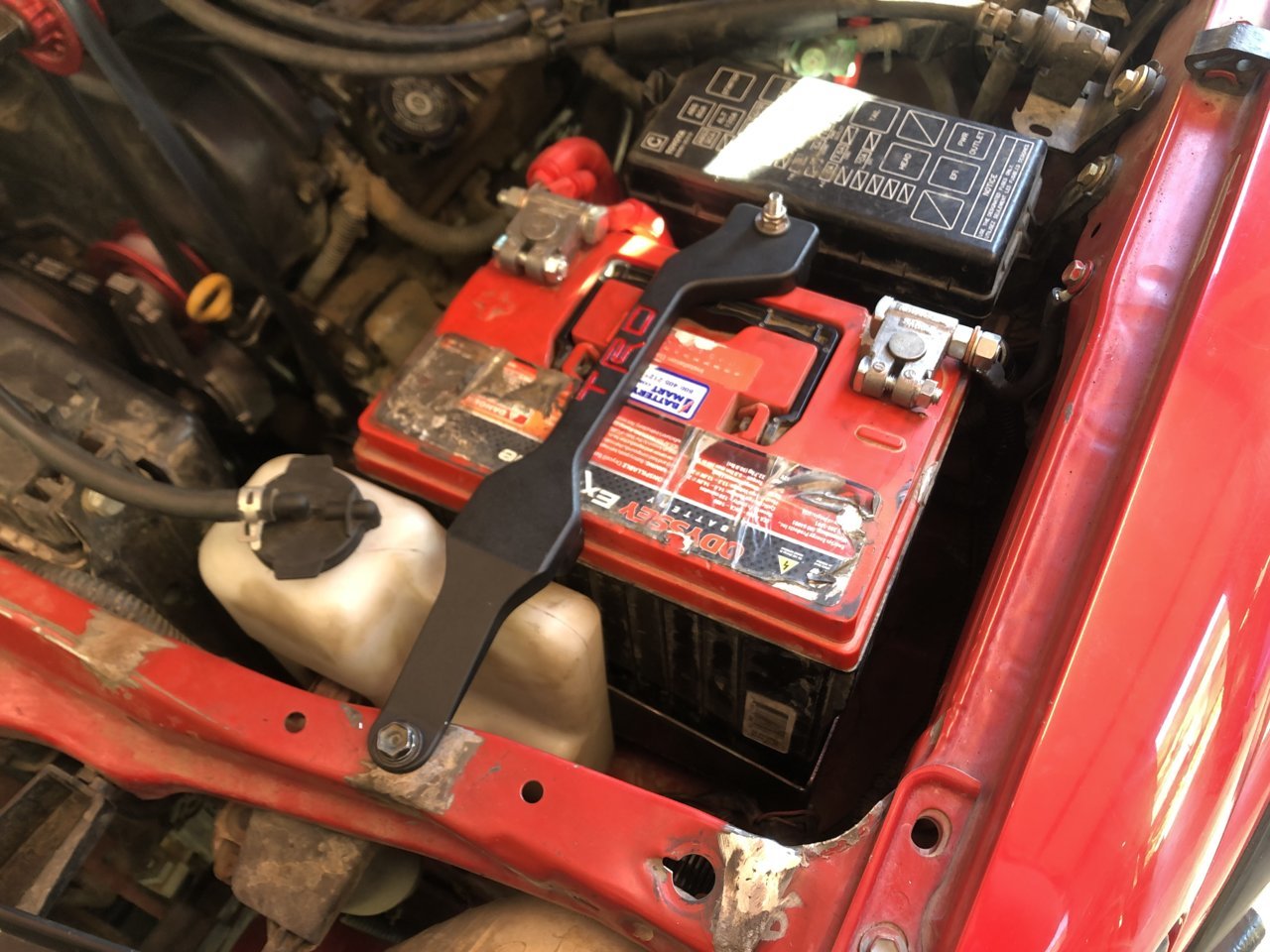

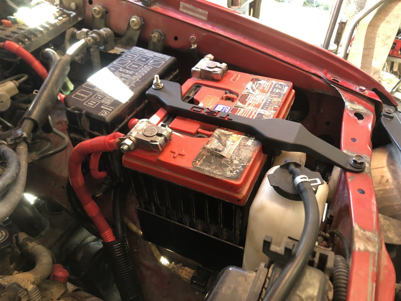

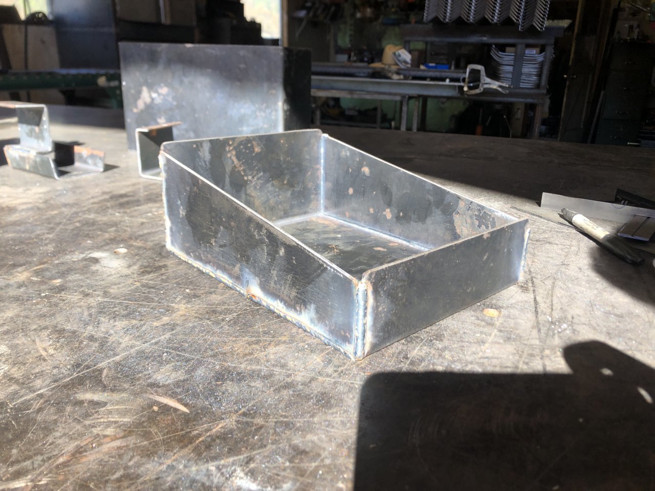

    Built a battery box today. I tossed the factory battery hold down parts when I installed dual batteries, so I no longer had a good way to install one battery. The side of the box will give me a nice spot to mount a winch controller once I get a winch.

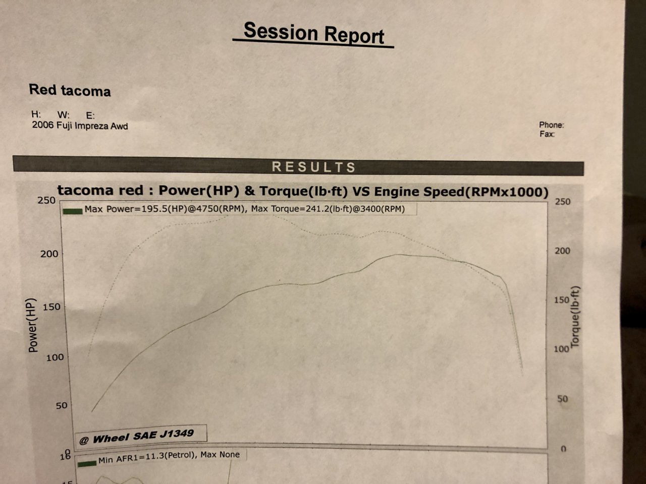

    Took the truck to FTW Tuning and had it re-tuned after the recent supercharger rebuild. Dyno'd @ 9psi of boost. Finally making the boost #'s I should've been making with the new rotor pack.
    G-shock!, Bandido, TMFF and 1 other person like this.

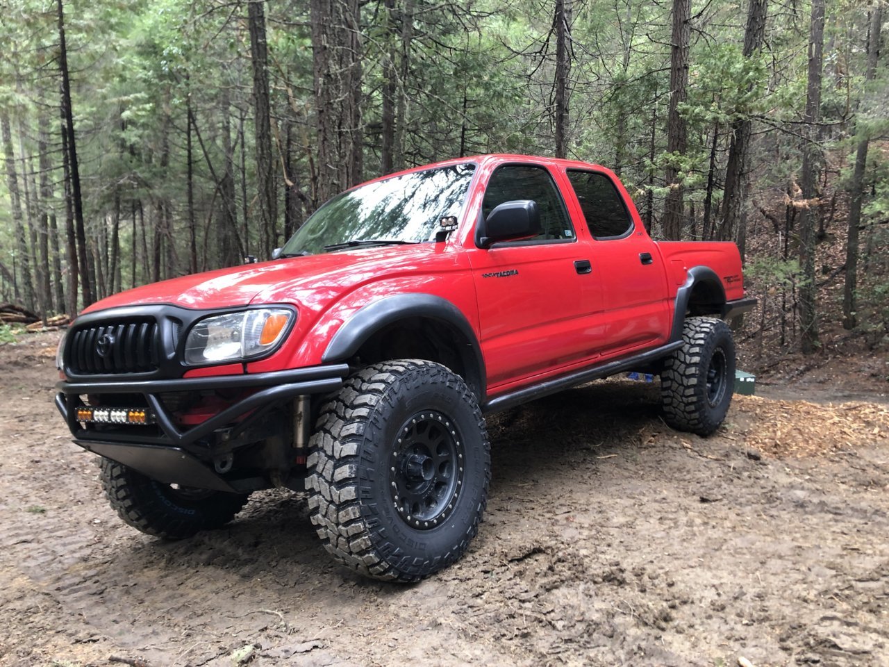

    New rubber. I wasn't getting along with the KM3's so I switched back to STT's.
