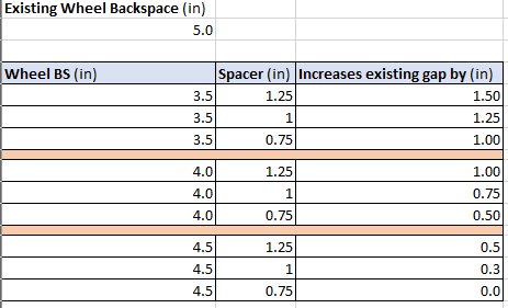

  12. Jan 22, 2021 at 1:14 PM
    #812
    frenchee
    frenchee Favorite Member
    Aug 4, 2015
    #161024
    2,131
    Oceanside CA Area
    2003 Tacoma TRD Double Cab 4x4
    Converted to 4WD DD VW MK6 TDI
    Sorry to pollute OPs build thread.
    It’s a bummer I might be slingin’ mud but I need to clear the shock relocation. I need at least an extra half inch. Was debating 4” BS or 3.5 BS with different spacers. FN has availability on 3.5 BS and they r giving me great deal. SCS just dropped some but I’m sold on FN.
    Came up with this chart. I own both 1 and 1.25 spacer. Its between a 4" BS or 3.5 but cus availability, prob 3.5 with .75 spacers I gotta get.

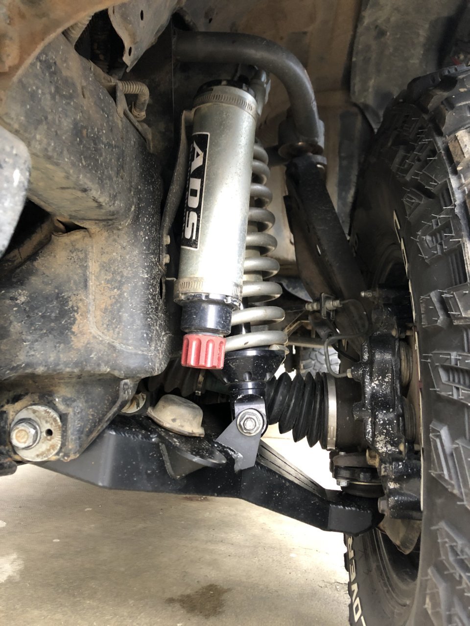

  19. Feb 13, 2021 at 9:39 PM
    #819
    austinmtb
    austinmtb [OP] Well-Known Member
    Feb 26, 2017
    #211727
    1,054
    Austin
    Southern Oregon
    2004 Toyota Tacoma DC TRD 4x4
    ADS Coilovers & Shocks, All Pro Standard Leafs, TRD Supercharger, Haltech Standalone, URD 2.2'' pulley, Method NV wheels, Copper Discoverer STT Pro tires, ECGS 4:56 gears, custom steel tube bumper, custom steel skid plate,
    Got my warrantied Solo Motorsports arms on the truck and aligned today. Not sure if it was just the way the alignment tech did this alignment but I got 2 more degrees of caster out of these arms than my previous pair, giving me a total of 5.5 degrees. I'm not complaining though, the added caster seemed to make a big handling improvement.
    Dalandser, RoaminRoman and Dan8906 like this.
  20. Feb 14, 2021 at 12:13 AM
    #820
    Blackdawg
    Blackdawg Dr. Frankenstein
    Dec 31, 2010
    #48500
    81,631
    Monte
    Wyoming/St. Louis
    The Trifecta of Taco's
    Wow what did you have before? I had 5ish from the get go
