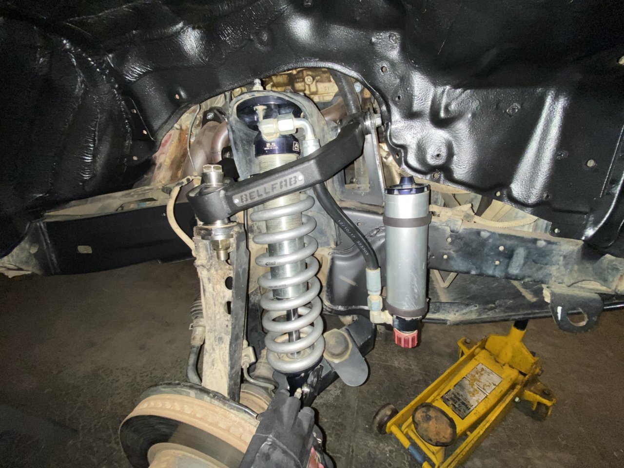

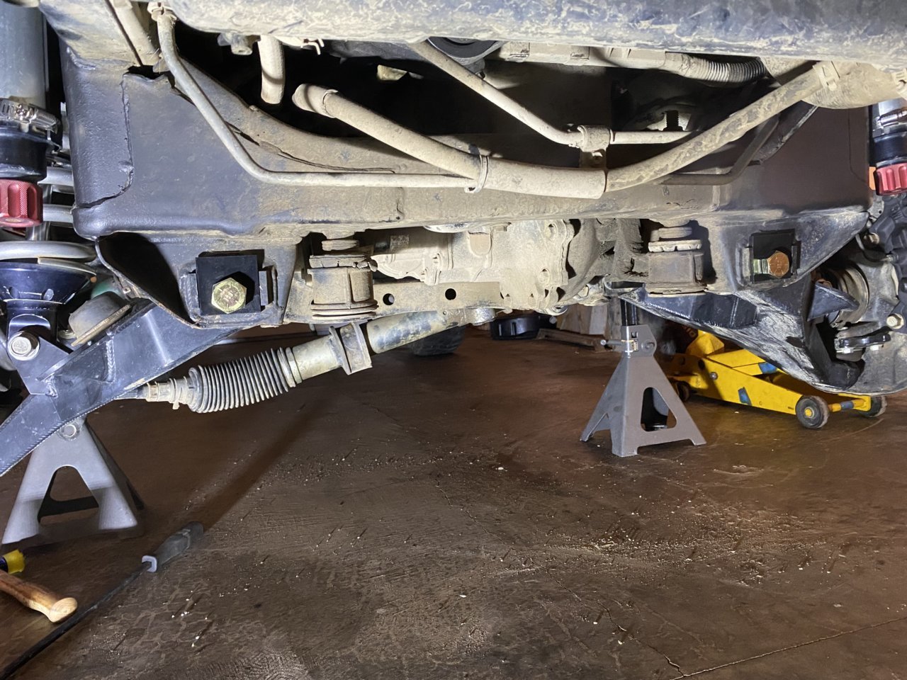

    Been absent on here for quite awhile. My engine slowly lost compression on one cylinder and eventually got to the point where it could barely run. I'm still not really sure why this happened. The good news is that I found an oem motor with 90k miles on it at a junkyard to replace my motor. I spent some time freshening it up a bit, cleaning it, doing valve cover gaskets, oil pan gasket, and seals. Now it's all ready to go in.
    Old motor coming out.
    I also installed some Bell Fabrication adjustable UCA's to pair up with cam eliminator plates. No more losing alignment.

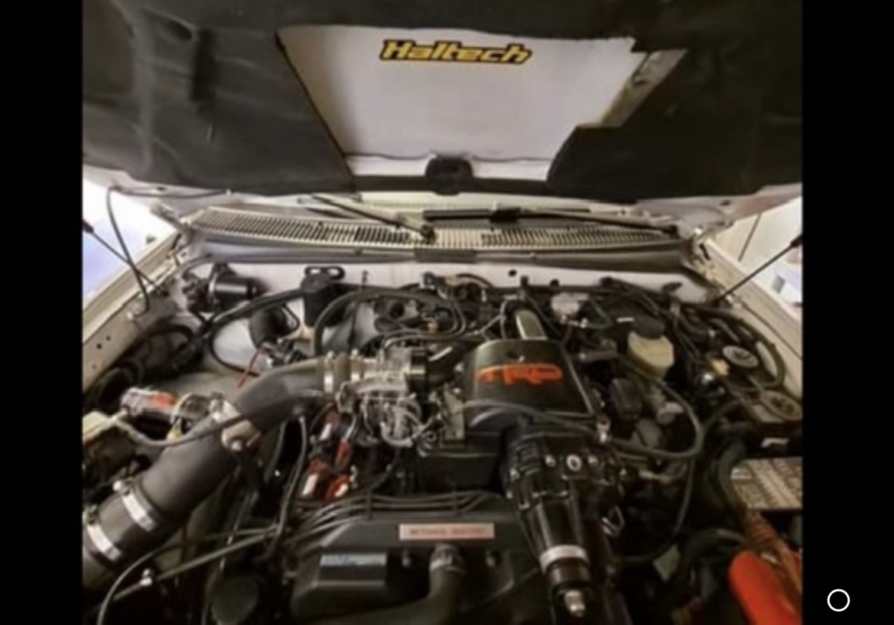

    V6 5sp,RegCab,TVS1320 Supercharger, 56mm pulley, methanol injected Haltech ECU, AC Tvs1320 supercharger,(MUST DO) every 125,000- 150,000 needs rebuild Projector headlights HID 5 speed manual Amsoil for all drive train Smaller 56mm custom pulley, (MUST DO) 2004 DESNO fuel injectors, zero ping ping, 2004 side door mirrors Dick Cepek Rims, Michelin tires LTX, ATM Pathfinders Dynopro ATM ( that last 100,000 miles) Now running Dynopro ATM mud and snow tires KN cold air intake Cat back dual exhaust with ss exhaust tip, Raised exhaust tail pipe to 2" below body line Optima*dry cell battery,red top Alpine sirius radio, 200 watt amp, focal is165 split door pod speakers Focal door speakers Subwoffer behind seat Viper alarm, Electric Locks Dark tinted windows, bucket seats corbeau lg1 Tacoma Rubber floor mats TRD fender extenders, Bilstien shocks, King shocks JBA UCA trailer iv hitch, electric brake control, Drilled slotted brakes, High carbon steel (MUST DO) EBS green stuff 7000 series pads(MUST DO) TRD engine oil cap TRD stick shift, Marlin crawl shift kit. Rear sliding window 2002 4Runner functional hood scoop cut into Tacoma hood, 4Runner dual overhead map light Gentex Auto dim + Compass + Temp, garage,rearview mirror Snow Methonal kit stage 2 Custom 3 core aluminum radiator Linex bed liner Haltech stand alone ECU, Intake supercharger gauge. Stainless steel brake lines, Custom leather wrapped steering wheel, Haltech stand-alone ECU,
    congratulations,
    It’s a game changer for sure, you can tweak your timing numbers now for more power and have that power coming on at 2000rpms now.
    WAIT, you didn’t get a Haltech Sticker?

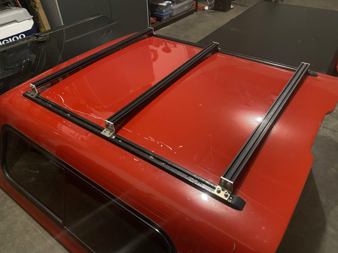

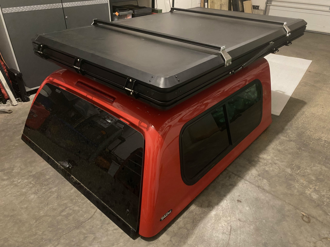

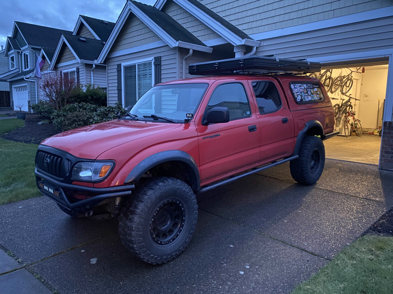

    Swapped out my old CVT tent for a new generic hardshell tent.
    To mount it I purchased a bunch of 2040 aluminum extrusion. Then drew up mounting brackets in CAD and had them laser cut out and press-braked. Lastly, I tapped the ends of the 2040 and bolted it all together.
    In addition, I made a roof rack for the tent so that I could mount rotopax, a solar panel, maxtrax, mountain bikes, etc...
    warmingupmymind, DashMaple and jubei like this.
