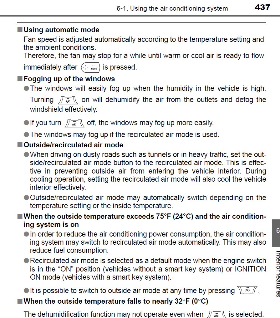

    I noticed there's a setting to change whether hitting 'Auto' on the climate control can enable AC when needed. It appears the Tacoma believes you should just have the AC on 24/7 regardless of whether you are heating or cooling the cabin.
    Despite having 2 pounds of silica dessicant in the cab, it seems to fog up quickly without AC, so I guess I'm inclined to agree, but it seems like a strange choice. It also seems to frequently prefer to circulate cabin air - I haven't been able to tell how either decision is made.

    Pretty standard stuff for the AC compressor to run pretty much anytime the HVAC is on and it's been that way on almost all vehicles for many years. Every vehicle I've had with auto climate control has done the same, and any vehicle that had AC in general would keep it on in defrost mode at the bare minimum. It's still beneficial in heating mode even when not defrosting though, as it keeps the fogging from coming back.

    Makes sense. I definitely just let it do it's thing. I keep it in auto mode all the time and adjust the temp to my liking. It works really well. If I need to defog when that time of year comes, the button for that takes me out of auto mode, at which point I roll the temp up to 90 which defogs the quickest. Once the fog is gone, back to auto mode with my chosen temperature, and it maintains the cab at the temp I like and the AC running in the background (whether heating or cooling) keeps the fog at bay.
    Simple but effective.

    When in auto mode, if you change the vent mode, it does appear to keep the blower settings as “auto”. The auto light itself goes off as soon as you change the vent setting, but if you mess with the temp after changing the vent, it will adjust the blower settings accordingly. So that is pretty much still automatic.
    conversely, if you’re in fully auto mode and you change the blower settings, again, the auto light goes off, but the remaining function (vent selection) remains automatic. If you roll the temp towards 90, it will switch to main & floor vents, and as you get closer to 90 it goes fully to floor vents.
    So it appears the system is still in auto mode even when you mess with one setting, though the auto light goes off because you’re no longer in fully automatic mode.
