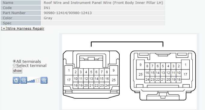

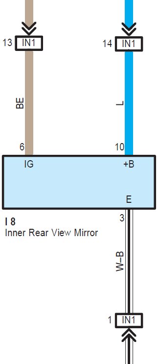

    According to Bobs, these are the pins in the driver side pillar cable used to connect the wiring harness.
    Pin 1 ground connects to the Black wiring wire
    Pin 13 Ignition hot connects to the Black/White wire
    Pin 14 Always hot connects to the Black/orange wire
    I have 12 V power until I connect the cable. When I connect my Black/White wire to Pin 13 it shorts out. No power.
    Can anyone provide help?

    2016+ TACOMA MIRROR WIRING INFORMATION – YOU MAY BE ABLE TO FIND YOUR WIRING CONNECTIONS HERE: OEM MIRROR WIRING RUNS THRU THIS 25 PIN CONNECTOR IN THE DRIVER’S SIDE A PILLAR. PIN 1 IS GROUND, PIN 13 IS IGNITION, PIN 14 IS CONSTANT HOT (CONSTANT HOT ONLY USED ON HOMELINK MIRRORS)
    My truck is not prewired. I only have the day/night mirror. That's why I bought the set up for the non prewired. Can anyone verify this is the correct wiring?

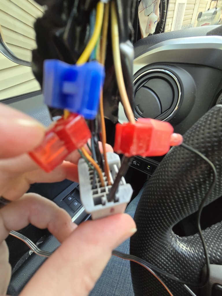

    upload_2025-1-29_15-19-50.jpg I have power at the connectors. When I connect the mirror harness to Pin 13 the power drops out.

    Maybe the wires of the mirror are not good/correct.
