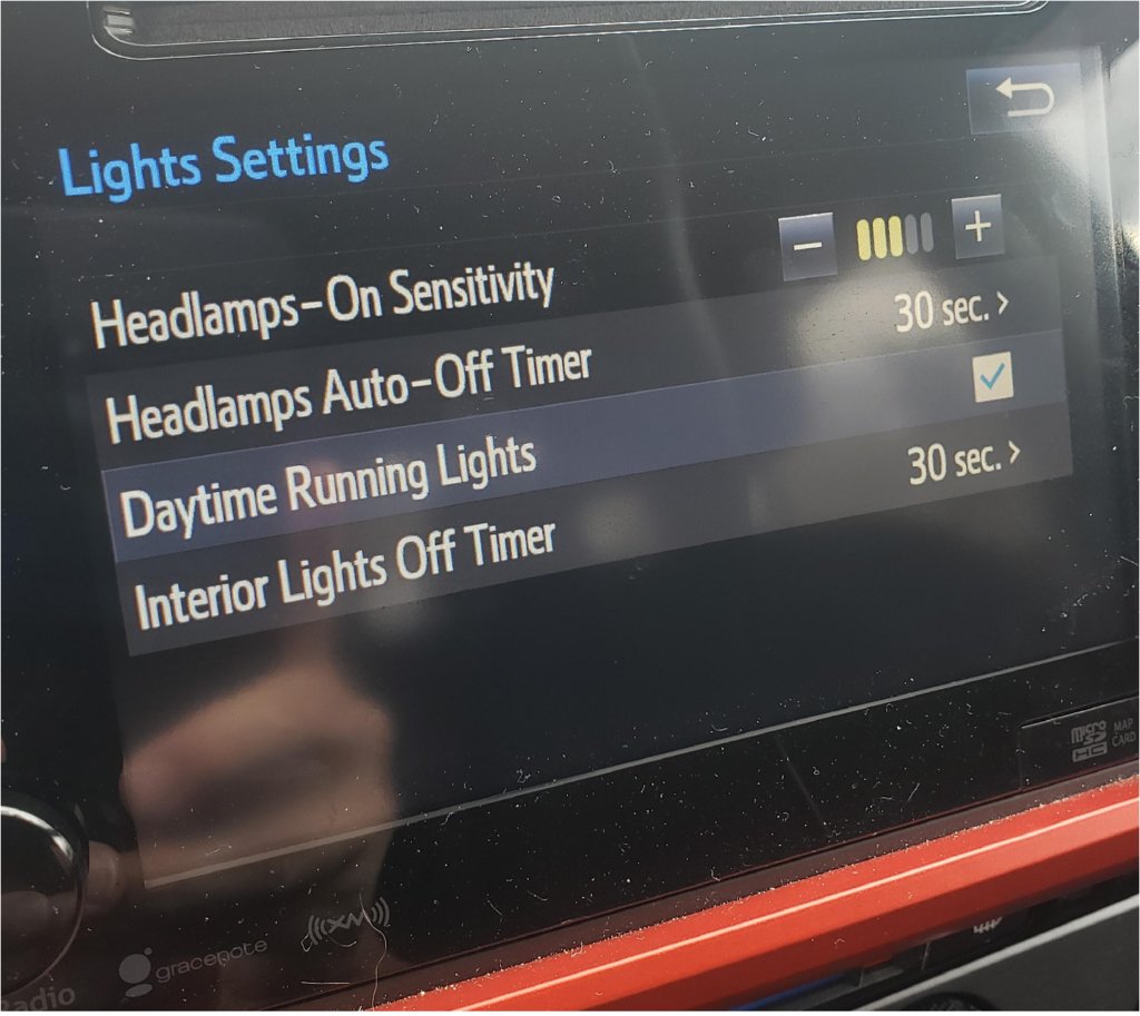

    I just found a great fix to this. I disabled the DRL using an app call Carista. It allows you to customize some features, I only cared about the DRLs. I used a generic OBD2 Bluetooth adapter but they have their own. Saved me a lot of headache, I’m happy now .

    Vehicle Head Unit has the disable DRL option.

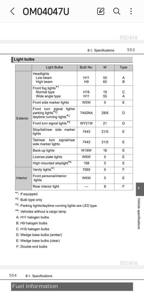

    I for one am a fan of the DRL's on my truck. They are the turn signal bulbs, instead of the headlights which to me is a brilliant idea. At the cost of a headlight bulb these days... burning them during the day could get costly. My 2010 silverado would blow a passenger headlight bulb every yr or so and that is with turning off the DRL every single time you got in the truck.

    DRL's on a 3rd Gen are the surrounding LED's of the headlight assembly or turn signal, no the headlight bulb.

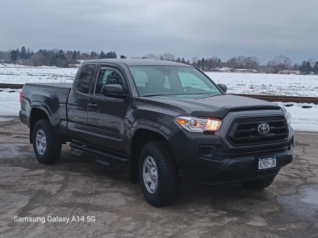

    not on a Sr... turn signal, look at my avatar.

    I read your post, my truck has halogens. the DRL's are the turn signal bulb (7442NA) not the halogen head light. I am aware of the fancy trd style lead drl. Not equipped on a base model truck.

    Which is exactly what @caribe makaira said:
    "LED's of the headlight assembly or turn signal"

    where do you see leds surrounding this headlight. And in the manual it says the drl, turn signal and parking light is a bulb with the part number. i have good day. LMFAo
