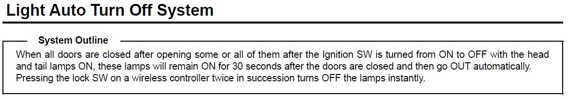

    I’m in a line for car wash - I shut off my truck - apparently my truck lights stayed on (the guy ahead of me took forever) my battery was drained because my lights didn’t go off even though I had the lights switched to auto. Called my Toyota dealer he said shut off auto - but then that doesn’t make it auto lights!? Is this a flaw or am I missing something?

    Tacomas Gen 1 and Gen 3 both, headlights shut off automatically. But that doesn't mean its "AUTO headlights."
    Auto headlights mean it has a sensor, and it turns it ON automatically, depending on daylight.

    Gen 2 also has auto shutoff only. That said there is/are certain situation(s) where the lights will stay on. @ItalynStylion has some details on that...

    mine will turn off if i open and shut the door. if you just sit in it the lights stay on.

    Same here with my 2011. If I turn the key to off and the lights were already on, they will stay on unless I manually turn them off or I open the door.
