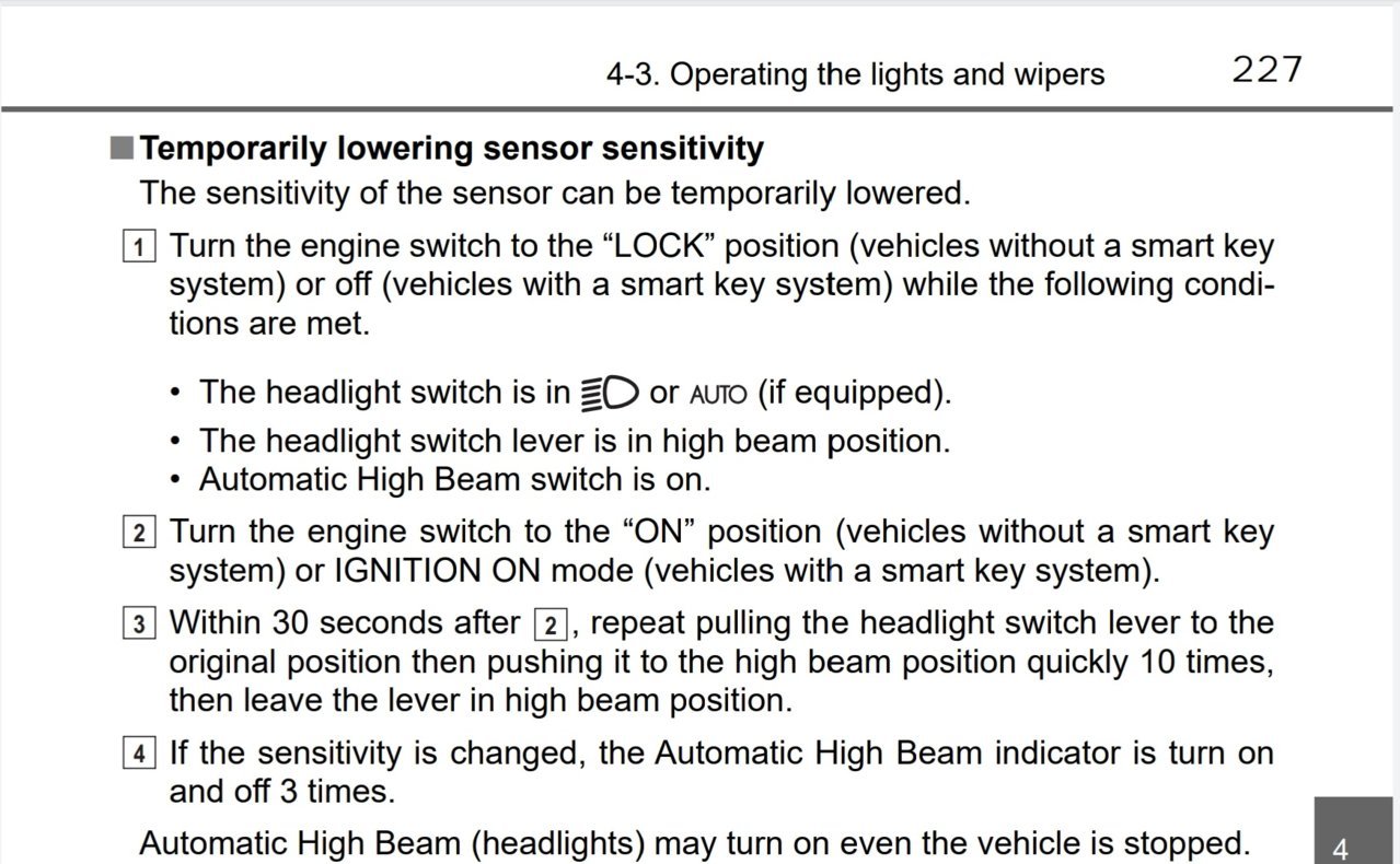

    well just how temporary is it? does it reset on the next ignition? Do i have to look like an idiot in the parking lot flashing my lights when I want to change sensitivity? so many questions
