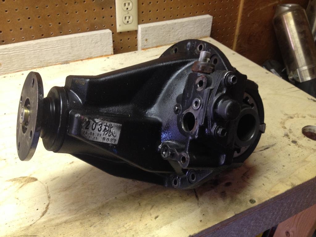

    is it worth it to buy used third members as cores
    to either send out to ECGS
    Or drop off at a shop for building?
    Then pick them up and slap it in
    It would get rid of the labor cost associated with a shop having to work on the truck/remove them from the truck
    if so, what is a good price for used third members?
    Truck is 3.73 4x4 manual, mech LSD
    Might be possible to grab different diffs from non matching 2nd gen
    I’m seeing $600 for a rear on carpart
    I feel like a yard would easily let one go for $300
    I just don’t know if that’s a good price
    I’d imagine not the best given I have an extra set of 4.10 that was like $300
    But unfortunately it’s just the ring and pinion themselves, not the housing/entire third members
    I believe the turnaround time from ECGS is faster if you mail them third members, and it potentially avoids all that extra core charge fee stuff
