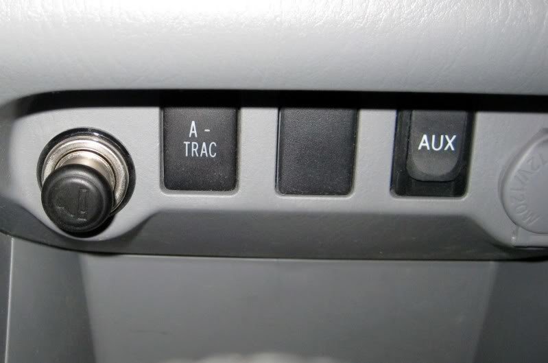

    No kidding... LRD (Locking Rear Differential)... could he mean 'RR DIFF LOCK' button (or switch, as Toyota calls 'em)? Are you sure it isn't an Off Road TRD? Do you have the A-TRAC button down by the cig lighter/ 12 volt outlets?

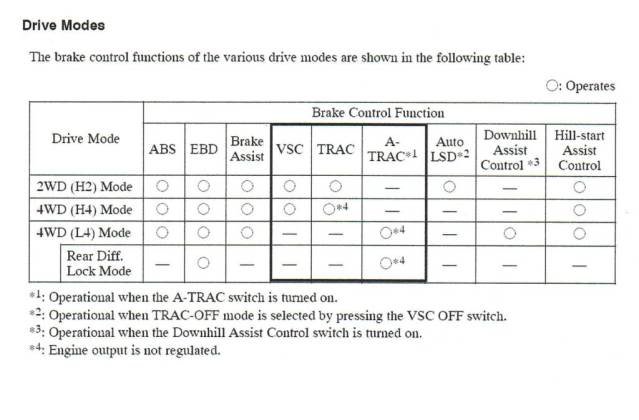

    A 2012 truck should have an owner's manual if the salesman didn't explain how to use the traction controls... but hey, we know most of the salesman dodn't know much about the truck and the manual falls way short on explaining how to use the system!
    This chart is worthy to print out and slip it in you manual... maybe tape it to your visor until you are totally versed with the traction control (TRAC)/ VSC switch!
    ALL Tacomas since 2009 have TRAC & AUTO LSD* in 2WD (and 'TRAC' without engine regulation in 4WD-HI). TRAC & VSC and be turned off, as well.
    *AUTO LSD is traction control without engine output regulation.

    David K: Thanks for all this. And you're right - I didn't get an explanation of how the VSC works or what it does, although that's no excuse. I'll keep the above charts close for a few weeks!
