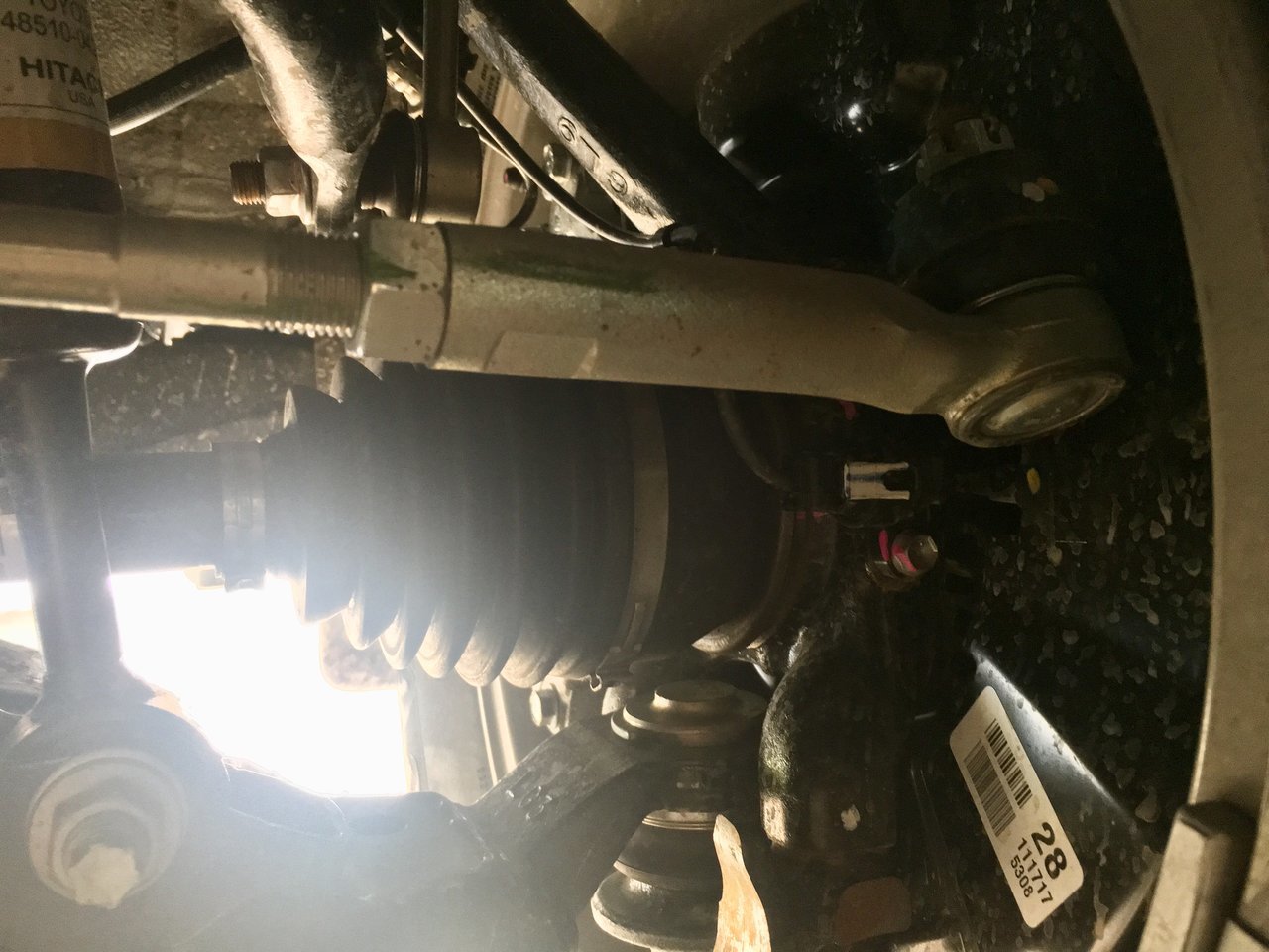

    Auto LSD works on all 4 wheels for the SR5’s and Sports in H4 and 4Lo. It is one stout system and stronger than people give it credit for.

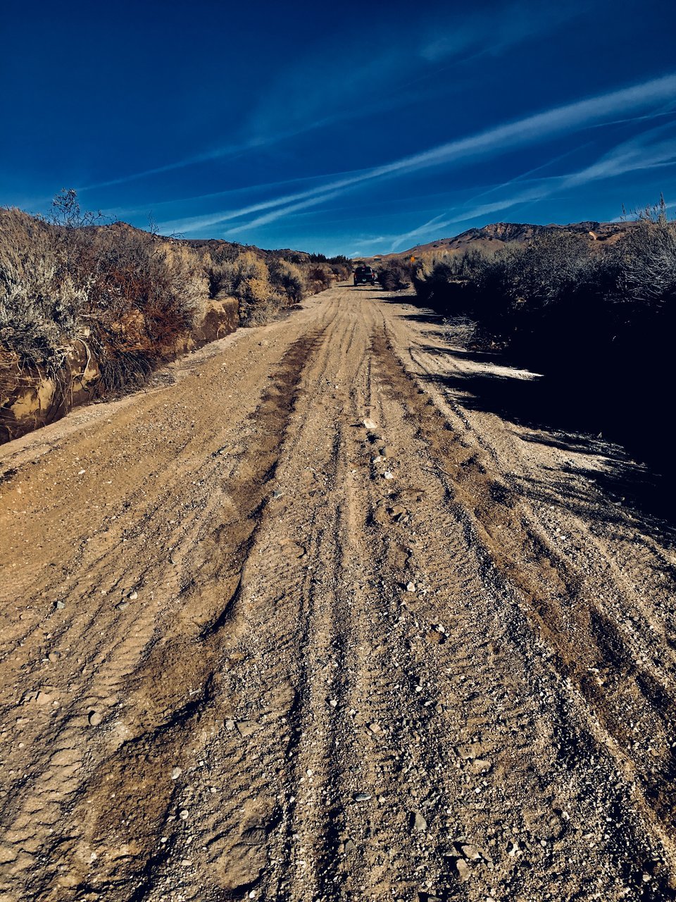

    Yesterday in 2WD Auto LSD engaged. Imagine all 4 tires with traction. I’m still just under a 1,000. I wasn’t willing to go wild just yet.
    Climbed the same steep hills with ruts at Hungry Valley as my past OR’s, but even better. Much more controlled with great power and stout traction beyond the 3mph range.

    I forgot to mention, looking at the map of Hungry Valley, it was the Middle Wall Hillclimb and the South Wall Hillclimb. Ain’t no easy feat and properly named, yet on Firestone stock Destination’s, it conquered quite easily. For an Auto LSD equiped non locker 3rd Gen...the sleeper is ready to shock the non believers.

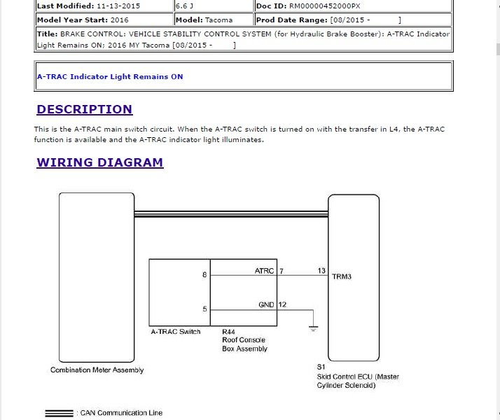

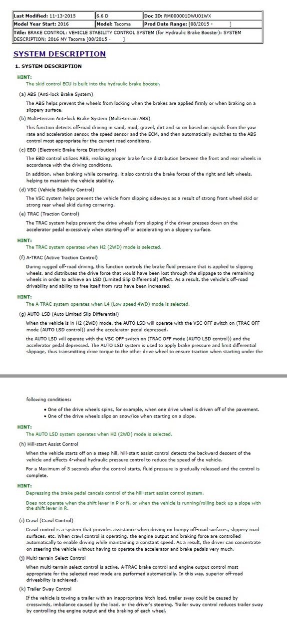

    Manual trans, hydraulic booster, with the A-TRAC button.
    Automatic trans, hydraulic booster, Multi-Terrains Select
