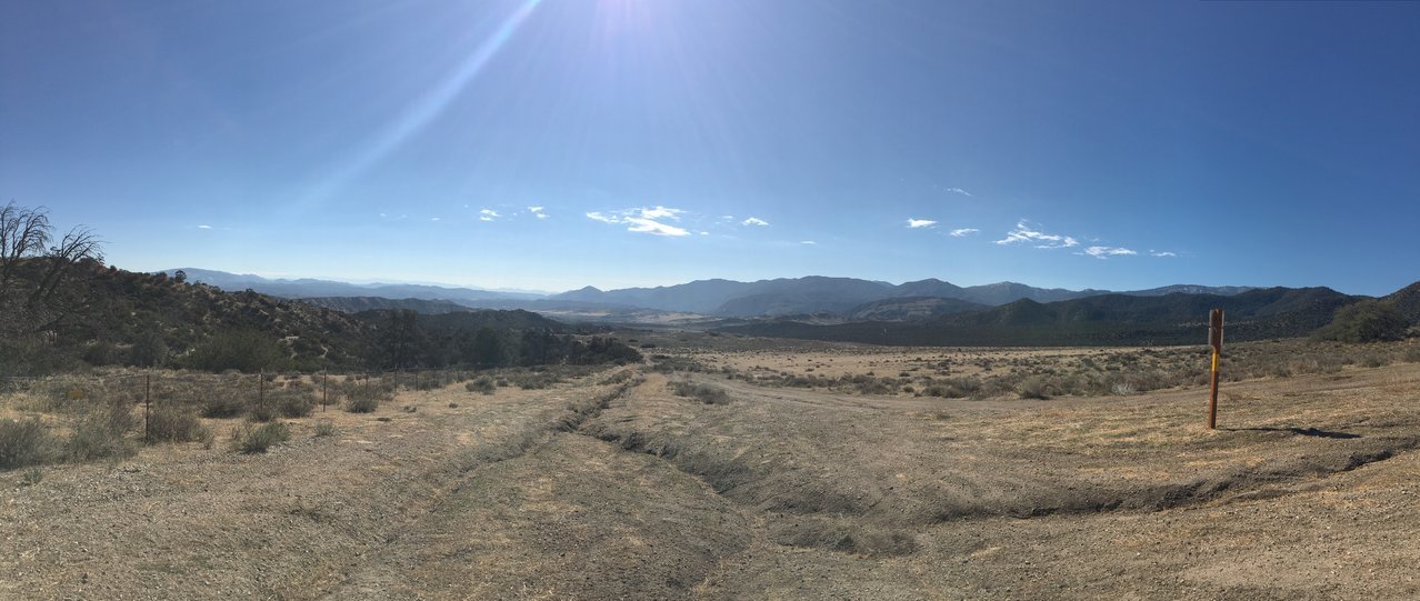

    I went to Hungry Valley today as I took the day off and spent the day wheelin with the familia.
    First attempt, thanks to PB Fab, I tried that mogul hill where his left front wheel locks in mid air. Gnarly hill, but was super fun.
    Went to the back end of Meadows trail and attempted the small steep hill near Old Cottonwood Trail in 4LO, TRAC off. It made it up, however, it slipped a little as it neared the top, and then as the left front creeped over, it began to dig in, but I was able to make it. Went around to Old Cotton Wood Trail and up Meadow Trail.
    Wheeled back down to the same steep hill and decided to grow a bigger sack and this time in 4LO, nothing pushed, I moved over 8’ to the right to take on the steepest part of that hill. Shined it always. Not this daily driver. Not today. It made it with ease, however, as soon as the front wheels cleared, the back end started to “bunny hop” as it went over. I’ve seen this before in videos.
    I then went on to a crazier hill near Freeman Overlook and conquered a gnarly steep angled hill. Much steeper than the walls. Crazy about brakes :facepalm:, but it’s the truth.

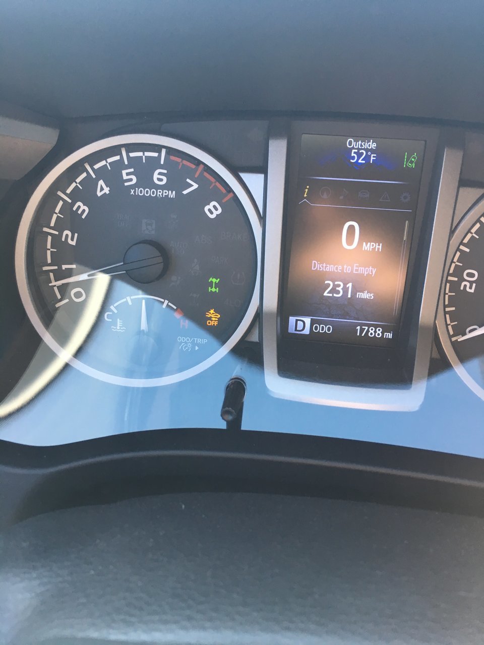

    One thing I found interesting was this.
    After crawling down a steep hill in 4LO and disengaged into 4HI, the collision stayed off for a bit. But eventually turned back on.

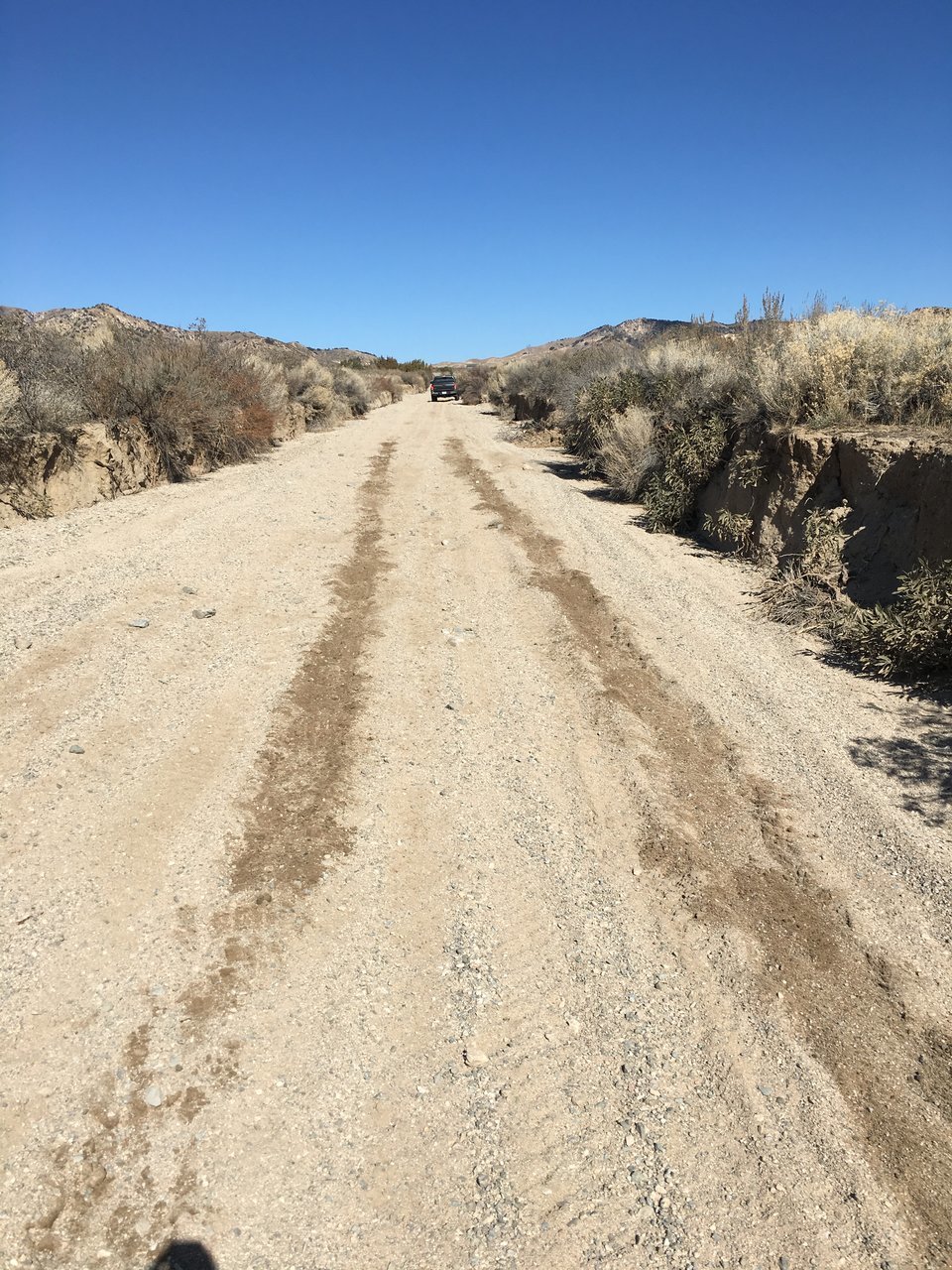

    Lastly, I let my better half go for it in the wash aka Road Runner Trail and jumped off to record a video. Told her, floor it no matter what. In 4HI, I noticed the left front, and back two wheels pulsing rooster tails. I’m convinced the system is active on all 4’s.
