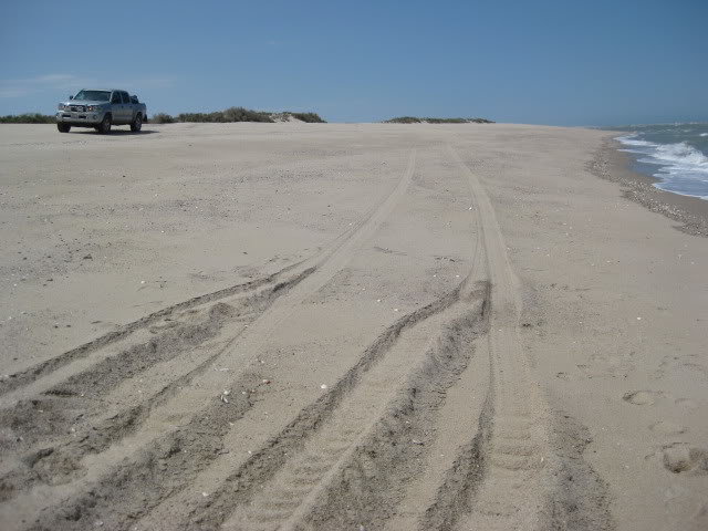

    Not on the beach south of San Felipe... bottomless, coarse sand/ crushed sea shells... you sink if you don't deflate, typically. If you follow any of my numerous posts on Baja or beach driving you will see that not only the type of sand matters, but the temperature/ humidity does as well.
    Now, on the same beach 6 months later, I had to deflate even with TRAC... so it depends on current conditions.
    The point is that LIMITED SLIP improves driving in deep sand... at least with the Toyota TRACtion control!
    Photo shows the difference between 32 psi and 15 psi for floatation:
