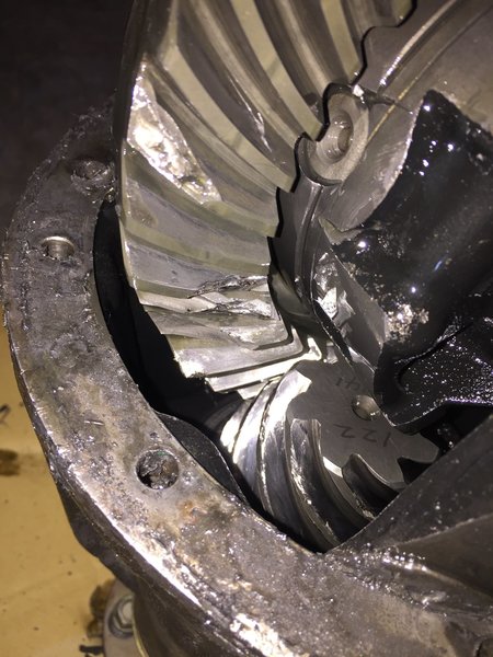

    Are you sure? I think I blew my diff doing doughnuts in the rain a couple weeks ago with the rear locked. I'm super scared to even turn it on any more since it cost me $800 to do doughnuts. Manual says "when locked, do not drive over 5 mph" I am considering deleting my e-locker for a mechanical one, when I do the rear disc brake conversion. The ring and pinion were changed to match up with the 35s about 6 months ago. Any thoughts?

    Your locker didn't blow your ring and pinion did which means it was either the gears or the installation of the gears or drastic change in traction. The locker might have helped it I bet you went from sliding to dry traction quick. A mechanical locker would have done the same thing.
