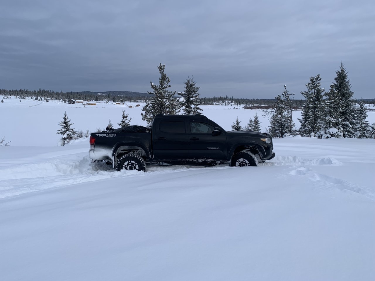

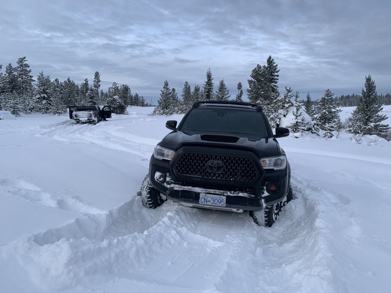

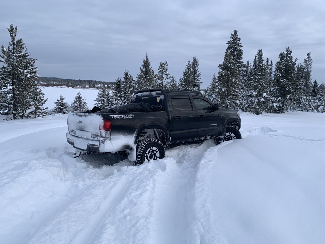

    It worked great in the snow in 4lo last weekend. I did not get stuck in all that snow:
    My buddy in his off road and dedicated winters did, twice
    :stirthepot:
