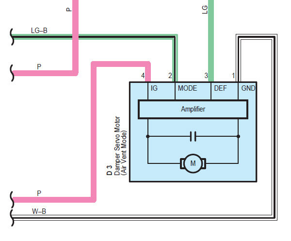

    This is for a 2007 taco is the pink and grn/blk the wires I would use to accomplish this same mod? Thanks

    What gauge wire is it for using a quick splice?
