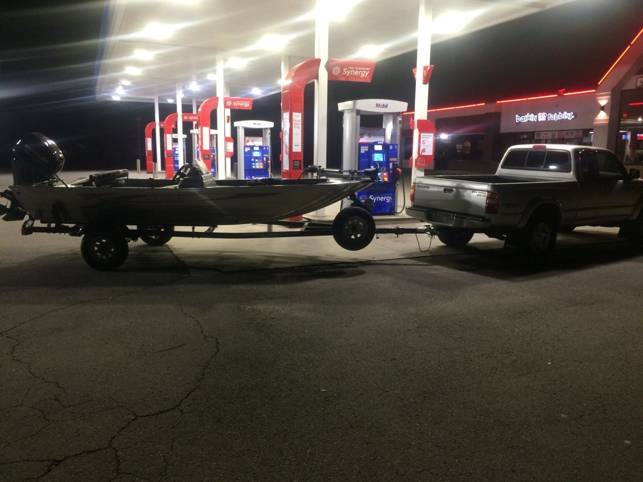

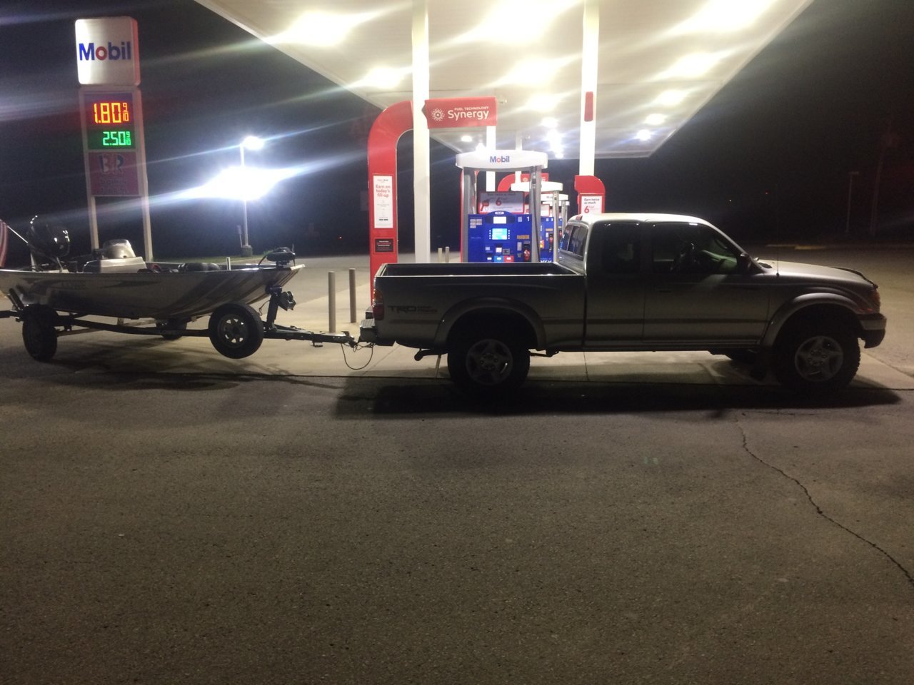

    Got a 5 speed 3.4, tows alright but sometimes I wish I had an auto. Some Boat ramps SUCK with a standard. ECFD2461-4444-4486-86DA-634229CEB834.jpg 7846514E-73D8-4E7D-9F8A-4023515257E5.jpg Just want to see what the opinions are out there, would y’all rather have an auto or manual for towing?
