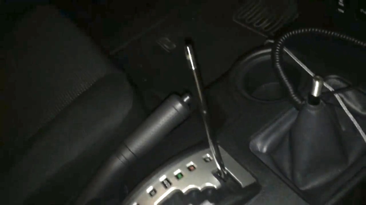

  14. Apr 1, 2019 at 7:11 PM
    Stagarm
    Stagarm [OP] Well-Known Member
    Feb 16, 2019
    #283297
    160
    Trev
    Fj
    Me behind the wheel
    The fj shifter shaft does look super long. FCC00C68-EC51-466F-8777-F4F33AD04524.jpg
  15. Apr 1, 2019 at 7:14 PM
    Gerard6778
    Gerard6778 Well-Known Member
    Dec 30, 2018
    #277494
    456
    Gerard
    2015 TRD Sport
    Yes it does.
