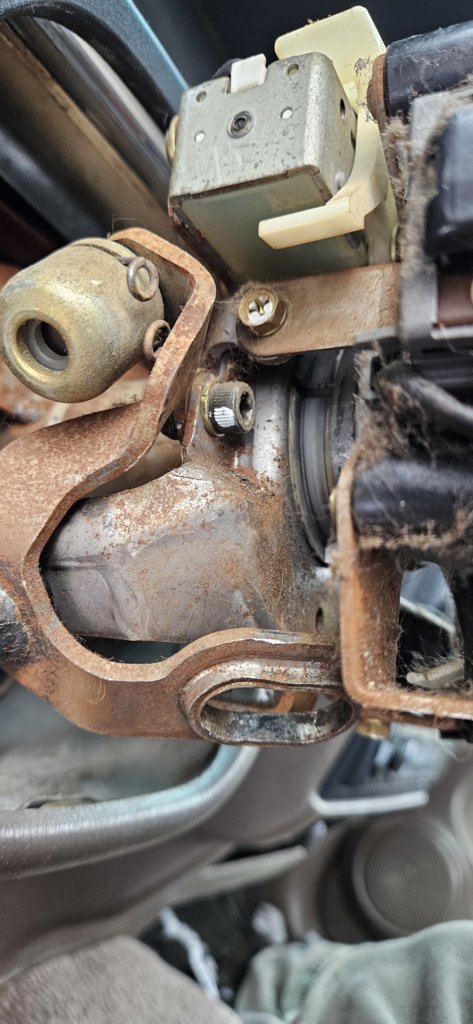

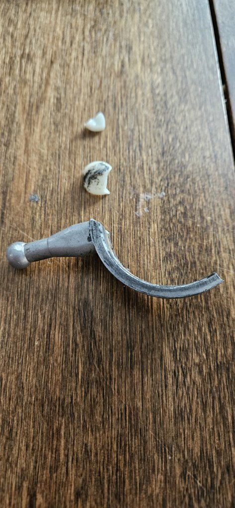

    Hey Everyone,
    I have a '96 Tacoma. The manual shifter is on the column. The other day, when I was trying to get it out of park, it wouldn't move. I put a little excess muscle into it, and of course, I heard it break. I opened up the covers and found fragments of a white bushing and that the collar with the rod for the bushing was snapped in half. I can't find any replacements or even used columns. I can find a lot of columns, but they are for floor shifters. Do I have to replace the whole column, or do you guys know of some good parts websites I can order from? Not sure what it would take if I just switched from a column shifter to a floor shifter, but that seems like a ridiculously tough and unnecessary project. Any advice would be a huge help.
