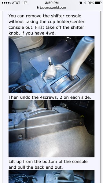

    I just bought a 2004 Prerunner. The only thing wrong with it is a slight valve cover leak that will ride for now and the light on the shifter console is out. I got the bulb form Toyota dealer but can't(or haven't) figured out how to get to it. Help?

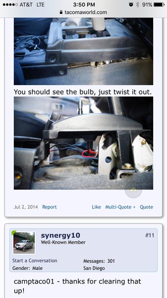

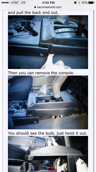

    Here ya go.

    Thank you very much Sir

    Yep. It's really easy!
