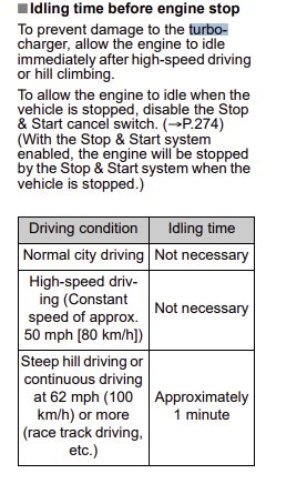

    You folks remember that lively debate about idling the engine after going super fast? So funny this tid bit is in the Tundra manual but was not in the Taco manual.
    treyus30 likes this.
  17. Jan 8, 2024 at 5:43 AM
    #37
    batacoma
    batacoma Truck Wars
    Sep 14, 2017
    #229983
    10,371
    2012 Regular Cab 4spd
    (race track driving, etc)
    Who is driving their 3G Tundra on the race track?
